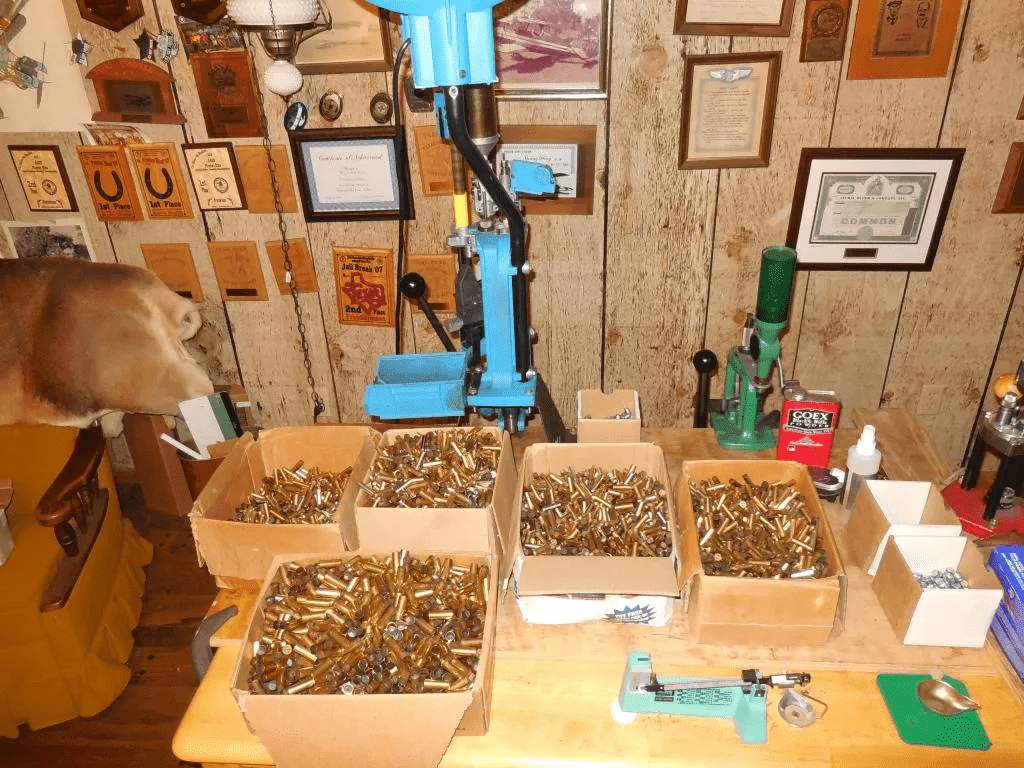

This pile of 38,357,and 45 colts was done with seating/crimp die. I guess I didn't know any better :-)
