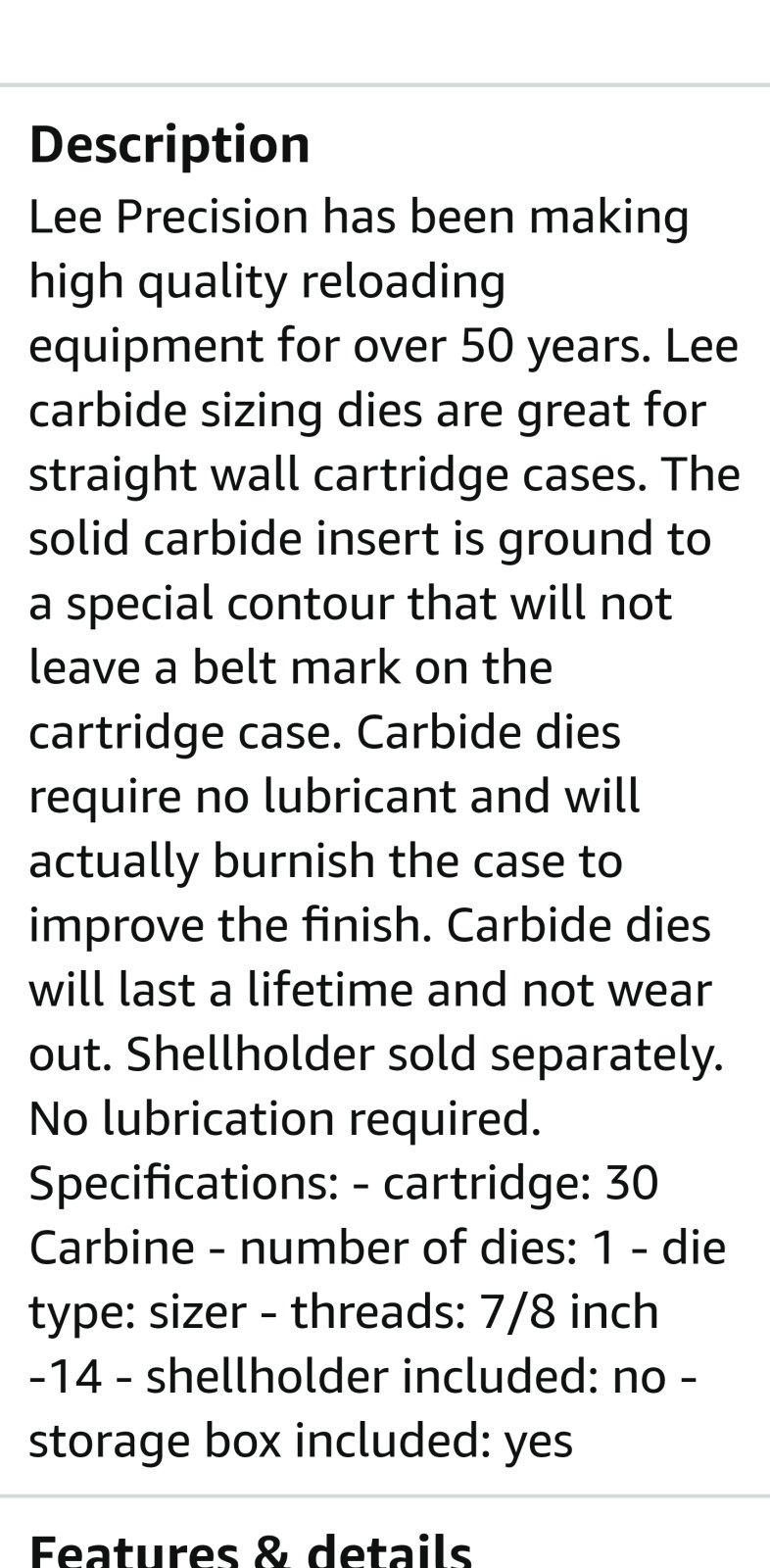

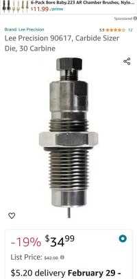

Would this be a good thing to get. I dont shoot much and dont want to go through a lot of trouble.

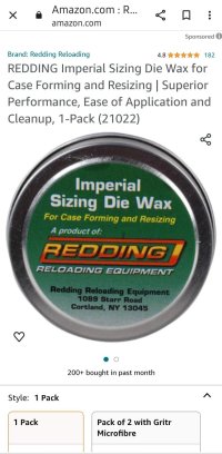

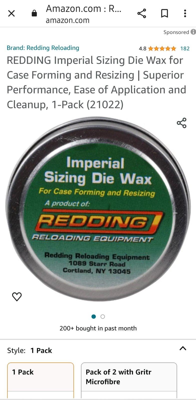

Second, I agree with the use of the Imperial sizing die wax. You use very little and apply with your fingers. Just barely dab your fingers in the stuff and lightly cover the case with lube. It only takes a very thin coating. That stuff is very slick and now is the only thing I will use when resizing brass.

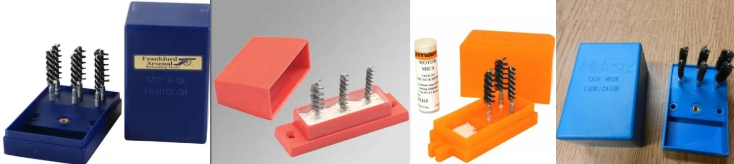

If you do not have one, get a case neck lubricator. It uses a brush and "Motor Mica" to clean and lube the neck. Also Imperial sizing die wax is the best on the market.

If you said the cases had marks on them. A gall mark or something. I missed that post. Been using imperial sizing wax for over 25 years and all brands of dies and never had to polish any of them. Too much polish might do more harm than good.
Crow, the carbide dies are generally for straight walled pistol cases, NOT bottle neck rifle cases. You have not mentioned what type of lube you were using, if any.

lubed wih oneshot.a couple cases had slight scape marks. Only about every 8 or 10 had the hard to put into the die. Most were ok but when i had one that took alot of force it was quite bit of force. I polished the expander that goes into the brass necks. That took alot of the scraping sound and feeling out. Im going to grt some Impersl sizing wax and see how it goes

As stated carbide is for straight wall not bottleneck
