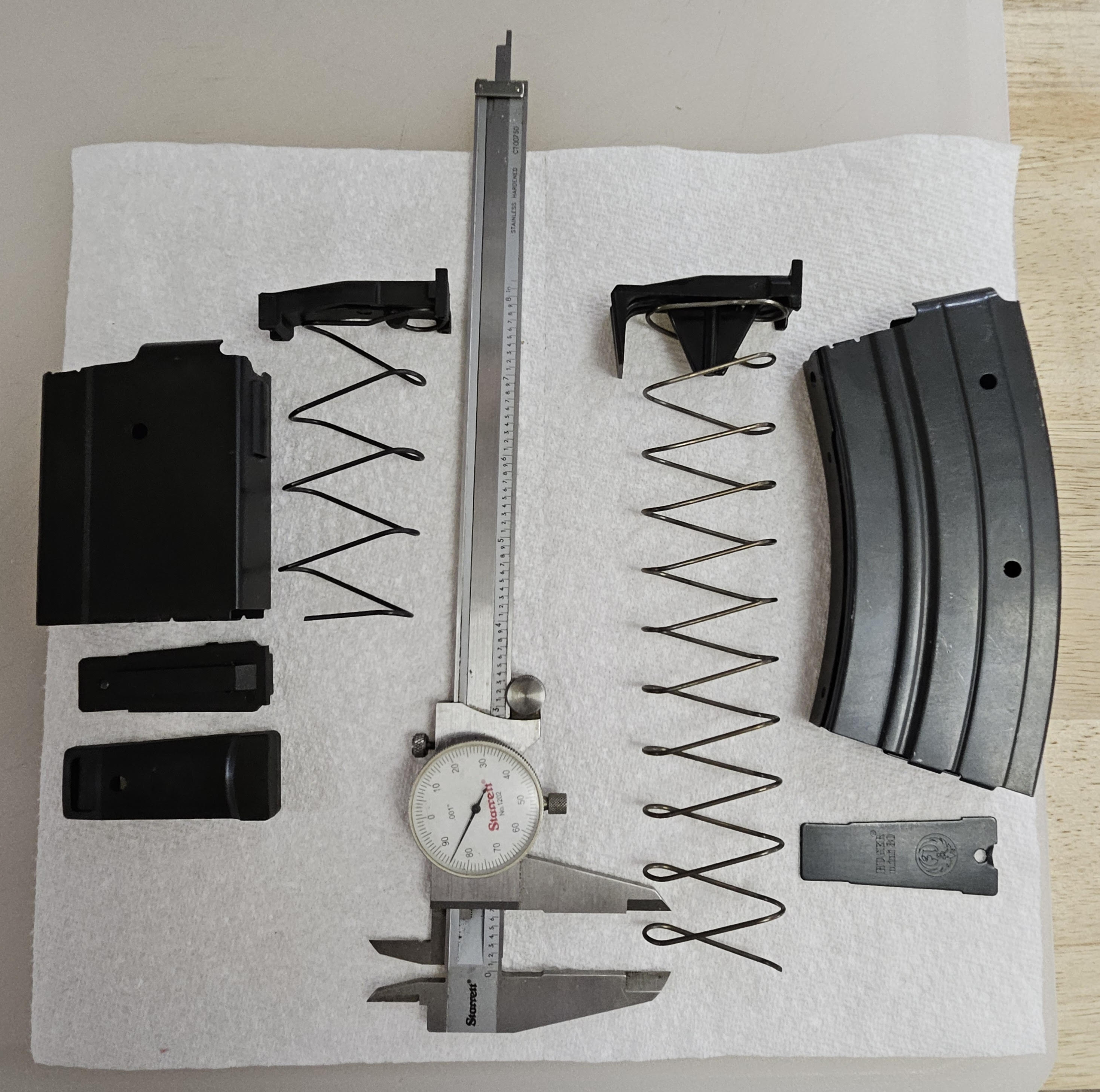

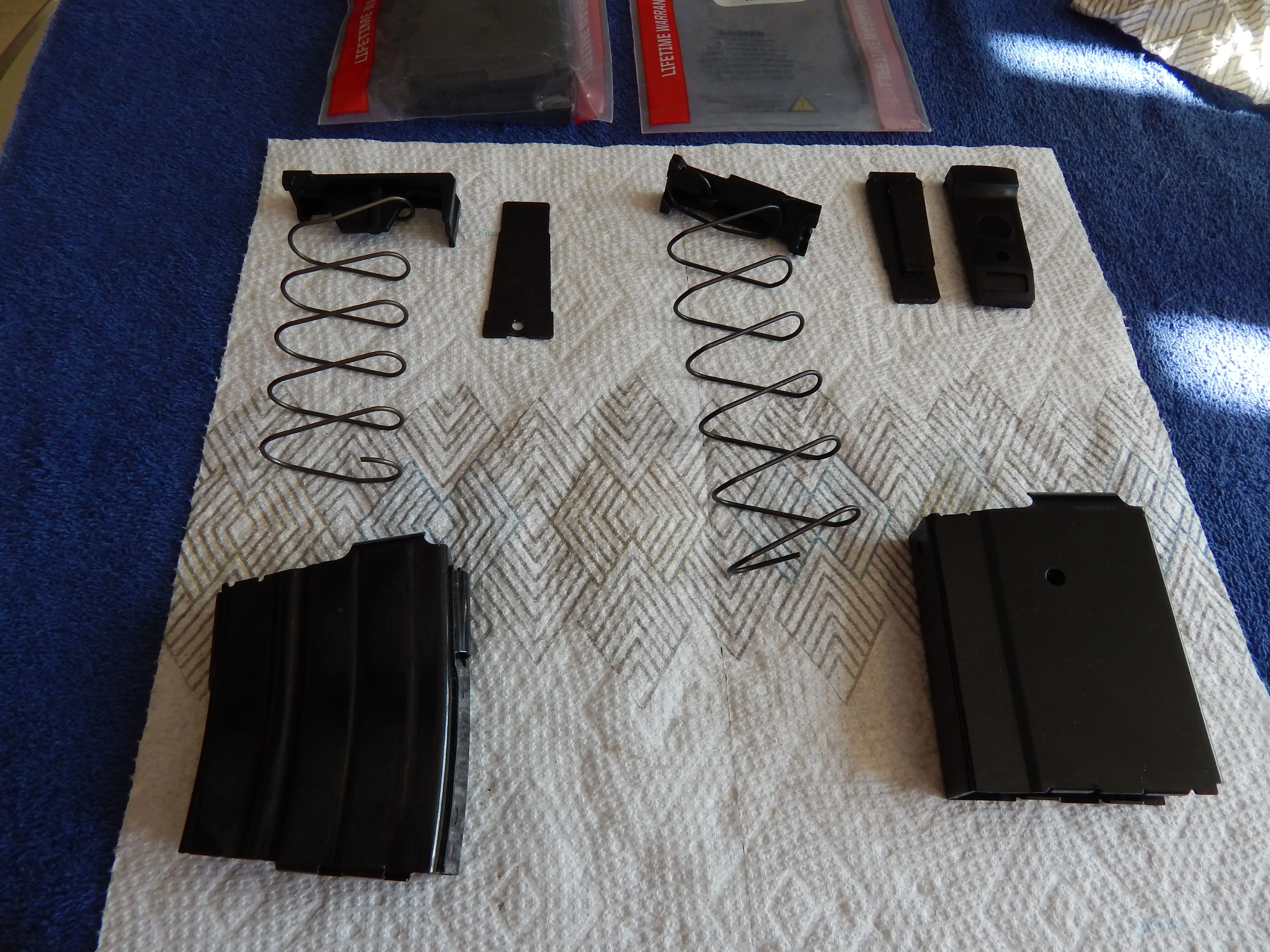

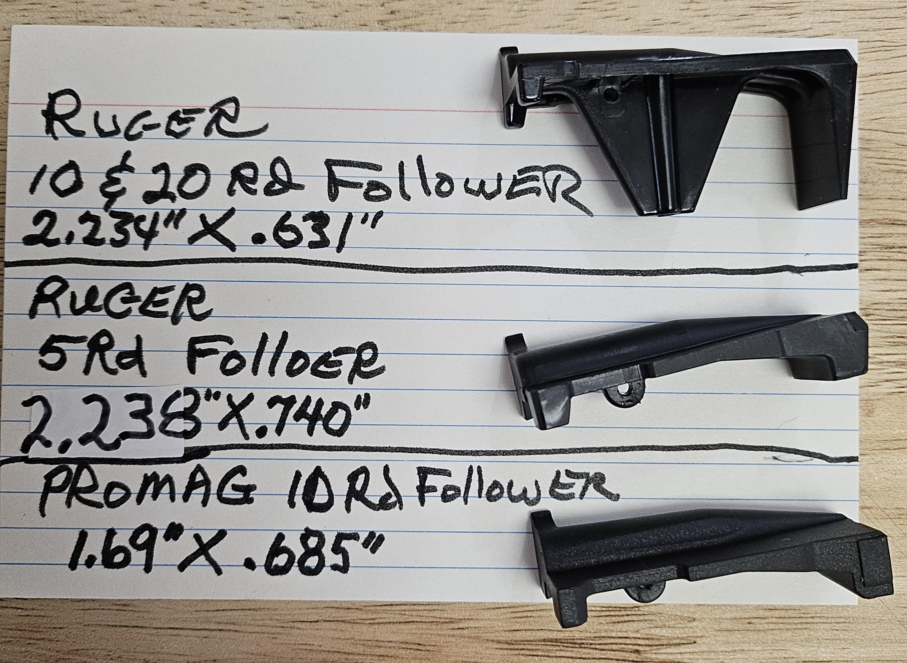

ProMag's steel 10-Rd mag is my mag of choice for my Mini-30....I've also got a pair of their (steel) 20-Rounders that are every bit as good as the (2) Ruger factory mags that came in the box with the rifle....That said, I had to remove, cut, and reshape the springs on the 10-Rd versions to get them to function 100%. On the other end of things, I had to remove the factory followers from my Ruger 20-Rd mags and substitute followers that I removed from 10-Rd ProMags in order to get the Ruger factory mags to run reliably with all 20 Rds loaded.
Do note however, that none of the above has anything to do with Mini-14 Mags....only the Mini-30.
I've never had one single bit of trouble with Ruger factory 20-Rd Mini-14 mags, so I have had no need to look elsewhere.
