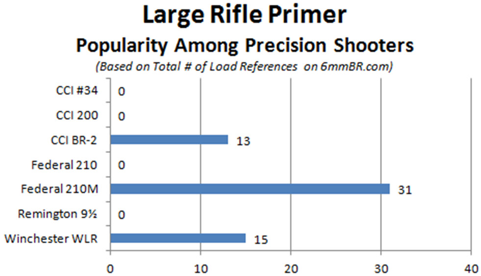

This is just a page from my loading notebook. YMMV.
The large rifle primer numbers above reflects the load data available on 6mmBR.com for the 243 Win, 308 Win, 6.5-284, 7mm WSM & 7mm SAUM. Although there were almost 60 different loads listed, there were clearly only 3 large rifle primers the experts trust for exceptional accuracy:
  1. Federal 210M – Listed for over 50% of the loads, this primer was clearly the most popular for super-accurate loads. It is Federal’s “match grade” version of its standard large rifle primer, the 210. (Sometimes referred to as Federal GM210M)
  2. Winchester WLR This is said to be the hottest non-magnum primer and is hard enough to be used in semi-autos. (Sometimes referred to as Winchester LR 8 1/2)
  3. CCI BR-2 – The “match” version of 200. This is also considered hard enough for use in semi-autos.
