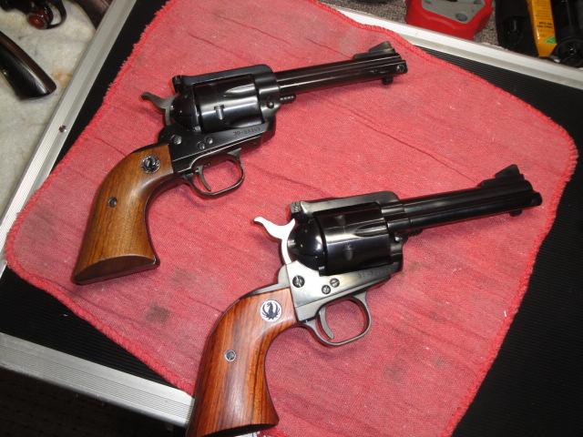

I di very little polishing on my Three Screw Blackhawks, and they are more than good for my usage!
    67.7 KB
    73.3 KB
