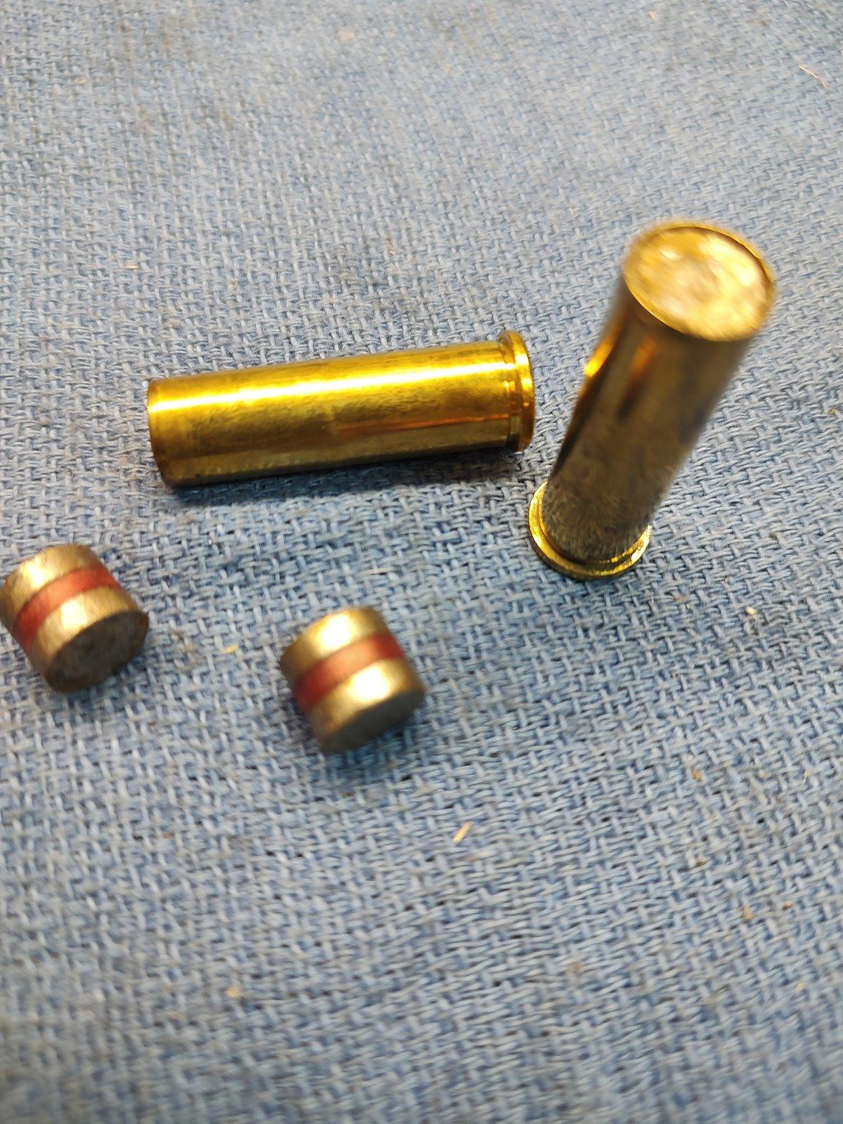

I load (2) 80 grain wadcutters in .357 brass over 6.1 grains of unique for 2 holes at 900fps .
