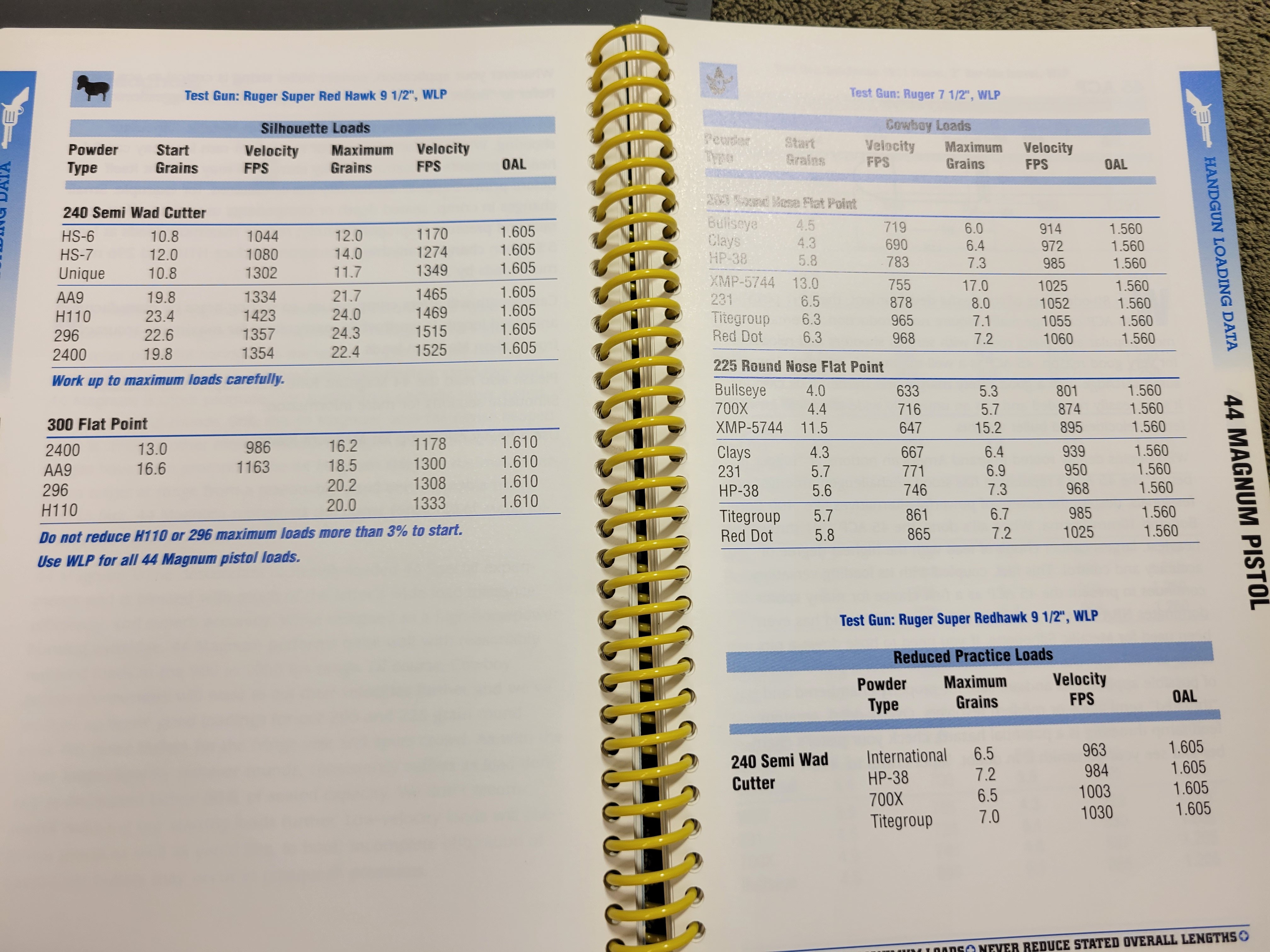

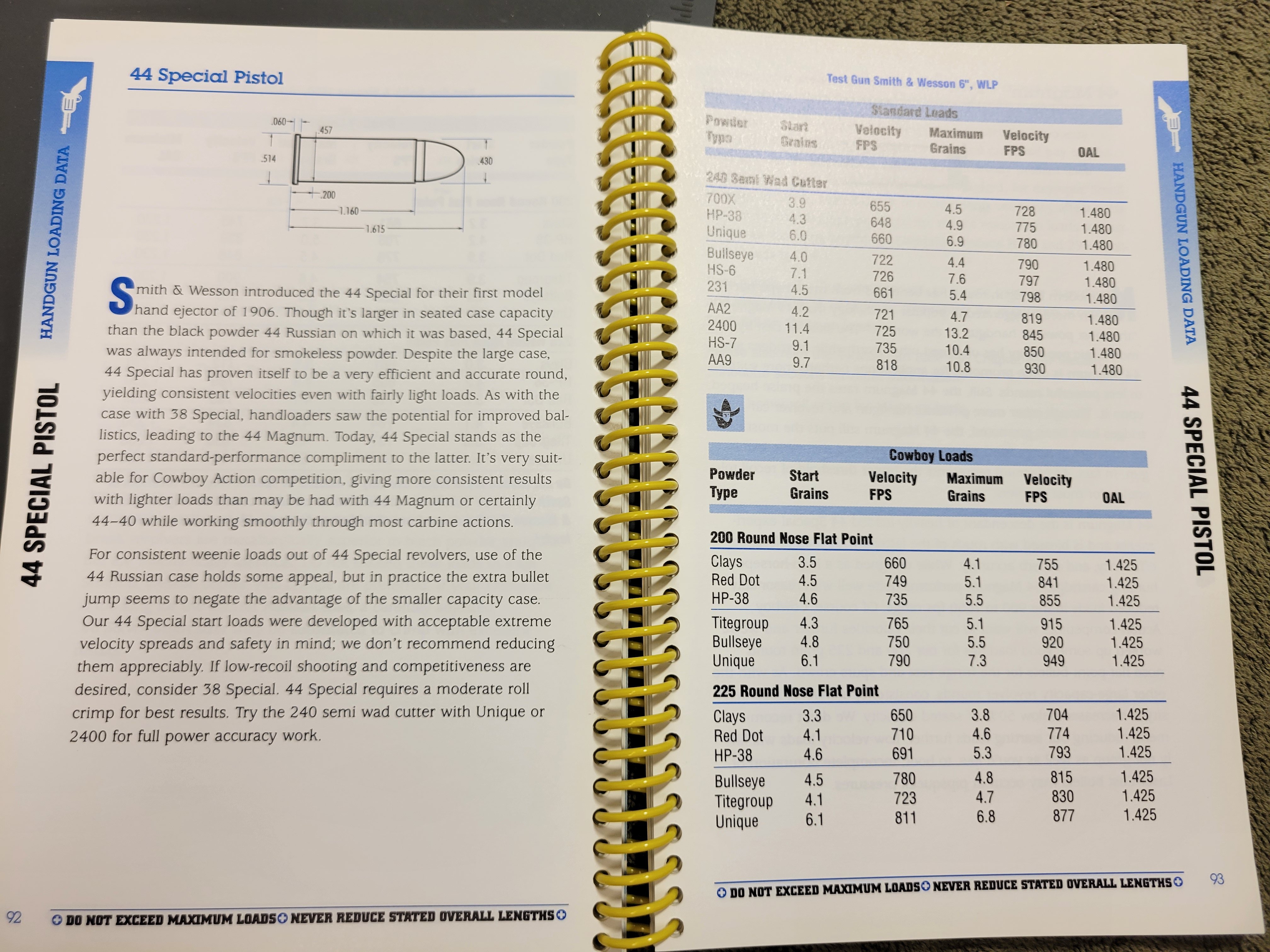

I went and found my old Laser Cast book. .44 special and Magnum data.
They do not answer your specific question but might be handy if you want to try other ideas.
