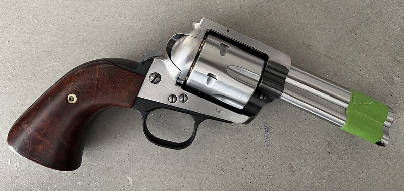

Nm and old modelBlackhawk barrel interchangeability?
What Robb said. /\
To expound a little…
This is a NM Barrel that I have cut down to 3.6”,,, the reason I went with a NM barrel is I didn’t want the OM “SRM” cut in the middle, The OM has deep stamping. Whereas the NM is much lighter and took very little effort to just remove it all.

But the OP has asked about the thread differences or the lack of them on OM & NM frames & barrels. He can easily use a NM bbl as noted above.
