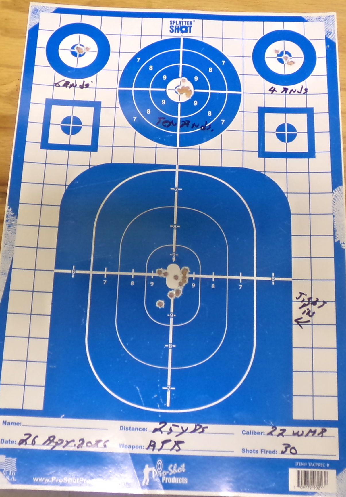

Haven't shot this "sniper rifle" in a couple years, so I reckon I'll burn some Hornady 45grn .22mag later to see if I'm still a decent shot. ;)
RDMR.......Rodent Designated Marksman Rifle.......

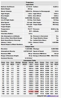

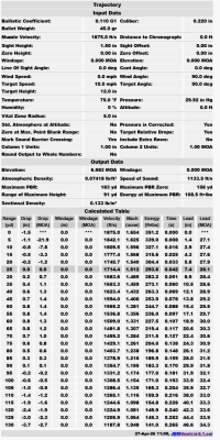

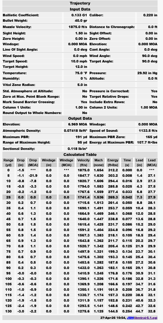

I'll be redoing this with the CCI 40grn Gamepoint ammo - probably this coming weekend. Running the factory numbers, JBM calculates far better ballistics for the CCI than the 45gr Hornady.
CCI

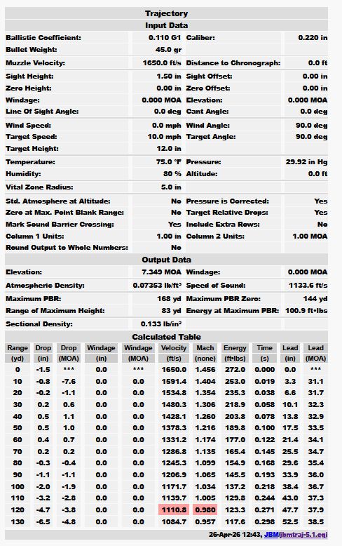

Hornady:

The problem with inexpensive .22 is that it's inherently not going to be as accurate or consistent as centerfire boat tail rifle rounds especially at longer ranges, due to the low BC and MV. When it hits the sonic barrier all bets are off. A standard .22 (lr or wmr) has a BC in the .110 range. The CCI 40grn Game Point has a BC of .133 due to it having a slightly pointier nose than the standard 40grn fmj or the Hornady 45grn. This seemingly minor difference in BC results in a significantly flatter trajectory/greater effective range as shown in the comparison above. Both of those cartridges are similarly priced, but with significant differences in performance.
Bullet weight, and resulting differences in MV of course, also plays a role in this. A 30grn V-Max steps out at around 2200fps, but a BC of .095(not good), and it's also more subject to being pushed around by crosswinds than a heavier bullet.
