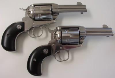

Me personally did this in the second gun from the top, a 45 Colt Vaquero, if you study my picture you can definitely see the “extra” curve of the Bisley trigger.

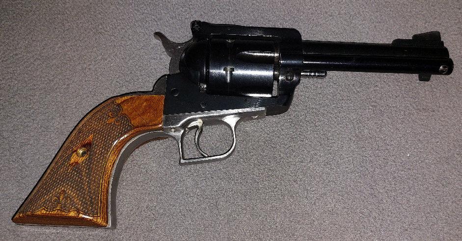

Yup, I just finished it and everything you said is spot on. I also trimmed the trigger where it needed to be trimmed to fit the front of the grip frame instead of opening up the hole for the trigger but in my case the bottom of the trigger had enough clearance from the trigger guard.
Anyway, the Dragoon grip fits my hand so much better and the extra weight just feels right.
Thanks G2 and Fox Mike
    137 KB
I opened up the slot in the frame since I have my original grip frame stored away. I eventually put the standard trigger back in as I never got the Bisley trigger to feel like I wanted it to.

Finally fount this picture,,,
Consecutive SN# Vaqueros 45C
Half way thru the Bisley Hammer/ Trigger conversion.
Top gun done, bottom gun as it came from Ruger.
I ground some off of the "hump" off the back of the hammer.
