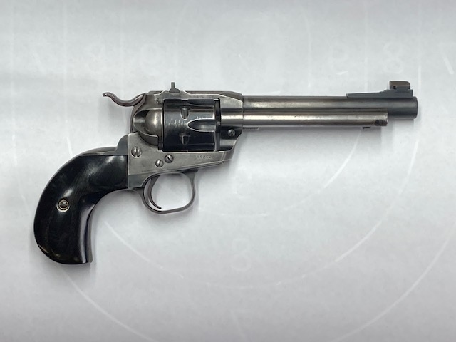

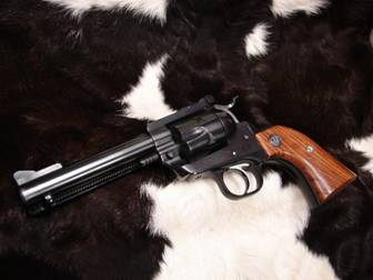

Single Six with a Power Custom unmodified Bisley hammer and a slightly trimmed Power Custom Bisley trigger in a Ruger Super Blackhawk grip frame, nothing fancy, a shooter. The gun is not done and is dirty from...being a shooter.

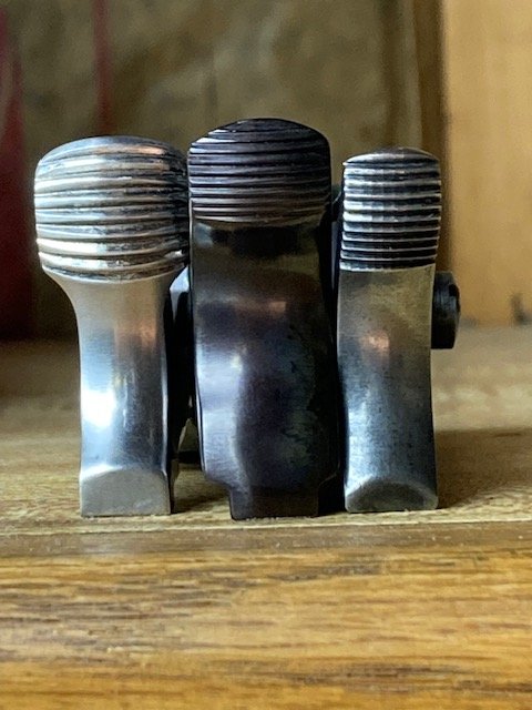

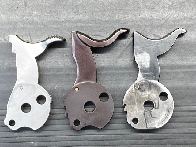

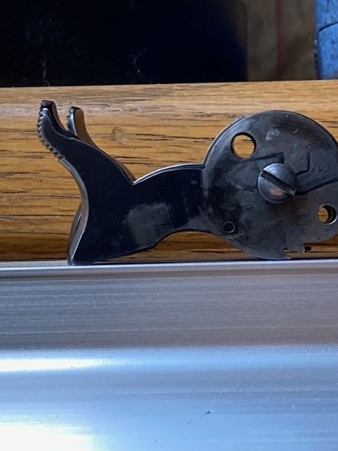

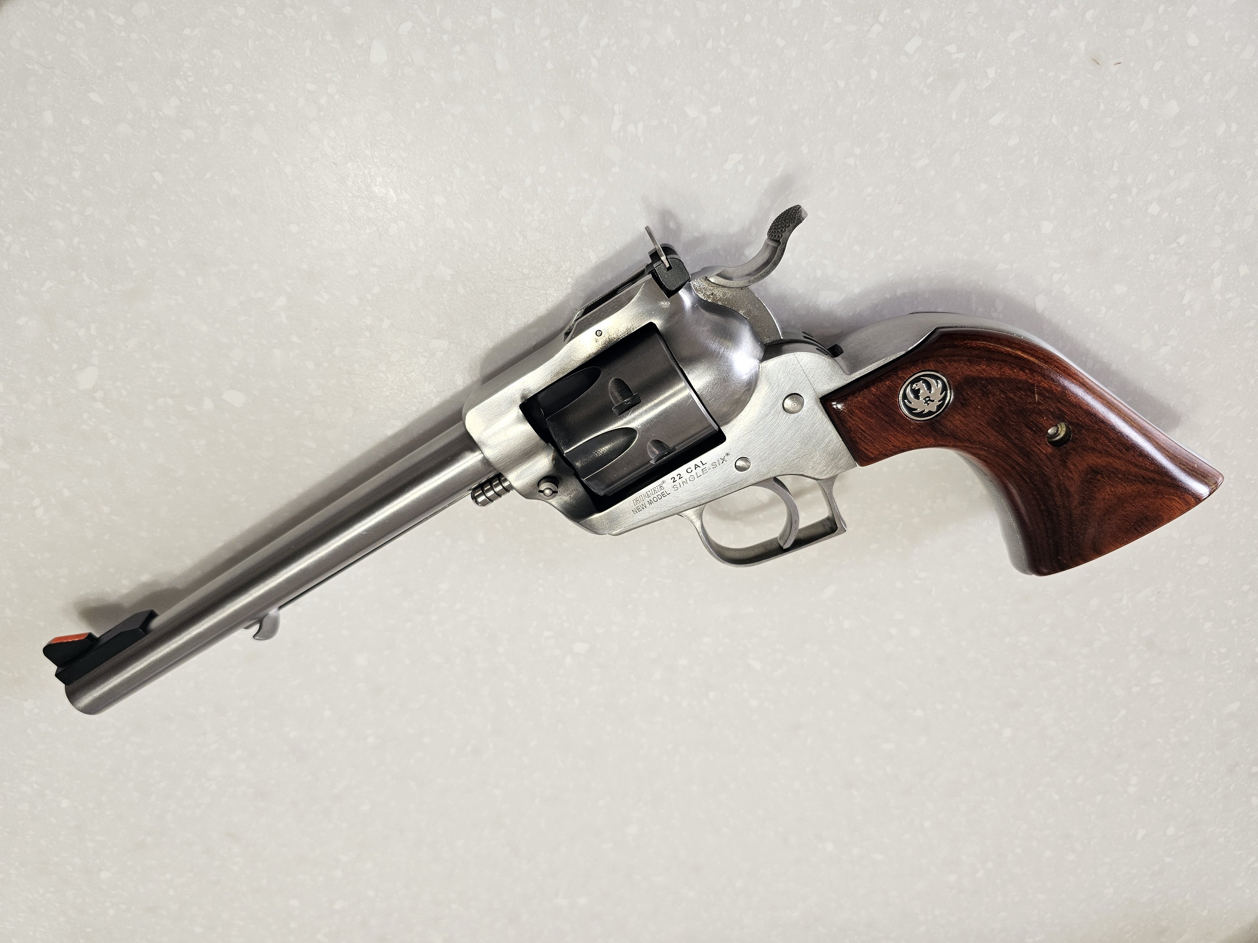

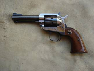

You can be the judge. NM SBH spurred Single Six hammer vs OM Bisley spurred Single Six hammer vs a Factory OM Single Six hammer.
The NM SBH and OM Bisley are from Ronnie Wells / RW Gripframes. Pricey, but worth the money to me. After all, IT'S MY GUN;)

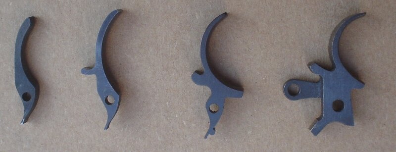

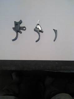

The one thing about the Bisley after market triggers; they have less curve than the Ruger Bisley trigger and is further back in the trigger guard, which is good if you have a fat trigger finger.
After market Bisley trigger for an OM 3 screw 2nd from the right. Ruger NM Bisley trigger on the right:
But I prefer the Ruger NM Bisley trigger. The lower tip of the trigger needs a slight shortening to fit in a standard trigger guard:
NM Ruger Bisley trigger adapted to OM Ruger:
After market Bisley trigger for OM Ruger:
