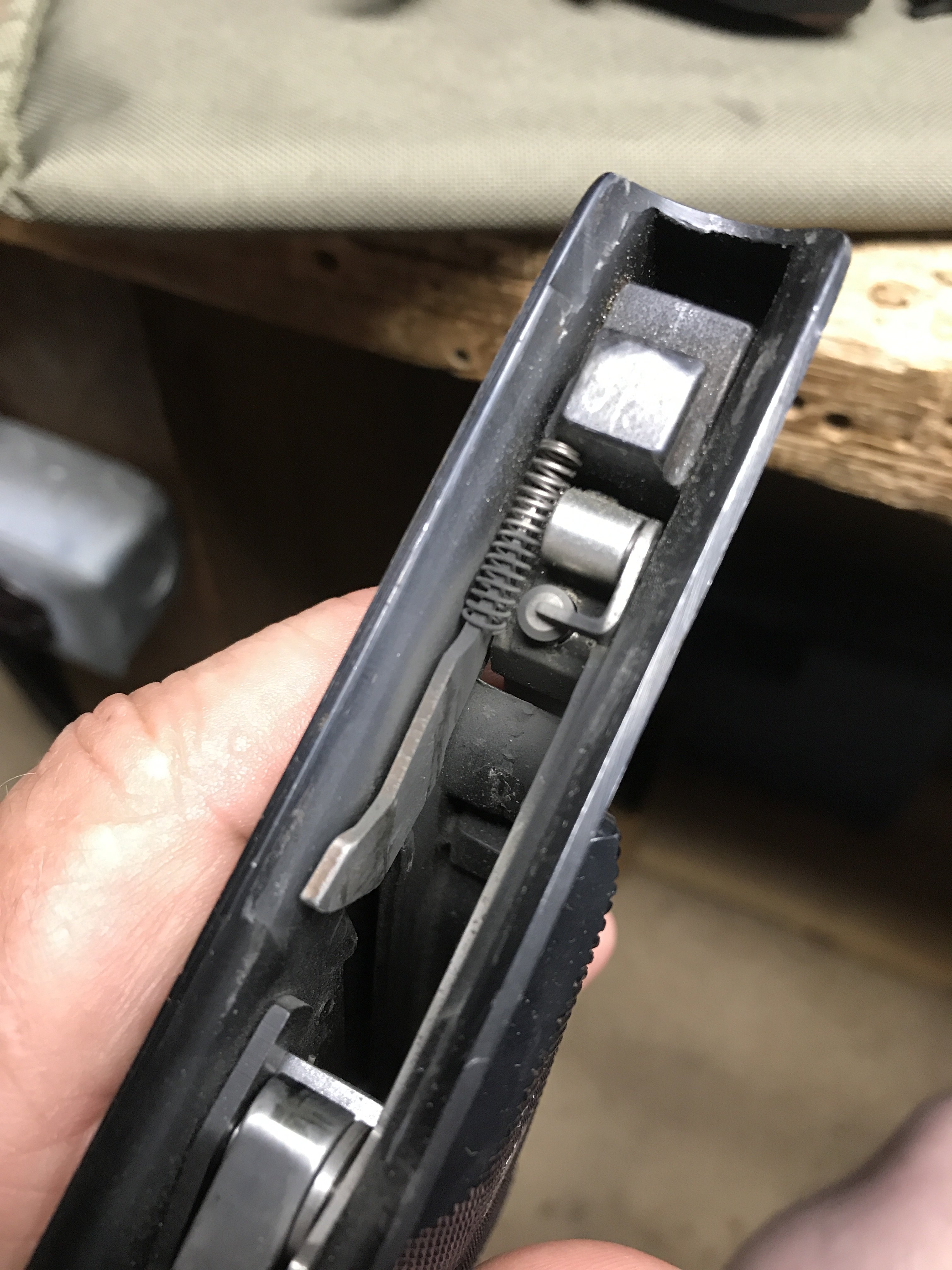

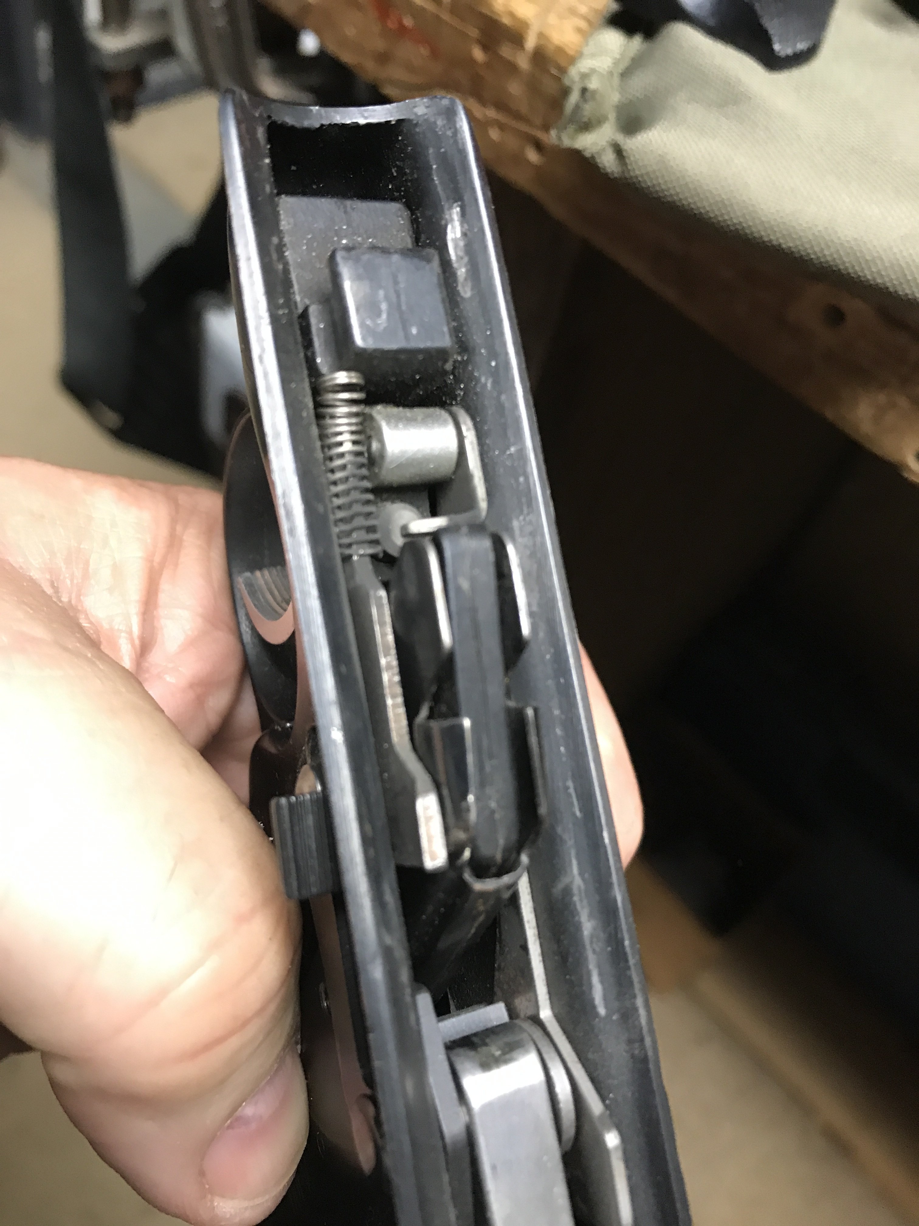

I have done a similar mod to few A-100 frames. It is reversible but does add a hole in the frame.
I use some modified MK-II parts. I call them MK-1.5’s.
I think these pics are from the first one I did. Subsequent versions were cleaner. The hardest part is the hole on the frame for the release button. It's easy to get oversize.
After looking at one of my conversions just now, I could see you just removing the stud for the release to accomplish what you are proposing. I'd still modify the stop to capture the spring.

Having done this, what would it have taken to just put in the bolt stop alone without the bolt release? In other words, how many modifications to the existing gun parts were necessary to insert the stop, and would it stay in the proper orientation with just the front pivot point engaged? Like without the side 'mushroom' pin that engages the release lever?
I like the way you did the spring on the stop.
Dan, did you need to modify the MKI bolt face to engage the stop?
It’s been 15 years so I don’t remember all the details.
I may have modified the the trigger to make room for the spring.
I “think” the trigger pivot will keep it in line without the release mushroom.
I remember thinning some pieces, but that may have been just to get the release to fit. Something is rolling around in my head about internal clearance, but cannot pinpoint the reason.
No bolt mods at all.
If I get time I may pull one apart to see what memories get stirred.

Nice work Dan.
You definitely had to thin the left side of the mk1 trigger or replace it with a mk2 to accommodate the stop. Either way, you also added a notch near the top to accommodate the spring. The OP would have to do similar work on the trigger.
Additionally, you had to replace the hammer pin with a mk2 pin and either modify the left grip panel or replace it with a mk2. Both of these things are for the stop thumb piece. The OP could skip these mods if he left the thumb piece off.
I'm not sure if you did anything with the trigger pivot pin. If the stop spring holds it in place okay, that's great. If you had to do something special there, it would be really nice if you can share what you did.

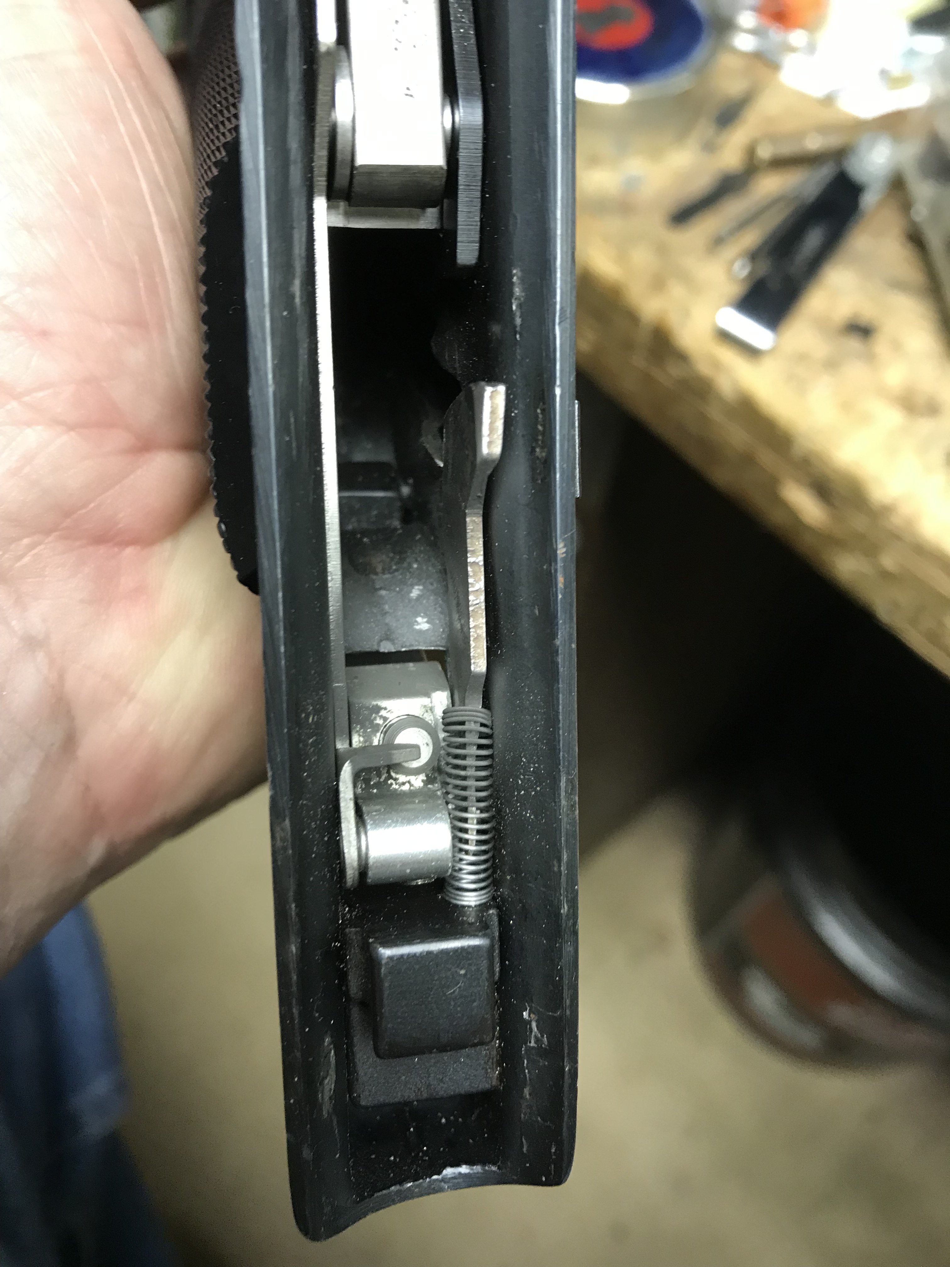

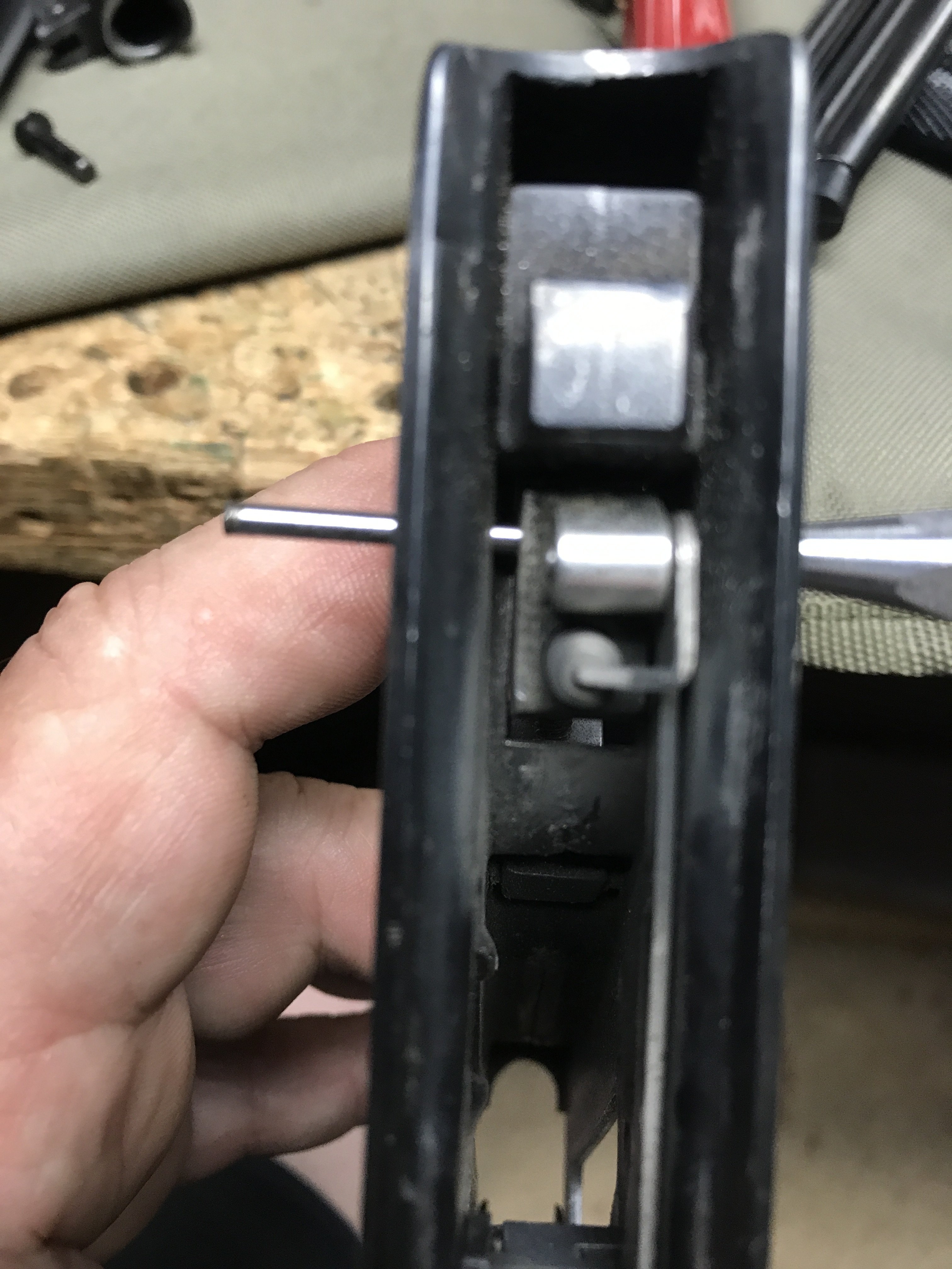

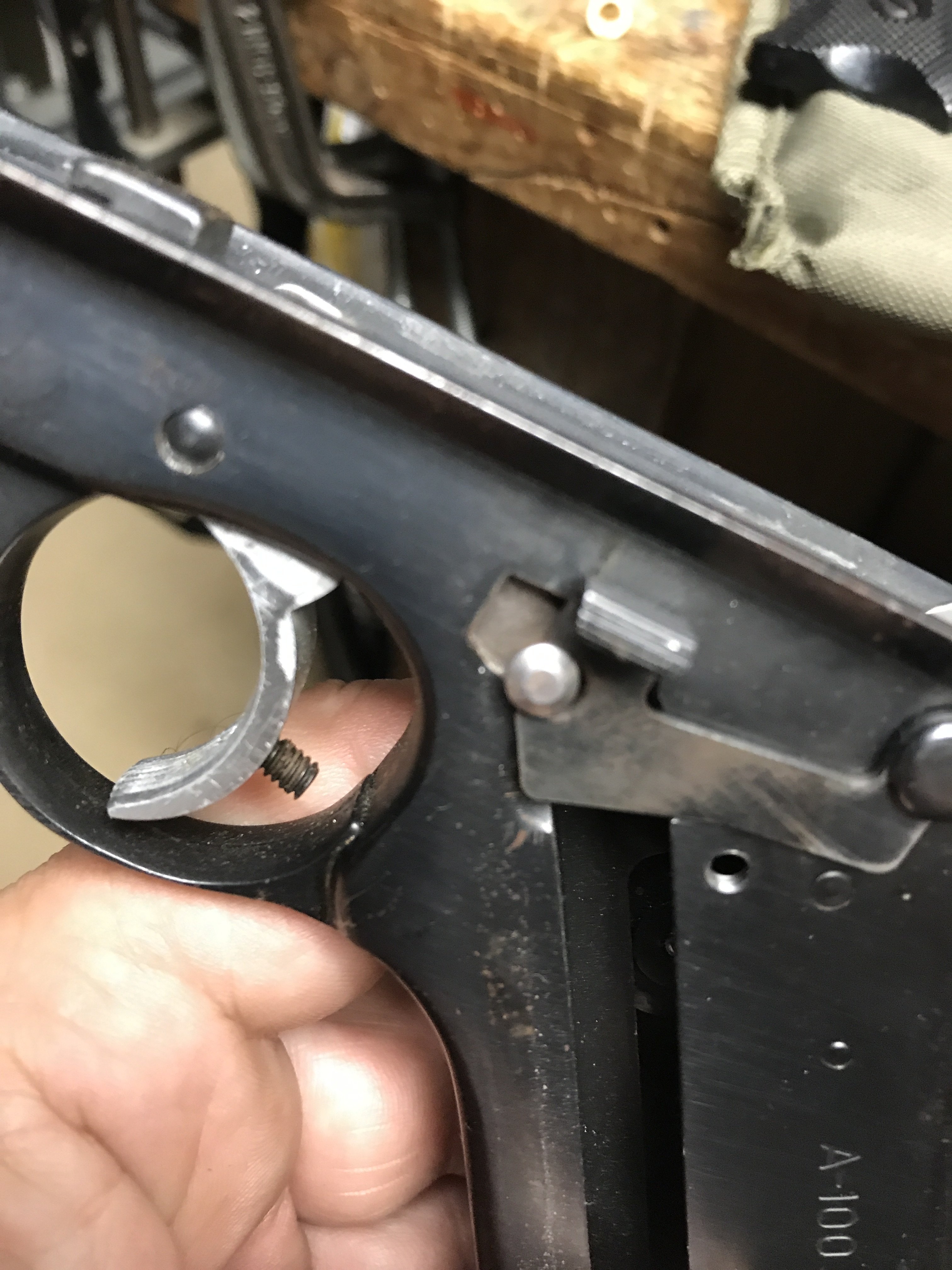

Ok, I just tore one down.
Yes, I swapped to MK_II trigger, easier than modifying one and have a parts bun full. Swapped to Mk-II hammer pin. Swapped grip panels. The E clip still fits for the trigger pin. I just added it as I was running without it before.
I saw no signs of thinning this one to fit. You just need to make sure the mag clears.
I know the spring is up in the 3rd pic. I had just been messing with it.

Super cool. Used triggers are cheap. Does the C-clip remain accessible after the stop is put in? (I'm sure this will be clearer when I actually have one in front of me.)
Spring by Bic?
