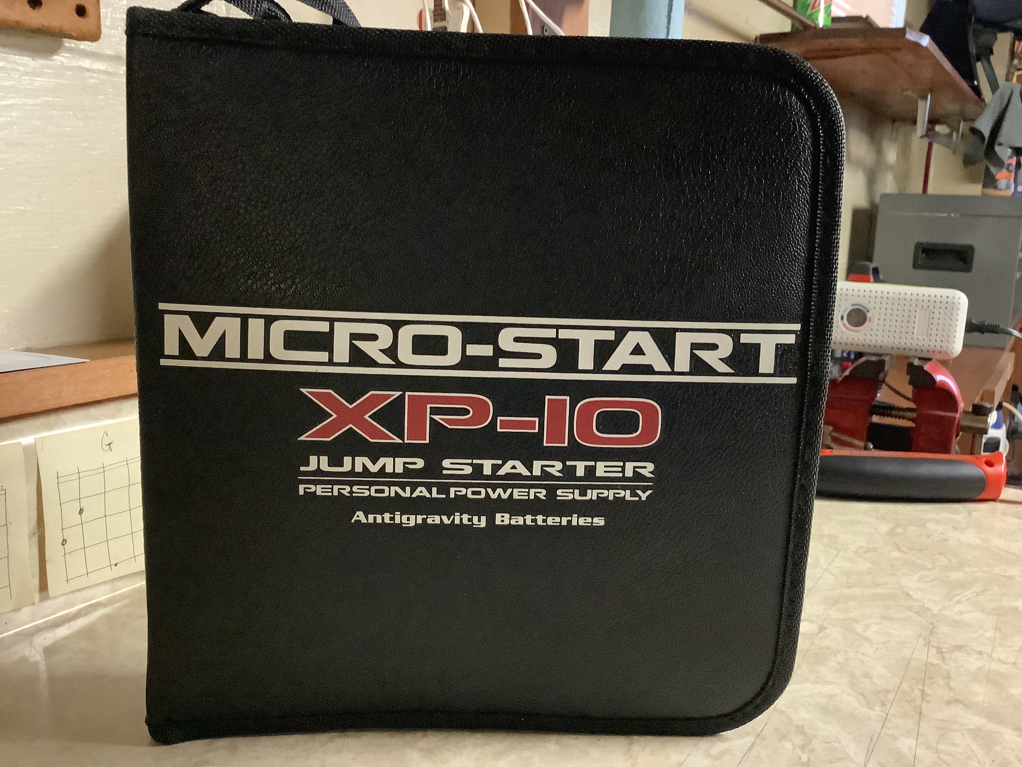

I plug this in to charge it maybe twice a year for 10 minutes just to keep it fully charged. I’ll never use the old style units again.
https://antigravitybatteries.com/products/micro-starts/xp-10-g2/
  • Jump-Start most any Vehicle. Cars, Trucks, Motorcycles, much more
  • Start Diesel Trucks up to 7.3L and gas engines up to 10 Liters!
  • Charge Phones, Tablets, Laptops, 12V devices and USB devices (Apple or Windows)
  • DC (12v) OUTPUT, Type C USB IN/OUT and Type A QC USB
  • Type-C PD 30w Super Fast Charging (3 hr recharge)
  • 600A starting current / 3000A peak
  • 16,000 mAh capacity (59.2 Wh)
  • Bright LED Flashlight built-in
  • 9.6 x 4 x 1.4 inches (245x104x36 mm)
  • Carry Case and all Accessories included
I have this one, works great.
