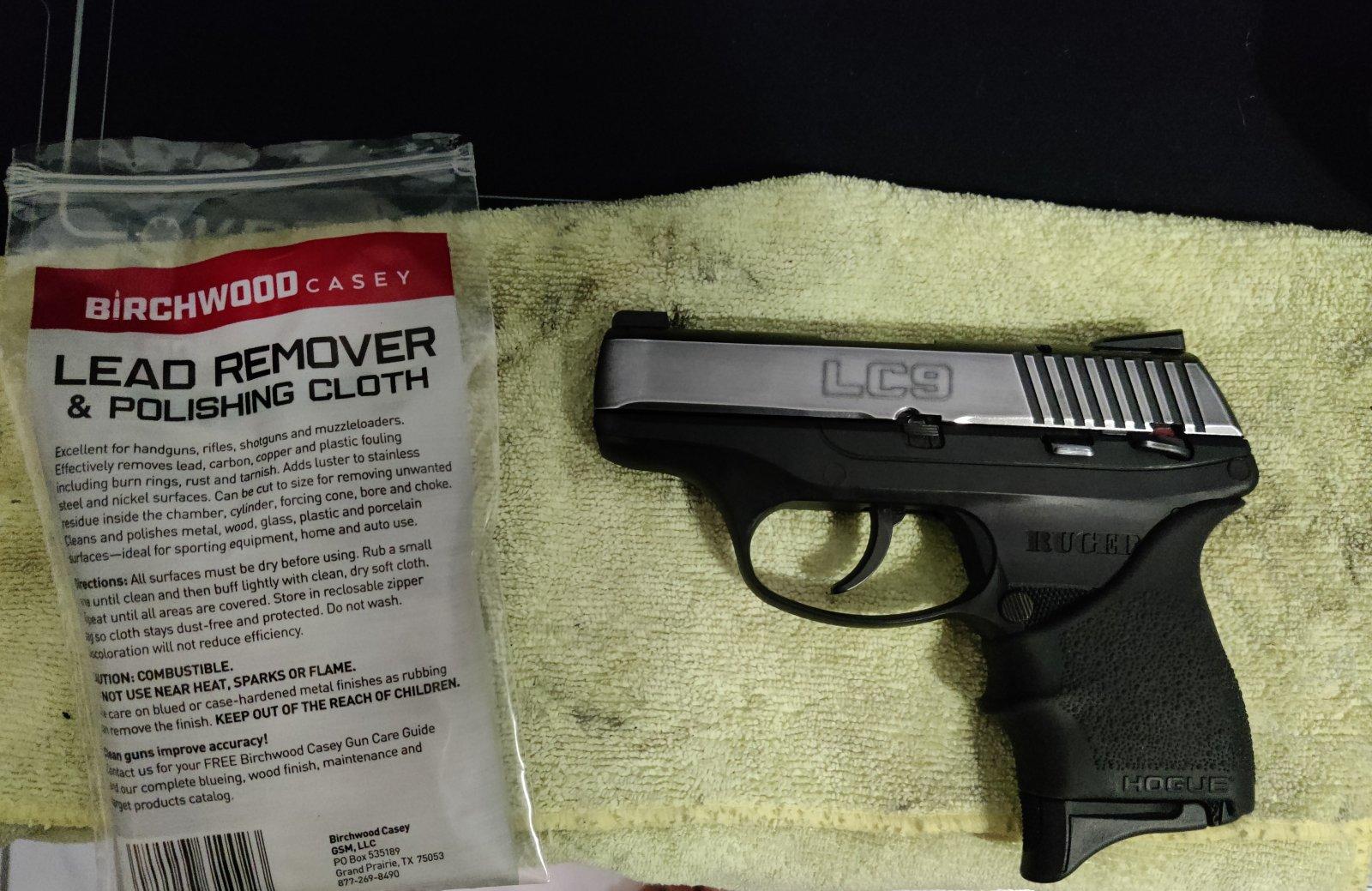

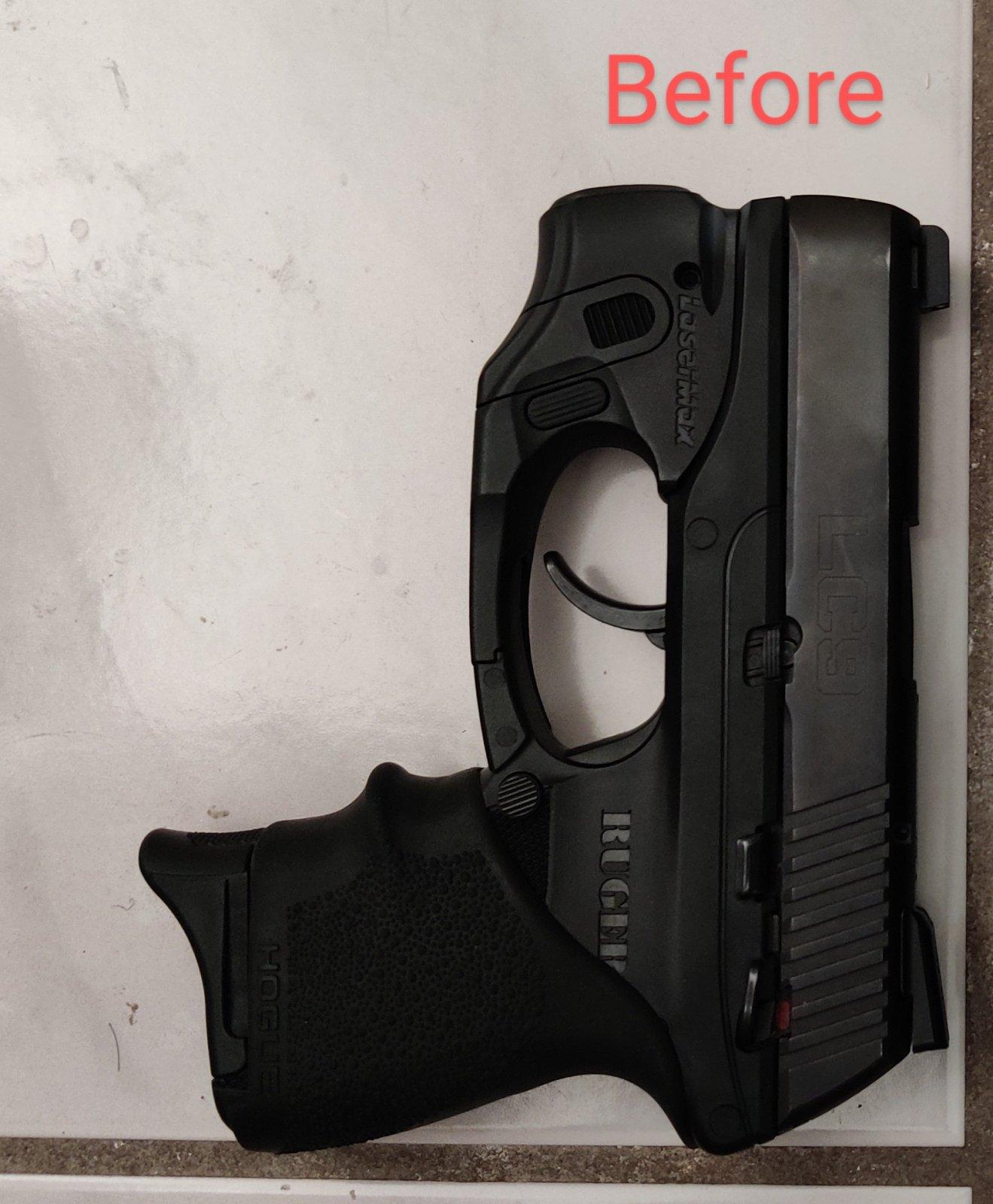

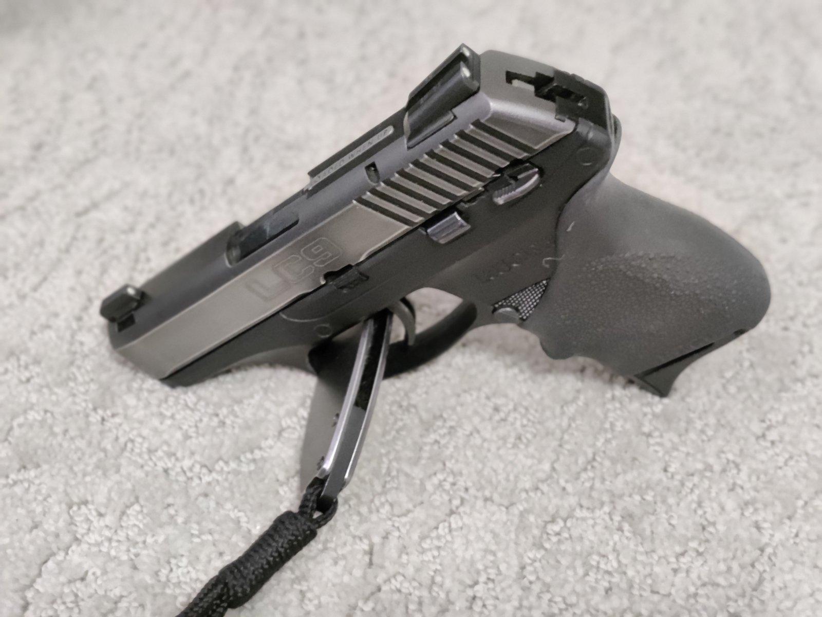

Get a YELLOW Lead Away Cloth it will take the blue away in a very controled way.
When you got it just the way you want it, give it a very hot water bath and then oil it.
This stuff works wonders on cleaning up stainless guns and will remove blue like no other, So when your done make sure you put it away from your blue guns.
This works wonders!! I loved the way it turned out (before/after comparison - see photo attached)
