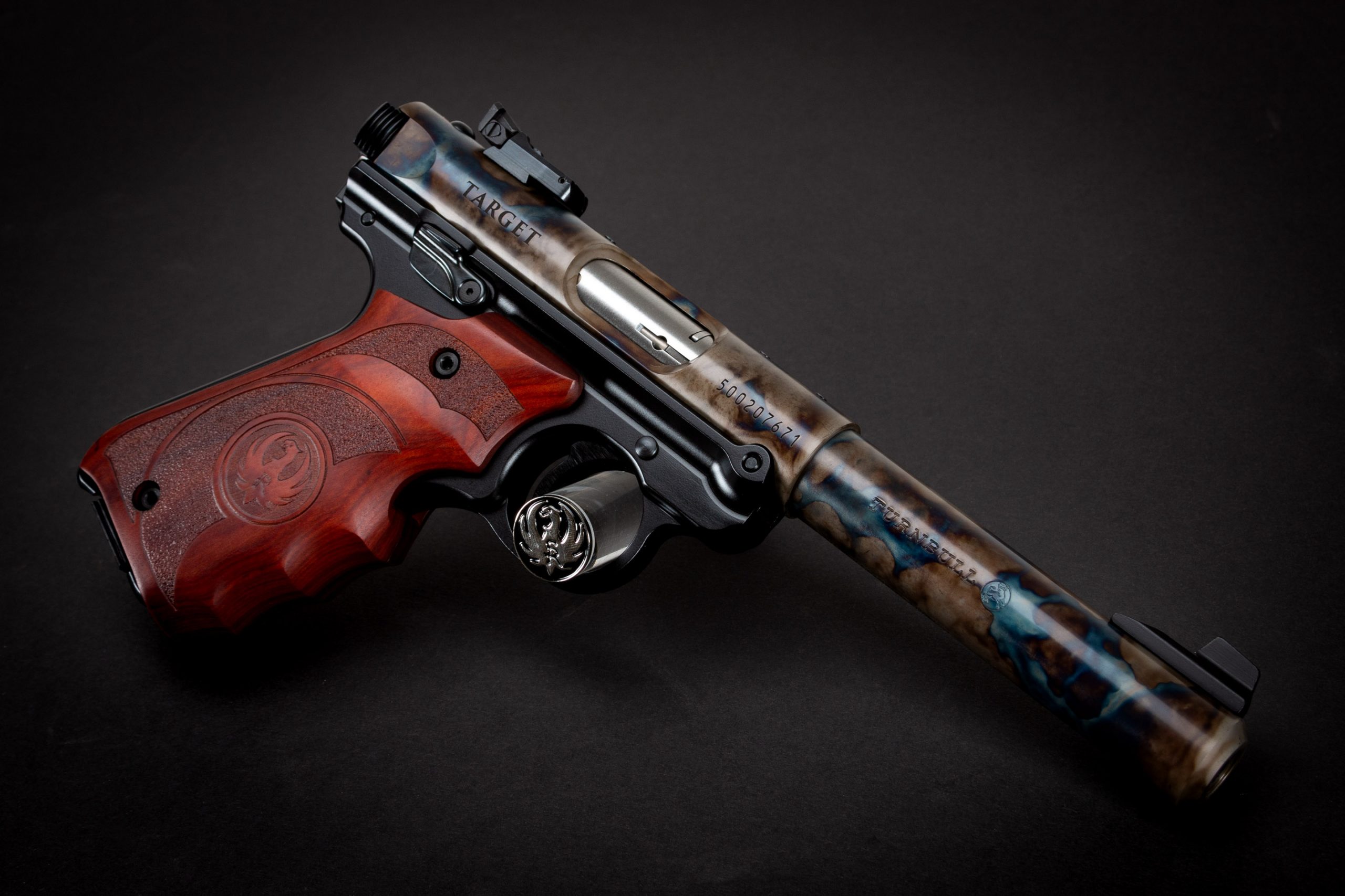

An exception to this would be the Ruger MK-series Turnbull has done, which included the barrel.
