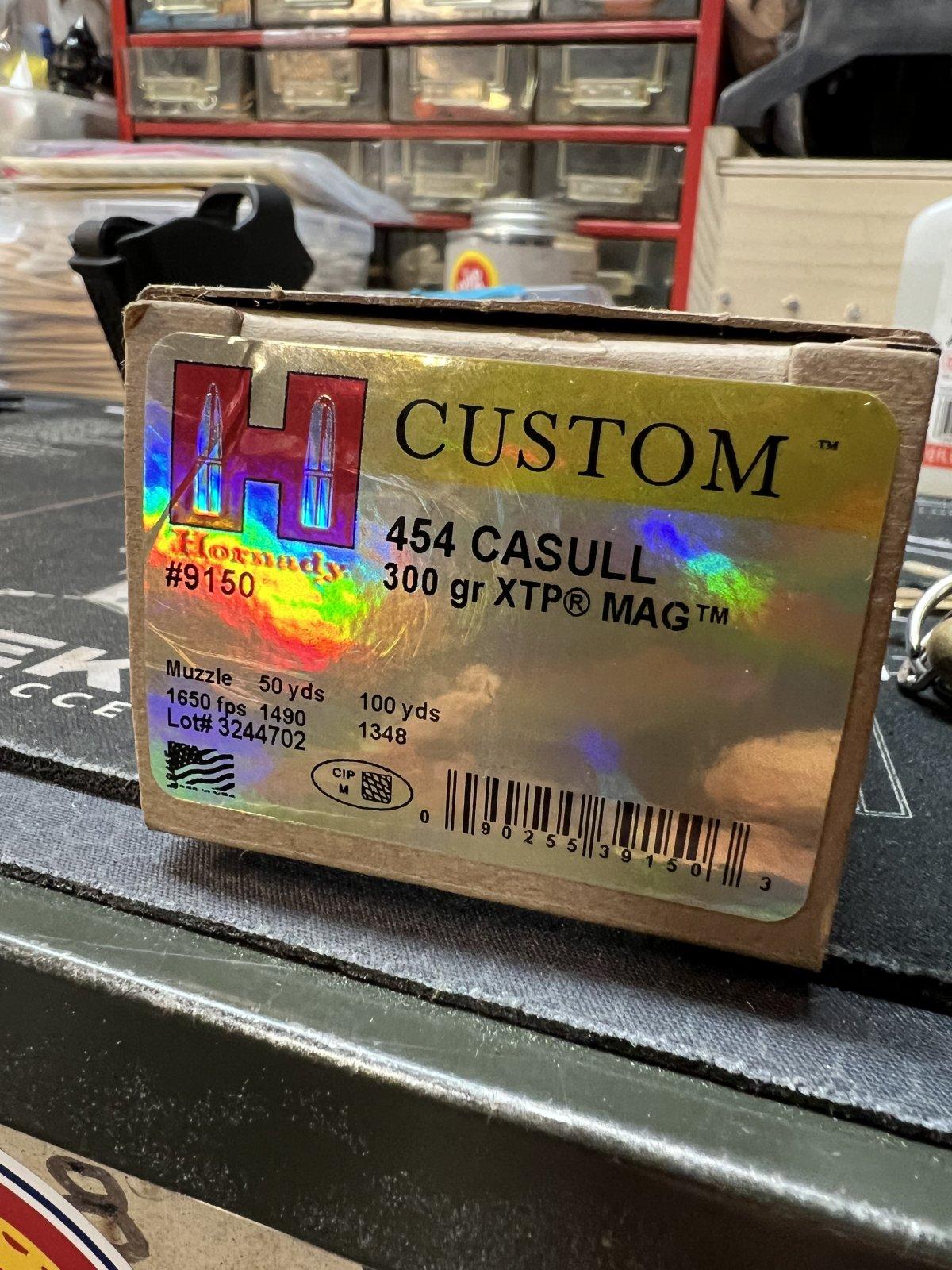

I have a squib stuck in my Alaskan .454. It is in the barrel but still stuck in the chamber. I cannot open the cylinder.
Am I correct that I need to put a brass punch down the barrel and drive it back into the cylinder?
It is a factory loaded Hornandy BTW. I guess I should contact them too?

Thanks guys, I got it out. Brass rod and a hammer. It was stuck good. Once it started moving it came right out.
Once I got the cylinder open there was powder everywhere.
The primer definitely went off the bullet was probably 3/8" down the barrel. I drove the bullet back into the case.
Gary at Hornandy is sending a Fed Ex call tag.
It was loaded in September 2024.
I will update with anything else
Thankfully there wasn't a bear charging me! 😂
Ironically this is the most expensive ammo I've ever bought. My first squibb.

My son stopped by the LGS today and mentioned it. They said I was the 3rd guy with a squibb from that lot of ammo. Just at their store.
What @buckeyeshooter said about the crimp makes sense. Or contaminated powder.
It is bothersome that someone could be relying on this ammo in bear country.

I still have the ammo in my possession. How would I check the crimp?
You could check the rest of the box if you hold the case firmly and try to rotate / spin the bullet. If it rotates the crimp could be bad or the case wall could be too thin.

Upon close examination.
The crimps are definitely not good.
On 2 of the 48 remaining I could spin the bullets by hand.
This has been quite the learning experience.
Thanks guys.

Hornady never got back to me. I called them today. He basically blamed me. Saying that the reason was case set back because I didn't mitigate recoil correctly.
I asked if he noticed some of the remaining bullets could be spun by hand. He said yes because they were in the other chambers when I fired the first round. I told him they were from the box and not ones that were in the cylinder.
He said he would replace it, but that those bullets were too heavy for an Alaskan, and case set back would continue to be a problem. Then he said it would help if I installed a supressor! I can only think he meant muzzle brake?
I told him when my son mentioned it to the place of purchase. They told him they pulled that ammo because I was the 4th guy who had problems with it. He told me there was no record of that.
I don't know what to think
The replacement box my son bought all went boom no set back issues.
