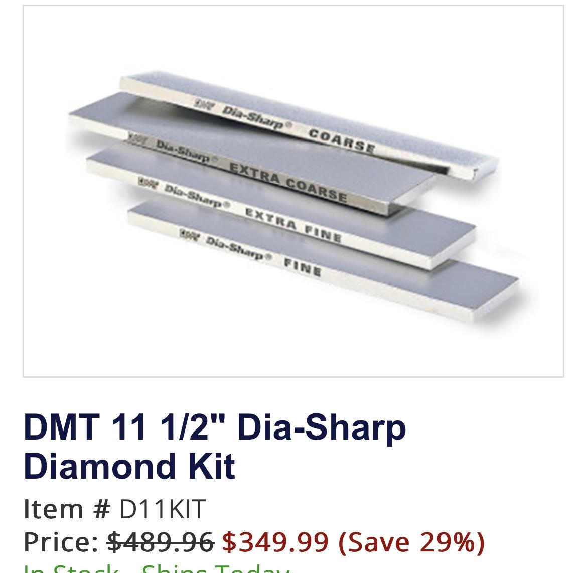

Some knives I just sharpen on my coarse diamond plate. Others never see anything but the fine plate.
Extra coarse is for reprofiling or removing lots of metal fast.
