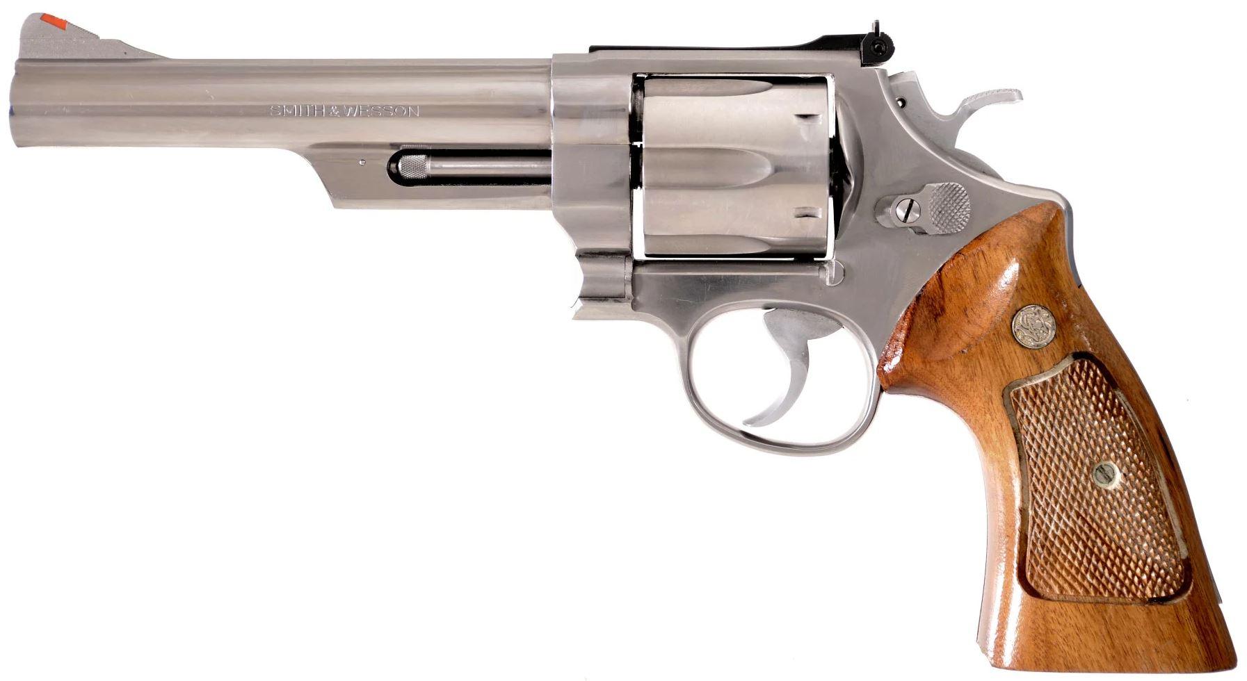

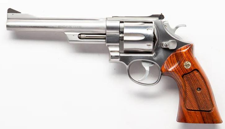

OP you mention the S&W mod 24 handling near 44 mag loads. I have seen a couple of Mod24 & 624's fall victim to that thinking with bulged and cracked forcing cones. The load was the Keith bullet and 2400 load Elmer used.
I think that the main reason for bulged and cracked forcing cones on S&W M24 and M624 is longer unsupported barrel protruding from the frame, to compensate for shorter cylinder:
M624:
M629:

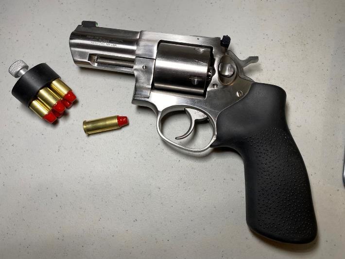

OP here - I've settled on a load that is very accurate in my GP100 44 Special:
240 gr LSWC (Lee tumble lube mold, Prismatic powder coat)
7.0 gr Unique
CCI #300 primer
OAL 1.465"
Starline brass
Lee Factory Crimp Die 1/2 turn
I haven't chrono'd it yet.
