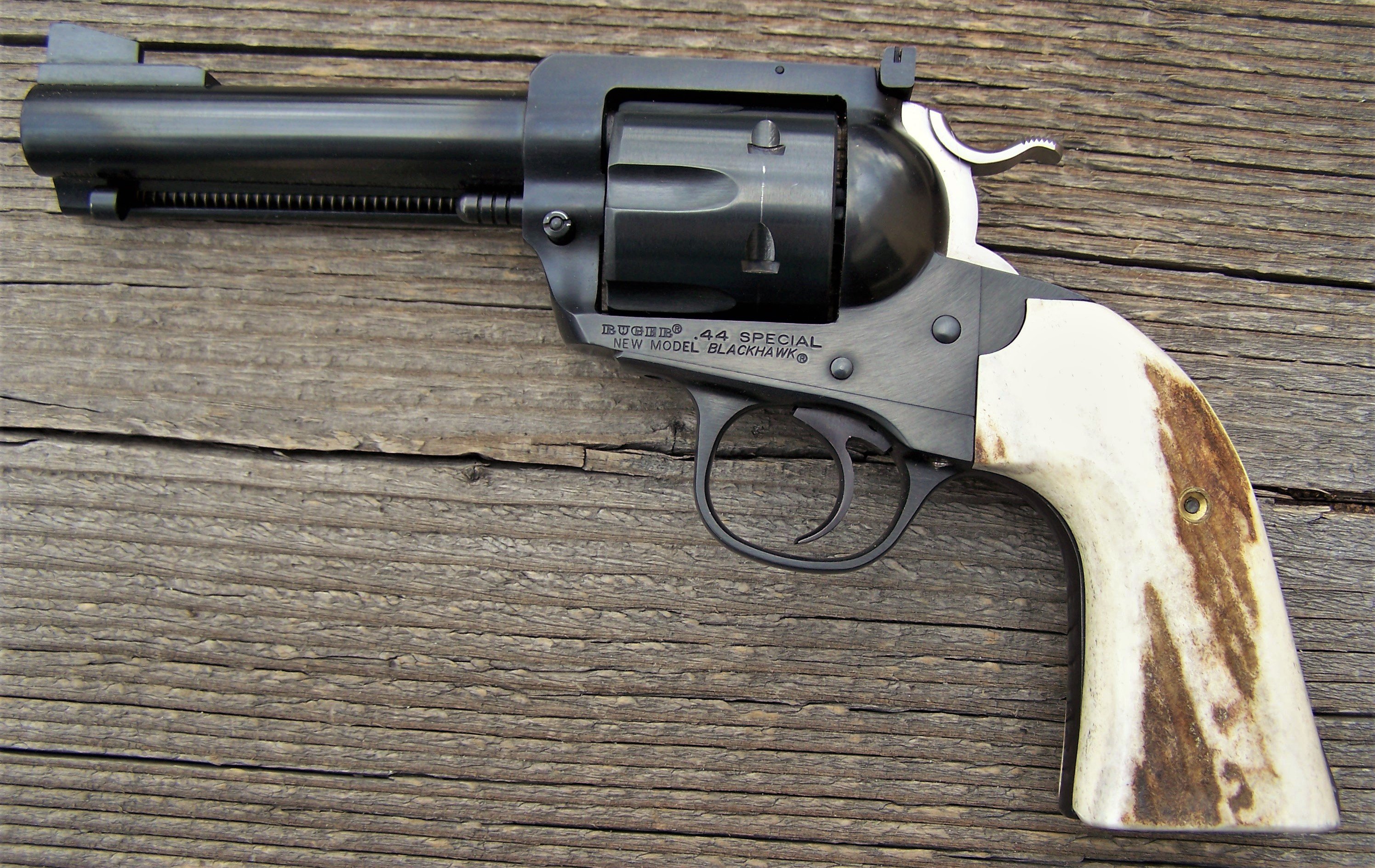

The original Colt Bisley grip was more or less designed for a British style of target shooting. Usually less potent cartridges which allowed one handed with the arm extended but the elbow not locked. No Weaver, no Isosceles, no two hands. They work pretty well that way.
Even early Colt double actions followed this design for the "pocket pool" shooting stance.
Not a true Bisley, Ruger modified the grip with a better angle for a more evolved American two-handed locked elbow stance.
Still fine for concentrated, aimed fire but not great for instinctive or point shooting. In fact, most will impact low when point shooting.
The recoil will "feel" different as you will tend to hold it higher. The gun will not rotate up as much and push straighter back.
So it is not a magic solution for anything but more of a different tool for what style of shootin you're pursuing.

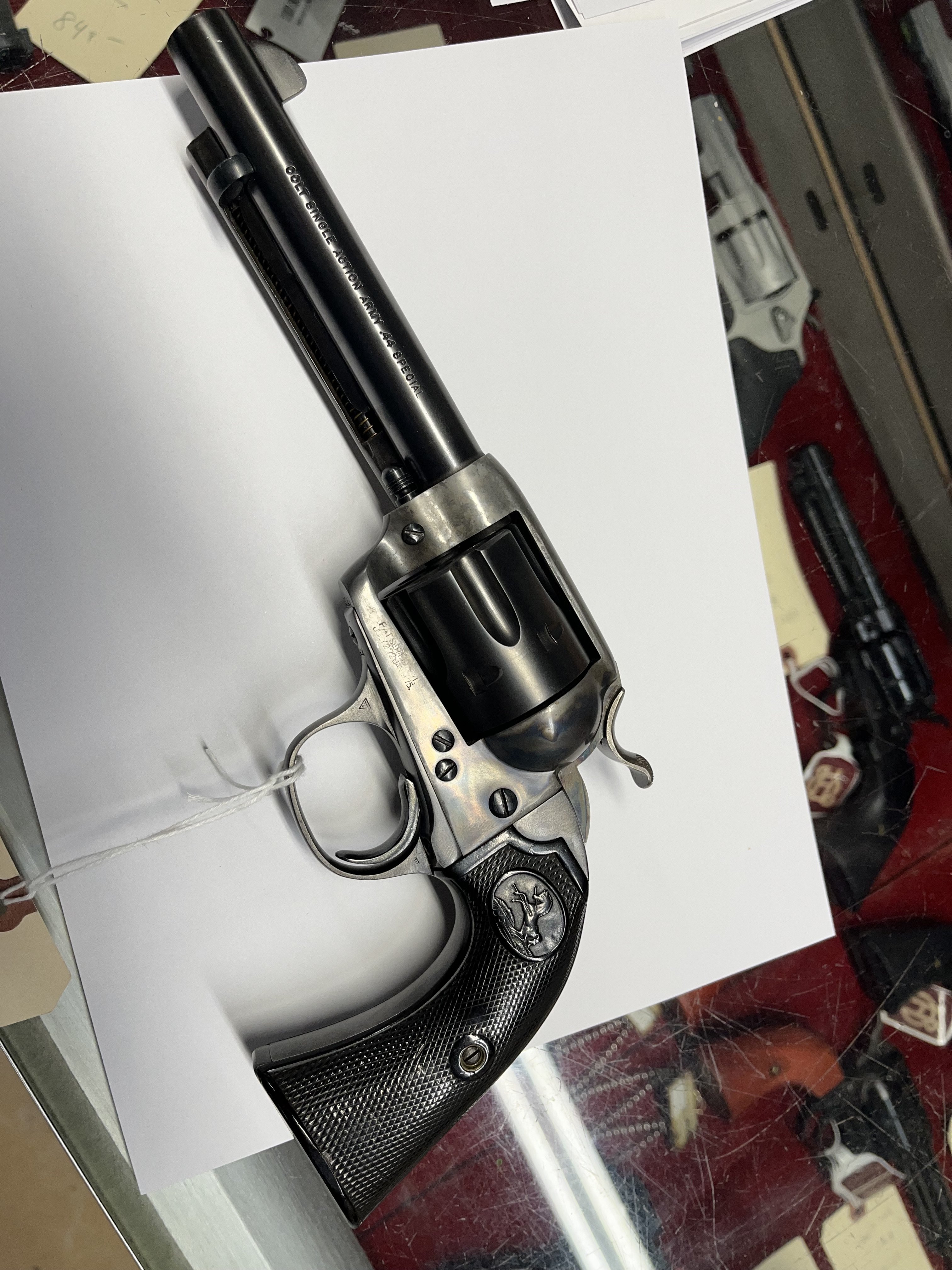

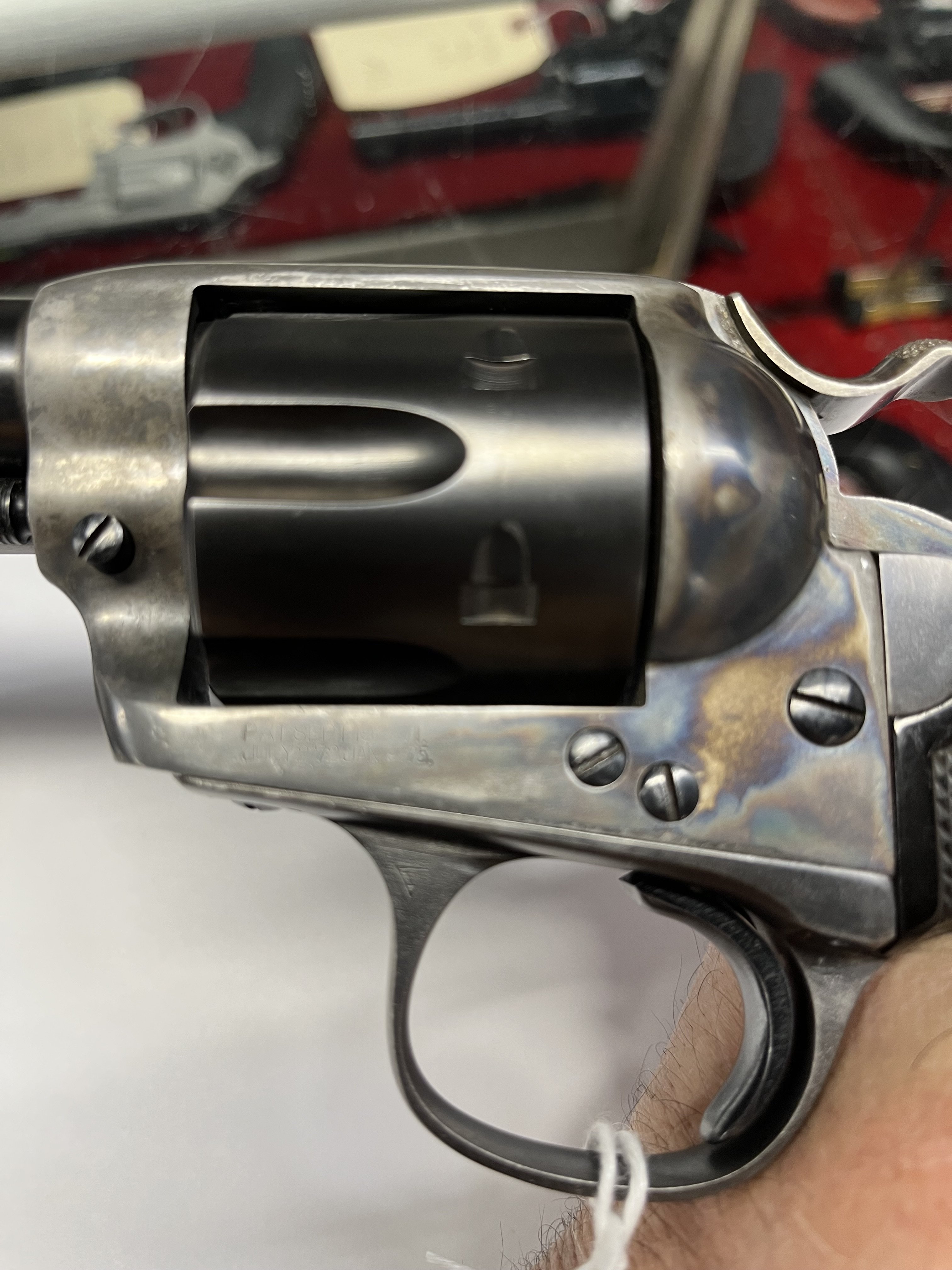

Here’s a Colt Bisley I had refurbished a few years ago because it was a basket case and needed a lot of new parts! It left the factory as a 32-20. But I had a cylinder and barrel in 44 spl. So that’s what it is today. Even had to find an original hammer as the one in the gun was mangled beyond use!

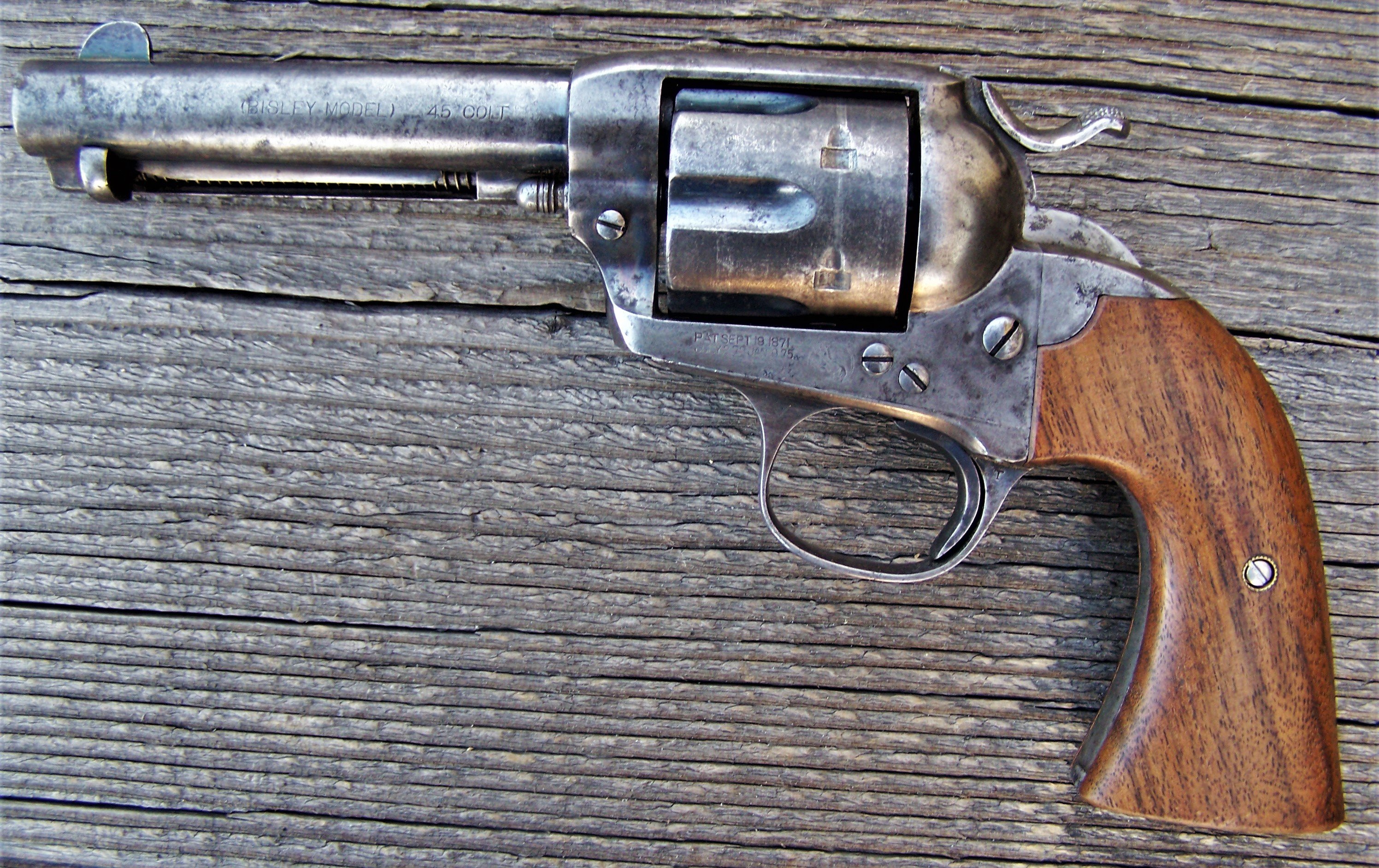

For some reason, my old Colt bis just doesn't fit my hand well. Still happy to have it in the collection, but it doesn't get shot much. Different strokes, and such...
