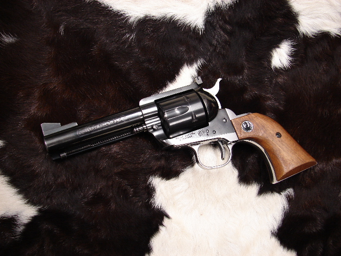

See the following guns/parts that were blued steel before being polished years ago:
An old model Super BH with S&W barrel
Here's a polished grip frame

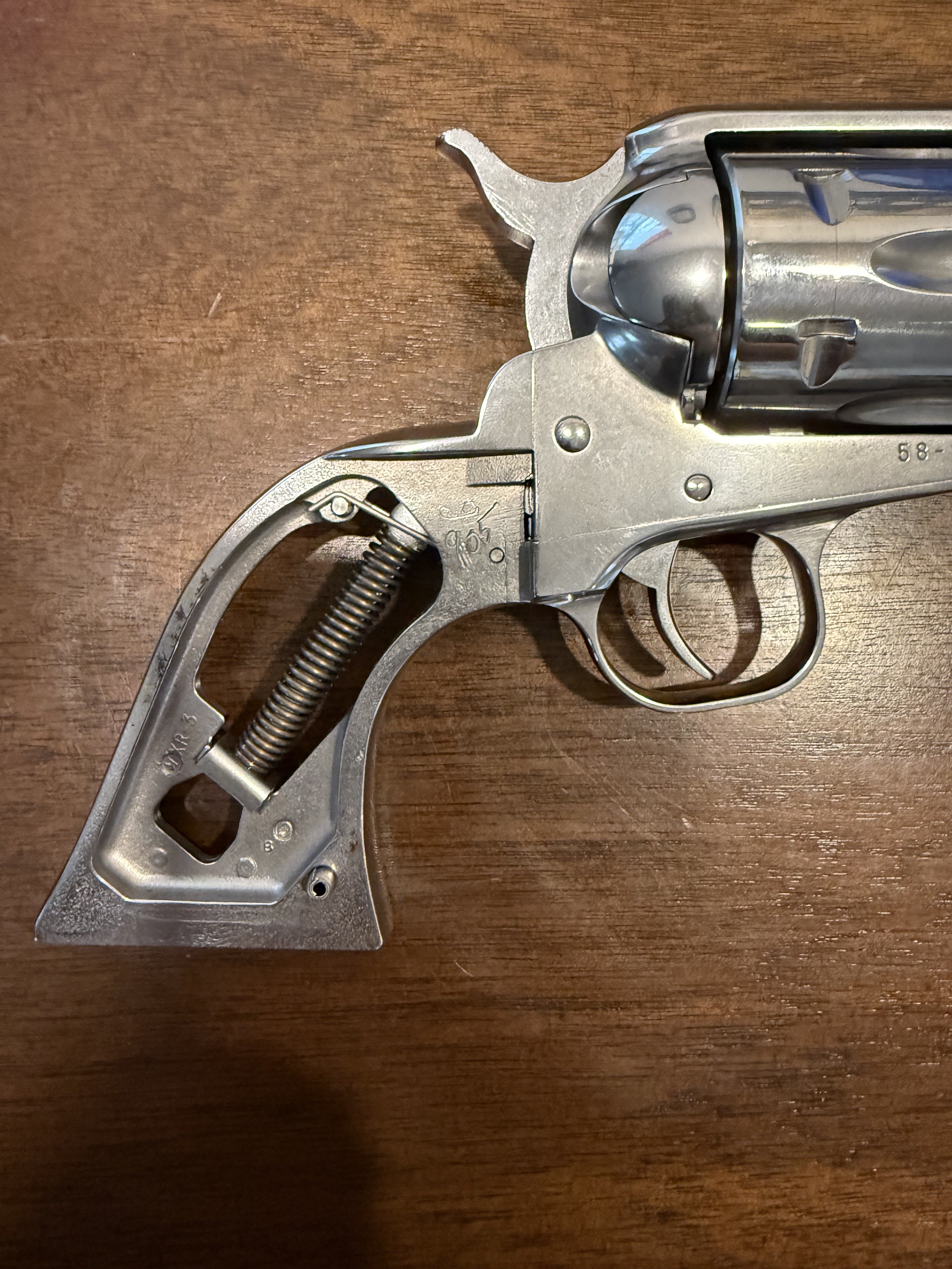

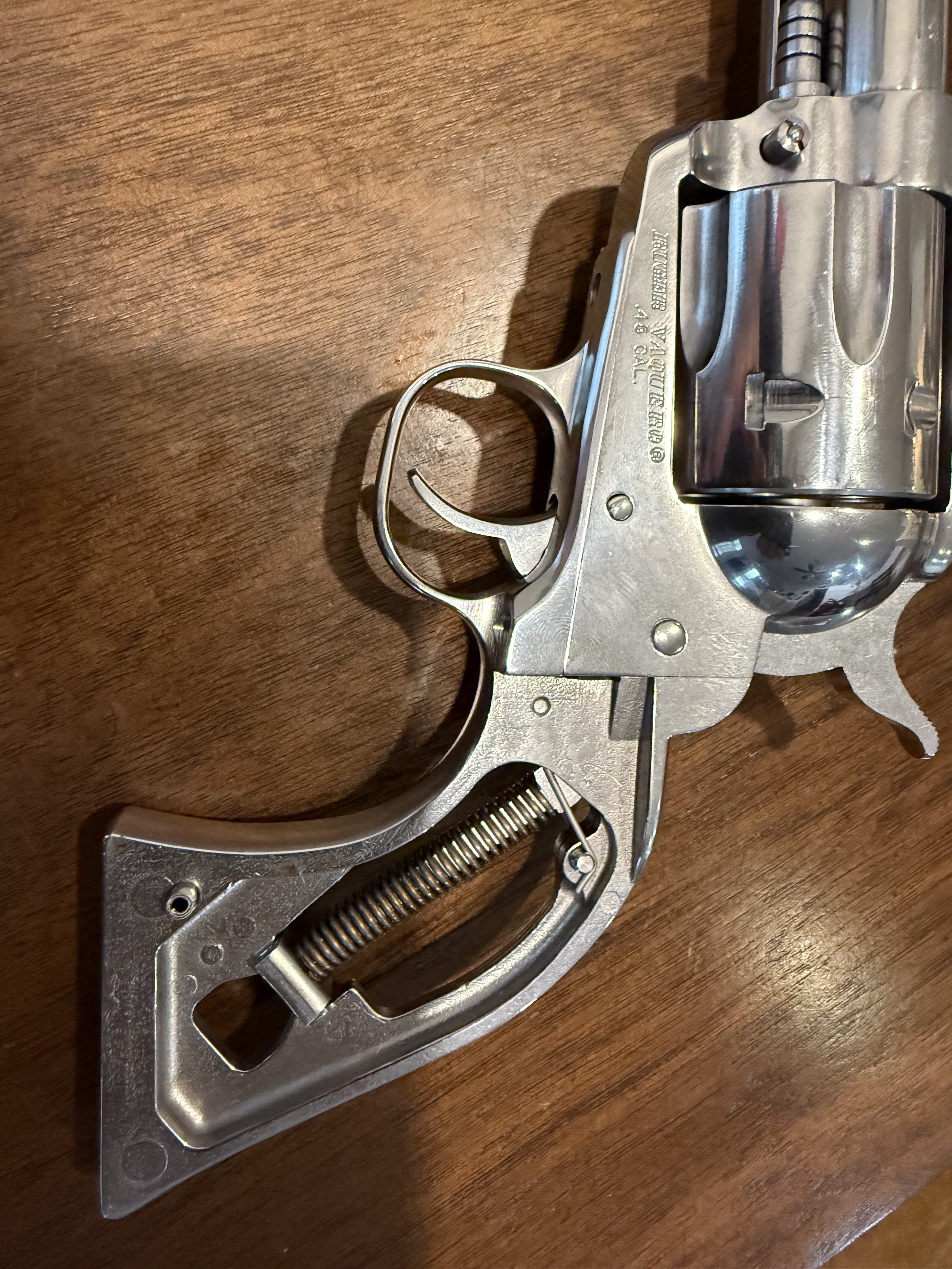

Hello all, I'm new to the forum. I've recently sold a New Vaquero and found a Vaquero that I purchased (I think they're referred to as Original Vaqueros here on the forum?). I'm glad to have found a resource to learn more about my gun, I can't seem to figure out which grip mine is. The serial is a 58- number and shows to be a 2001; even with the info given above by Hondo44, it doesn't seem to be exactly any of them, I'd like to know what I have for sure when I order new grips. Any help at all would be appreciated.
HJello all, I'm new to the forum. I've recently sold a New Vaquero and found a Vaquero that I purchased (I think they're referred to as Original Vaqueros here on the forum?). I'm glad to have found a resource to learn more about my gun, I can't seem to figure out which grip mine is. The serial is a 58- number and shows to be a 2001; even with the info given above by Hondo44, it doesn't seem to be exactly any of them, I'd like to know what I have for sure when I order new grips. Any help at all would be appreciated.View attachment 93523View attachment 93524View attachment 93525
The Vaquero uses an XR3-RED grip frame while the New Vaquero uses a near copy of the old XR3 grip frame. The XR3-RED grip frame is larger than the XR3 and like I stated can be changed to the smaller XR3 if you desire.
HJello all, I'm new to the forum. I've recently sold a New Vaquero and found a Vaquero that I purchased (I think they're referred to as Original Vaqueros here on the forum?). I'm glad to have found a resource to learn more about my gun, I can't seem to figure out which grip mine is. The serial is a 58- number and shows to be a 2001; even with the info given above by Hondo44, it doesn't seem to be exactly any of them, I'd like to know what I have for sure when I order new grips. Any help at all would be appreciated.View attachment 93524
Welcome to the forum!
You have the first grip frame on my list and shown in your photo. The problem is that the K is cast upside down!
Earliest production = KXR-3,
Next = KXR-3 with a separate N,
Late = K (in circle) XRN-3,
Most current = no casting #
So you have the most common size grip frame used by Ruger in alloy, steel and stainless steel. It differs from the New Vaquero grip frame size* in two ways: your grip frame has 1/8" longer space between the back of the trigger guard and front of the grip frame. And the New Vaquero size is only 7/16" thick, all other Rugers are 1/2".
*Except the 44 Mag New Vaquero which has the same size grip frame as yours (and is also built on the large main frame like yours).
Note: the old model grip frame sizes are XR3 and XR3-RED. When using these casting numbers generically to refer to New Model grip frames, to avoid confusion they should be followed by the word size. So your grip frame is the XR3-RED size and the New Vaquero has the XR3 size.
