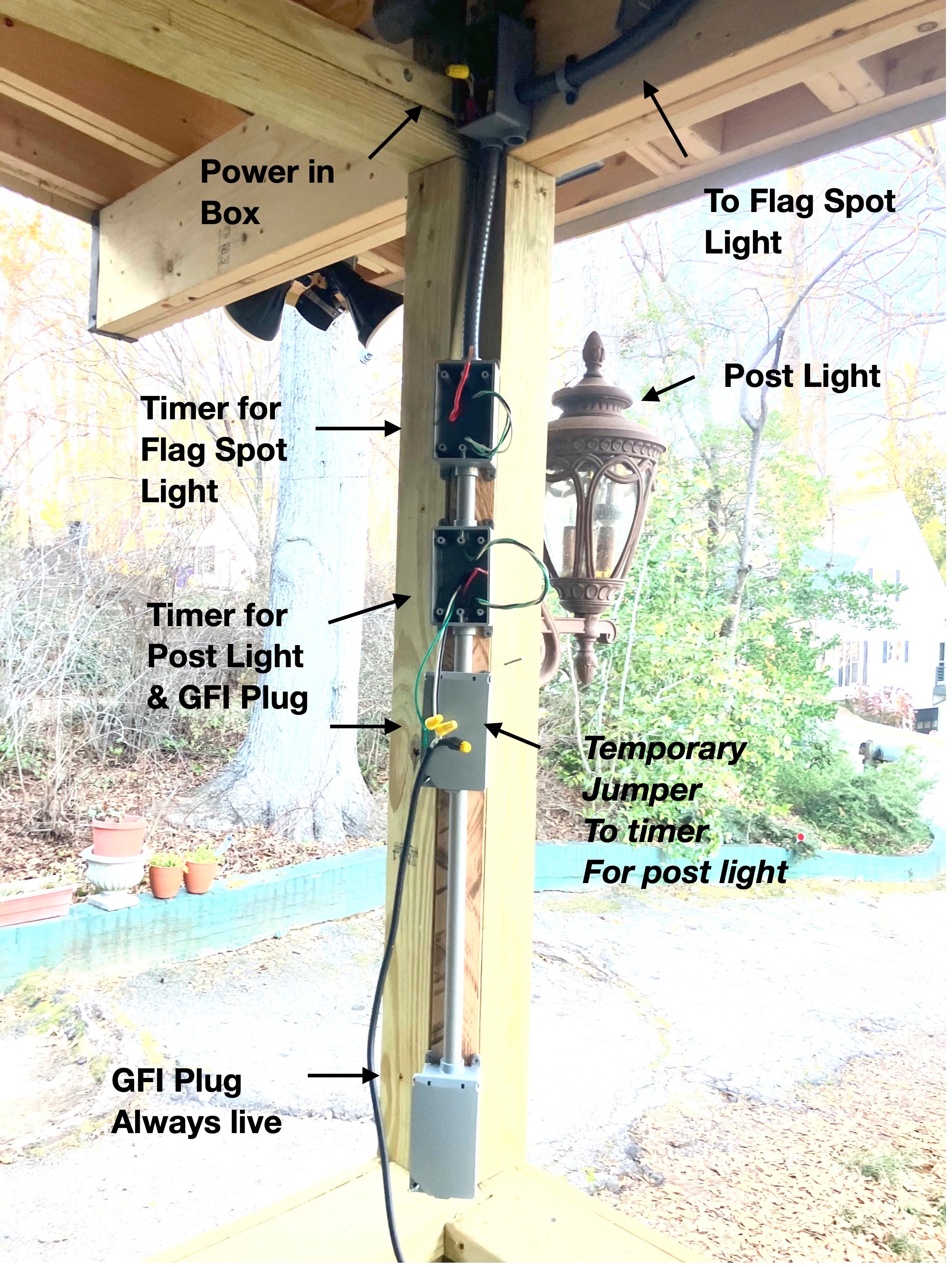

So I had finished all the electrical wiring on our new front porch. for those not in the know, the porch was heavily damaged by Helene and for over a year I had the roof temporarily supported and then back in November my neighbor and I actually rebuilt and reframed it. This is with a 4ft addition to the front.
Anywho.... the post light on the corner is on a timer, just one of those that plugs in and I also had the Christmas lights hooked to this. Last week as a final thing I decided to add a spot light for our Flag on the front with a photoelectric cell to allow it to turn on at night and off in the day time. Got it all hooked up and then the dern thing would not work.... I could not figure out if the light on the post was defeating the photocell or if the cell was bad. It is one I had saved from some previous light.... but I turn off the post light and the spot still won't come on... dern. And so I decided to just redo the whole thing with timers. Two separate timers that actually go in boxes and are hardwired.... one for the porch/post light and Christmas lights and one for the flag spot..... this actually meant pulling everything apart and adding more conduit and boxes.... about 3 hours in I put my ladder up to remove the photo cell from the spot light and discovered what the problem was. The spot light I'm using has some new fangled LED bulbs that are not only adjustable from 60 degrees to 25 but also you can adjust the brightness and even the color of the light....different shades or such... all these adjustments are on the bulb and I had messed with these while putting in all in last week.... seems the last time I put the bulb in I did not screw it in the socket right.....and that is why it was not working....

Just for kicks because I like doing this about as much as the silly electrical upgrade I did:
Here is a picture with notations showing the electrical for these two lights and plugs.

Well I got it all put together yesterday and I have to say getting the wires and timers packed into those two boxes was a real pain. I'm sure the number of wires exceeds code even though I did not check. (Yep, for those that don't know it there is a limit to the number of wires that can go in a box depending on its size... I think that number is imprinted on the box in iddy biddy lettering somewhere. But also I'm nothing close to a licensed electrician...
I just went out this morning in the dark and I really don't like the flag spot light.... too much light spilling out into the street... I'm going to have to rethink it.
