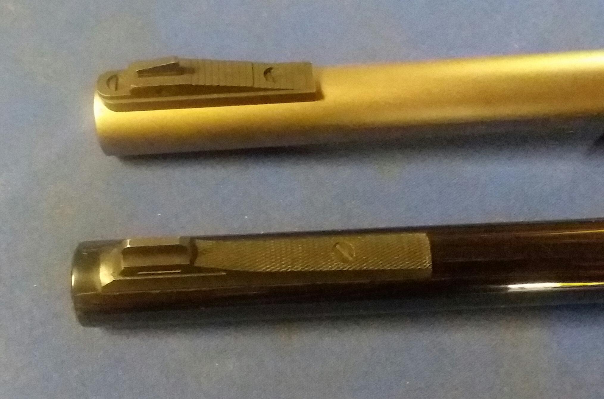

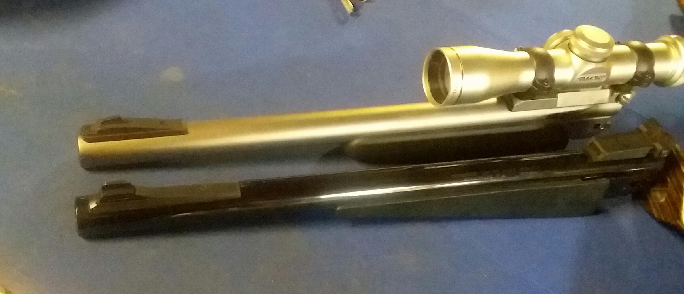

Super 14's had at least two designs of front sight base to barrel.
The top one is a newer design.
The bottom one requires a drift of dovetail to access front screw.
Indeed, the spacing may be different.
Here are two configurations that I have. The barrel with two holes is a 44 mag "Super 14". The barrel with three holes is a 41 mag "Super 14" that came to me with front and rear iron sights much like Gemihur posted.
