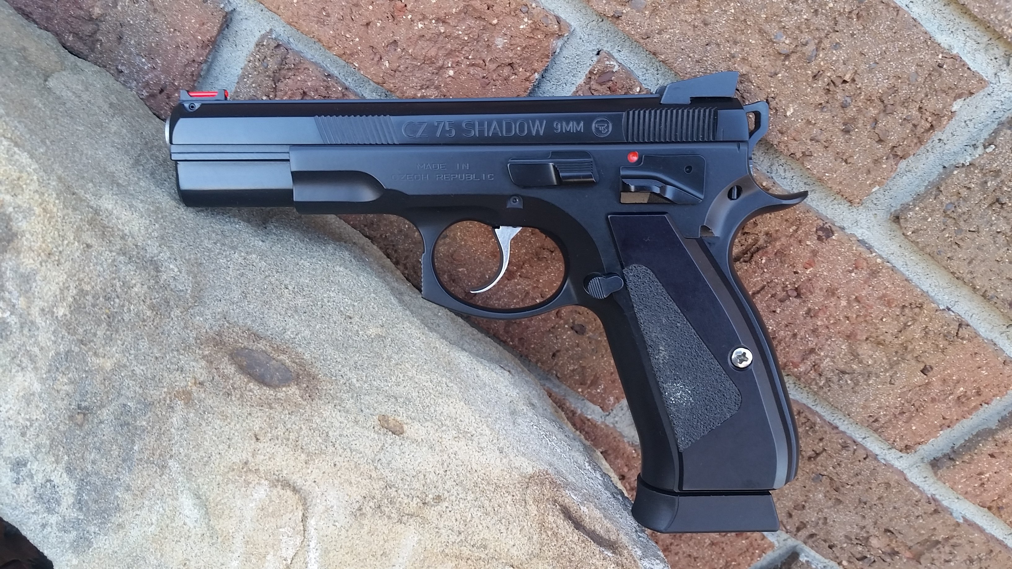

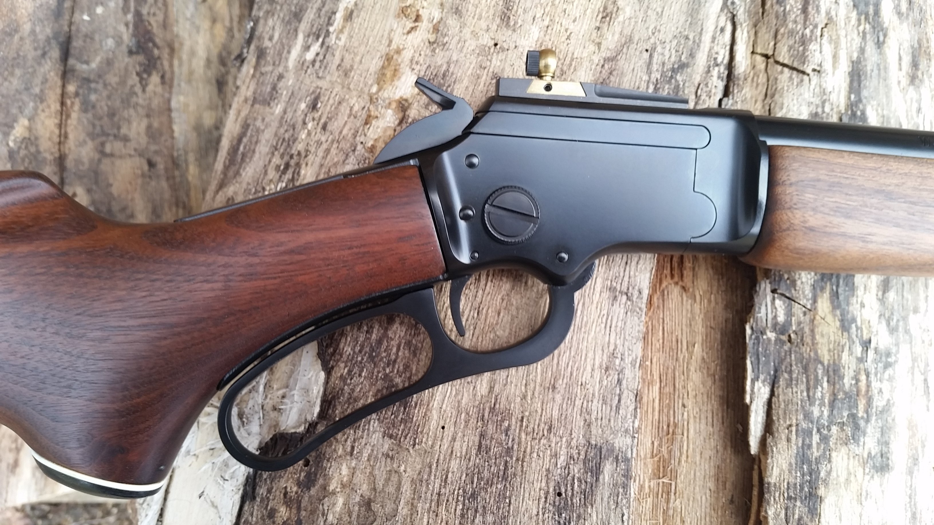

They did the slide on my CZ and refinished this Marlin 39A for me.

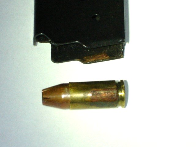

I was going to hold my tongue on this. I had eight concealed carry magazines Cerakoted by an "authorized applicator": six LC9s 9 rounders, and two P85/89 Mec-Gar 17 rounders.
The one that has been going in and out of my LC9s every day has worn through where the magazine release contacts the magazine, between the feed lips and the retaining port.
I switched the two spares I carry from my IWB Kydex magazine carriers to my OWB leather pancake, and the coating had stuck to the Kydex.
Yesterday, I tried to slide the top round out of one of the spare magazines that had been moved from the kydex carriers to the leather, and that top round was rusted solid to the magazine body.

Well, this morning I have no response from Cerakote, and an email from the shop that "We moved down the street", "We didn't guarantee nuthin", "We have no record of you in our system so you paid cash and didn't get a receipt or have any proof that you did business with us", "The coating didn't fail, it wore through", and "I have no idea who Mahovsky is".
I scanned in the four cash receipts and emailed them to him, and Cerakote.
I don't think that magazine ever fed a round into a firearm. It was loaded and then carried. I may have run nine rounds through each to make sure they worked, before the three I carry were loaded and carried.
There was no wear, scratching, abrasion, etc on the feed lips. That was a total failure of the coating that was damp from perspiration, once a week, for six months over the summer of 2025, and two months at the end of the summer of 2024.

I was unaware that brass rusted. :rolleyes:
I was unaware that rust would stick to brass. The rust illustrated to me that I was mistaken. It was thick enough I could put my fingernail against it and try in vain to scrape it off. Ten minutes rubbing it with CLR and a brass brush to get it out of the rim, then ten minutes rubbing it with Autosol polish.
Now I'm more pissed because that round wouldn't have fit in the chamber even if the slide had managed to rake it out of the magazine.
