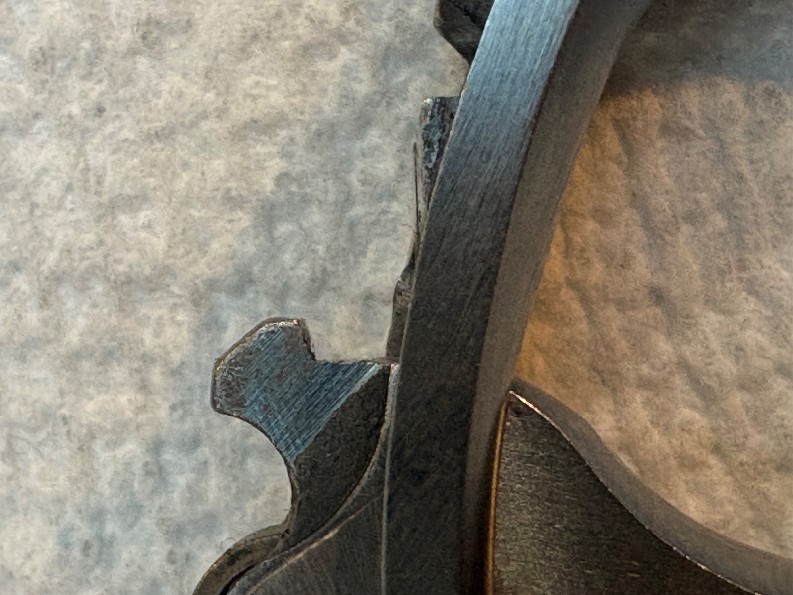

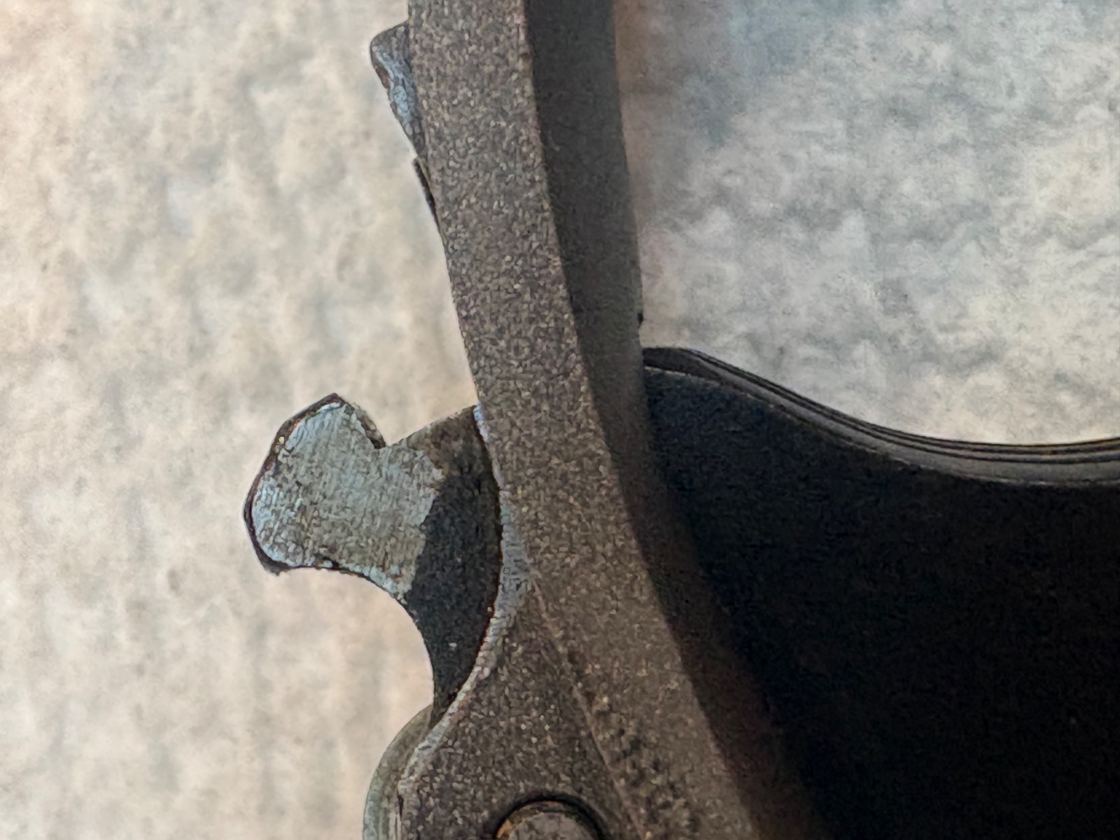

I have a working security six and have attached photos of the triggers at the point that it makes contact with the cylinder latch.
    390.7 KB
    462.6 KB
Just looked at the ones I have in stock and none look like the one on the left or the right. The one on the right looks a bit chewed up also. Have you put the trigger group from the working Six in the problem one to see what happens?

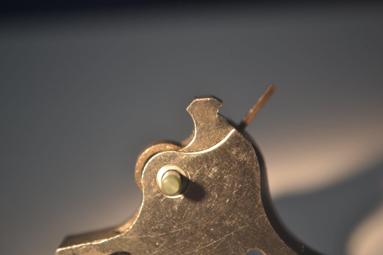

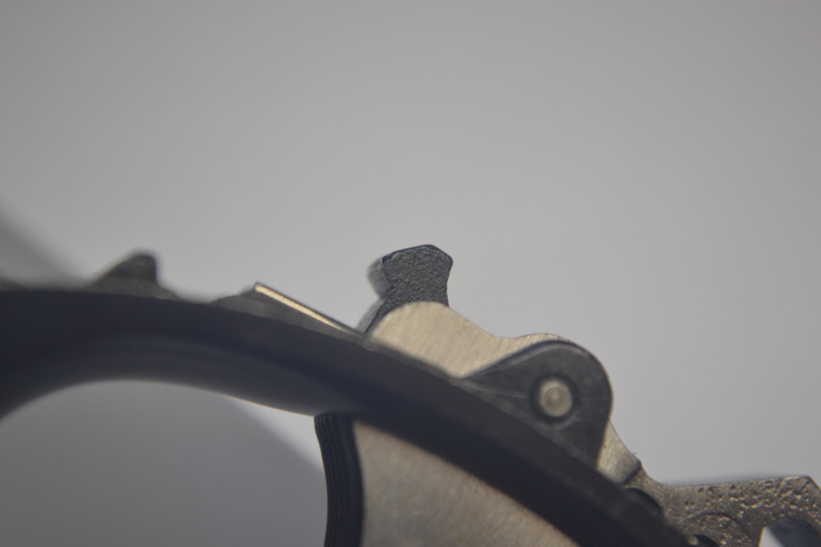

I'll get some pics of 2 of my extras as soon as possible and post.
My first try the pictures weren't that good so I tried a second time, these are better. These are pretty much unused triggers. You might be able to clean yours up a bit using small fine files (sometimes called Swiss files).
You can click on the pictures to make them bigger.
