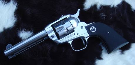

Stainless New Vaquero XR3 size GF on a polished Lightweigt

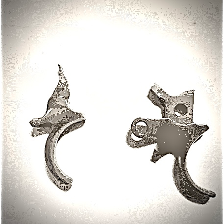

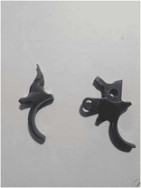

Since adaptor triggers got more expensive I've been splicing (tig welding) old model trigger sears to new model triggers like this Bisley trigger
Left: spliced trigger Right: NM Bisley trigger
Bisley trigger SBH Hunter SS grip frame
