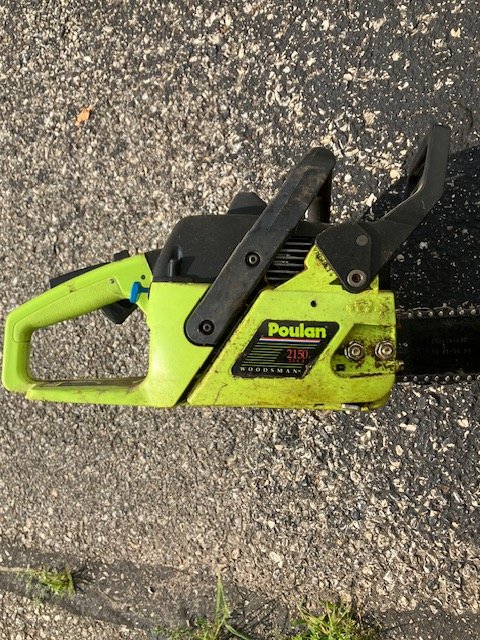

I just got a couple older used units and wanted opinions.
First is a 2003 Poulan. Sticker says 2150 but the tag shows 42cc? Anyway it seems to be in good shape. Had a tank of oil in it so I cleaned it up and put fresh (from today) gas in it. Followed the instructions but couldn't get it to go? Realized the primer wasn't filling with gas so I primed until it did have gas. Note I only put in about 2/3 full just to try it out. After that I got it to go but it seemed to rev fine and then bog. Seemed to run out of gas? Thought maybe the vent on the gas cap was clogged? Cleaned it the best I could and then tried to get air through it. Seemed ok. Tried starting it then taking the gas cap off at idle and revved a bit. Seemed ok. But it was on its side. Cap back and upright again, died. This is my first "full sized" saw.
Second is a old Craftsman top handle. Also made by Poulan. 358.352030 is the model. This is a 2.0 - 10"er but it has a bigger bar on it now. All was going well until I was putting it back together and the fuel line snapped off. So I need new fuel line. The bigger concern is the air filter. Obsolete. It seems to be just a little rectangle of foam. Looks like ebay has some that are described as for the Poulan 25 which I guess is the same?

Never had a Poulan but have two Stihls that have an exhaust screen/spark arrestor that can clog. If you take the exhaust manifold off you may see it clogged. On my Still it's about 3/4" square screen. Otherwise, it sounds like a fuel problem. I'm assuming you're mixing two stroke oil 50:1. I'm also assuming you know the oil reservoir is strictly for the bar & chain. I wonder if the gas cap is vented & clogged or maybe turn up the idle a bit. A fresh spark plug if you haven't already.

also should be a filter in the gas tank, I would check that then google adjusting H and L jets for that saw. I also have never had a Poulan, just Husky's but the fuel delivery system is pretty much the same on all saws
Your fuel pickup up may be clogged on the first saw you described. Make a hook from smallish wire and carefully lift the pickup tube out of the filler hole. The little screen/strainer at the end may be gummed up/clogged. Also. check that tube for cracks. For the air filter, you might cruise through the HVAC area of your local HD/Lowes/Menards looking for one of the open foam furnace/AC filters. Whittle out what you need from something on the shelf.

Your Craftsman top-handle is merely a rebranded Poulan, so yes, the air filter from the 25 will fit. Believe it or not, there are some Poulan nuts out there that have worked to collect all the re-brands of Poulan saws for their collections.
As to the bogging saw. Put the cap on the tank and try to run it on its side. If it runs as such, it's not the tank vent. My guess is the carburetor needs a refresh kit (new diaphrams and screens). You can find them online for a few bucks. For about $15 you can put a Chinese carb in it. Carb swaps are pretty easy. Out. In. Adjust. Done.
While you're in there, replace the fuel and impulse lines (since you need to do the same on the top-handle). If the primer bulbs are getting hard, you might want to pop in new ones. I only have one Poulan (Wild Thing), I think the primer bulb was a couple bucks when I replaced it a while back. Definitely worth the hassle.

I'd check the clunk and line in that poulon fuel tank. by design it flops around so it's always sitting in gas regardless if saw position. fuel lines can get stiff with age and hang up out of the fuel or crack from dry rot and suck air in certain saw positions. quick check if empty is look inside to see if line is soft and flexible, another easy check is top the tank off cap full and rotate the saw around see it it still stalls.
next would be check the diaphragm and spring check in the carb. unlike a lawn mower needle/seat, saw carbs use a spring/diaphragm to keep fuel bowl full in all positions and they are finicky about leaks. dry rotted rubber parts and paper gaskets etc. can give a saw a hard time. if the saw otherwise has potential for use, I would make the best attempt at rebuilding the carb and fuel delivery and go from there.

Thanks for all the input. Sounds like most think as I, double check fuel delivery first.
To be clear both saws seem to be fairly well cared for. Seem to have been run dry before storage but I can't be sure.
Picture of the top handle is after cleaning it up and the Poulan is how I got it.

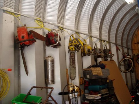

I have a bunch of saws left over from a time when I used chainsaws a LOT. My use ranged from commercial logger and firewood cutter to land clearing to just keeping the woodpile stocked. Current stable of saws: Mac 610 (2), a 1010 with a 710 'jug' (makes you wake up when you hit the go trigger), a 'stock' 1010, Stihl 011 that I bought new for Dad 35 years ago (now heirloom status- just sits in a case on a shelf), numerous 010/011/012 in various conditions (plus a pickup bed full of 010/011/012 parts), ECHO 310, 361, CS4600(x3), CS5000, and last but most often used these days Rigid 18V w/10" bar.
I discovered earlier this year that my second Cousin just a couple miles away is a self employed chainsaw repairman so I'm going to try to trade him the pickup load of parts in return for putting a couple of the little Stihl saws back in running condition. :unsure:
For a while antique saws were showing up here. Kind of funny, hang one up on the wall and people donate another.
Not shown is a 2 man military hydraulic chain saw someone gave me.
