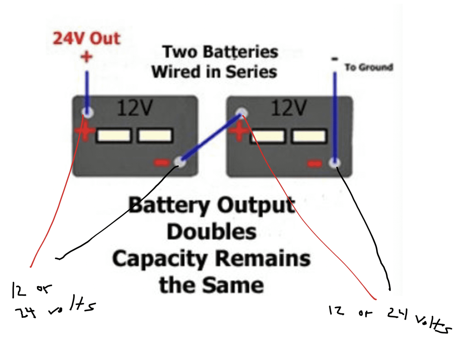

Ok, first off thanks for the responses on my last battery question thread. I think we've got that figured out. I do have a follow up question though and maybe this was kind of answered in the last thread but I'm too, let's say, uneducated on the subject to see it. Anyway, I made a little illustration to hopefully clarify my question.
If I have the two 12-volt batteries wired in series to make 24-volts can I wire a small 12-volt accessory to one of the two batteries and get 12-volts off it or will I blow up the 12-volt accessory with 24-volts? If I can get 12-volts off one of the batteries does it matter which one? Will the second battery in the series give me 24-volts and the first 12-volts or will both give me 12-volts. Check the attached illustration to hopefully get what I mean. Thanks again.

YES you can wire a 12 volt accessory to just one battery and get 12 volts.
Either battery will give only 12 volts, as long as you connect the the positive and negative terminals on THE SAME BATTERY.
The only issue you might run into is if you run down that one battery, your 24 volt system will also be affected.
In your diagram, the answer is 12 across EACH battery.

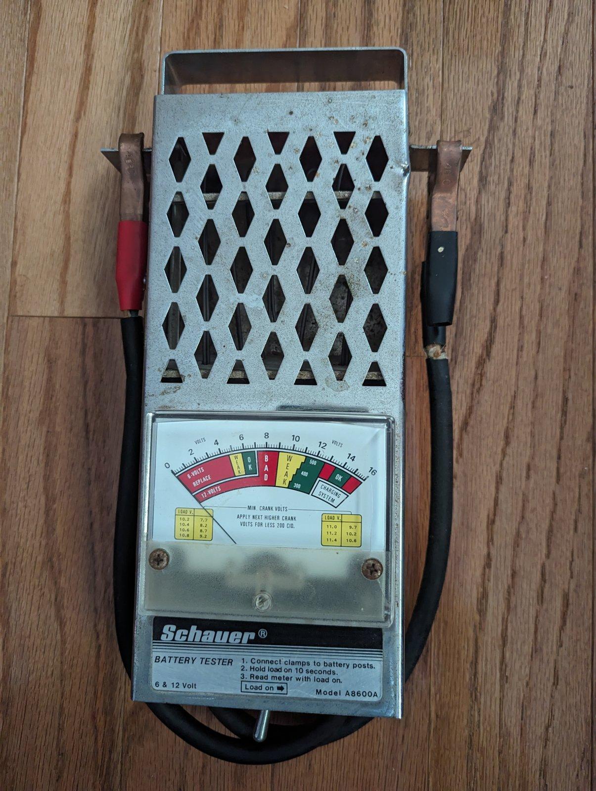

blume357 - If you have an accurate multi-meter - 12.5V is too low to load test a lead acid battery. If you use several 12V batteries, a simple 12V battery tester might be nice to have. I have had this one for 35 or so years and it has helped me several times. Nice visual indication...

Thanks Richard C... but what do you mean by 12.5 Volts is too low to test? Is that not what the batter is supposed to be when fully charged?

For the OP: Yes you can draw 12V form either battery. I prefer to use the first one in the series to prevent the OOPS of going from + to ground by mistake when hooking up the 12V connection.
Over the years, I've had numerous pieces of farm equipment that used 2x 6V to make 12V. 2X 12 volts hooked in parallel to make more cranking power. 2X 12 volt hooked in series for 24V starting.
I even worked out a system to use a 12V alternator to charge a system that used 24V for starting but ran on 12V during use(that one looked like an octopus with battery cable arms).
Yes, take from half of the 24V system and get 12V. Current is a different matter and is measured in series, not parallel. The 12V circuits in your diagram are parallel to the two 12V batteries wired in series to make 24V.
blume357 - Well good news on battery load testers! Ebay and Amazon have brand new 100 Amp analog testers for less than $30. These are probably Chinese built, but since they are simple testers - they should work fine. No batteries or electronics - uses the battery under test!
The reason I say 12.5V is low is that it should be a minimum of 12.6V after a rest. The voltage will be quite high (13.8 - 14.2 or so) right after a full charge, and then it will slowly drop to 12.6 after an hour or so.

The 100 Amp tester has that nice meter that will show you the start voltage and then how much it drops in 10 sec. The scale is calibrated in amp-hours so you can tell about what the remaining capacity of any battery is. I have had several batteries down thru the years that drop to zero V as soon as you switch the tester on. Some will have a cell that will boil and spit out of the filler cap.
