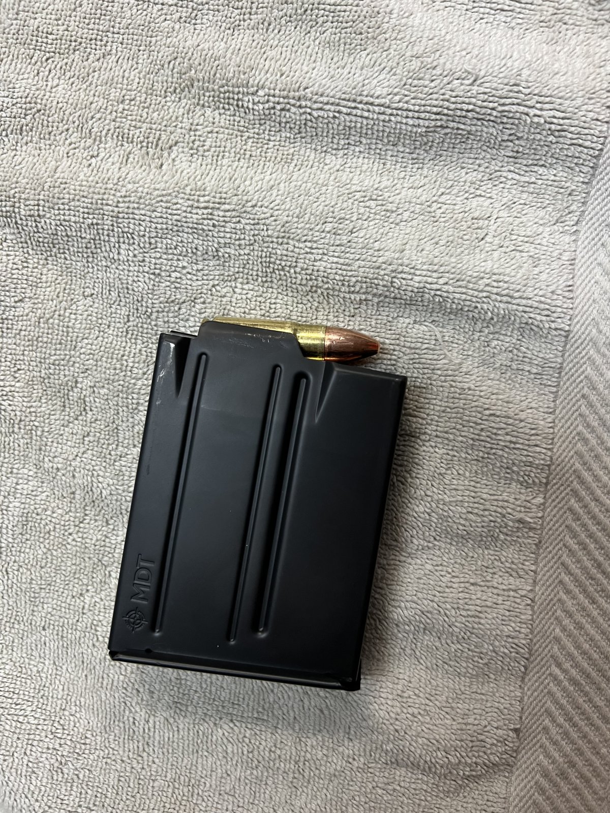

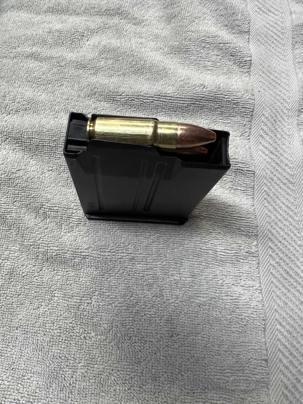

Well, after putting a 458 round in an AICS mag and a 6BR AICS mag (just has a spacer in the back) I will say that it fits the 6BR much better. The AICS feeder has a “ramp” on it and it catches the shoulder of the 458 and wouldn’t allow feeding out of the mag easy.
The 6BR you could half moon the front lip just a touch, and it should feed just fine. I’ll post the AICS first and then the 6BR
View attachment 15978 View attachment 15979 View attachment 15980 View attachment 15981 View attachment 15982
Will it cycle in the rifle?
View attachment 15978 View attachment 15979 View attachment 15980 View attachment 15981 View attachment 15982 Im having good results with the MDT AICS 300WSM/6.5PRC 3rd Mad the 7rd Mag
Im having good results with the MDT AICS 300WSM/6.5PRC 3rd Mags the 7rd Mag is having issues. the 3rd looks promising. Ill report back when i get to the range to test. For the 7rd Mag I was thinking of making a binder plate in the front of the mag and cut the follower but id have to find a smaller spring to fit in with the binder plate
