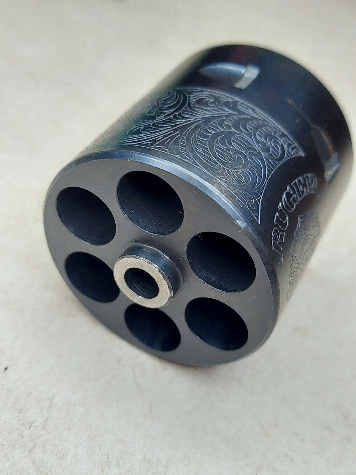

I have a NM Blackhawk that needs a 45 Colt cylinder, Can I use an OM cylinder to fit it. I've found a 44 Magnum cylinder that I want to bore out to 45, however, I don't know if it is a OM or NM cylinder. Will this work. The seller is unable to tell what edition the 44 mag cylinder is. Thanks for your help! Anyone has a 45 Colt cylinder for sale? Bought the gun with the ACP cylinder, guy had lost the Colt cylinder and at the time it was the ACP I was looking for.
    858.6 KB
I believe the OM 44 and 45 cylinder are recessed head chambered while the NM cylinders are not recessed. Fitment would depend on lengths of the cylinder and the cylinder window.
I also think some of the first NM revolvers came out with OM recessed head cylinders.
Someone who knows for certain will chime in soon.

Often times the difference is the gas ring in the front of the cylinders, New Models have a barrel "set back" deeper so the ring is LONGER on the new Models........as well as noted above the chamber recess............
Thanks you guys, the 44 Cylinder I was looking at I can now say was an OM. You just saved me so money. I contacted Ruger CS when I first purchased the pistol I called Ruger CS and they advised they weren't doing "cosmetic gunsmithing" at the moment. Ruger CS did verify that the 45 left the factory as a convertible, so that's good.

He IS correct in the fact that in the OM 45's,, there were fewer of those built than the OM .44 Ft handguns. Those OM 45's do enjoy a premium,, and especially those that are convertible or that were shipped with a grass g/f. THOSE need a letter to confirm their "as shipped" condition.
On your NM,, yes,, it sure does look like it likes the ACP cylinder. You do need to find a NM Colt cylinder to match.
You now know what to look for,, (the length of the cylinder boss,) but one thing not mentioned was to take your ACP cylinder,, measure the OAL. Buy a Colt cylinder the same length or a few thousands longer. You can then hone down the boss to fit yours if necessary.
Luckily,, the way those were built,, the timing of the cylinder isn't often (almost never) an issue.
Go on a hunt for a NM 45 Colt cylinder. Expect to pay $125-$150 for one.
