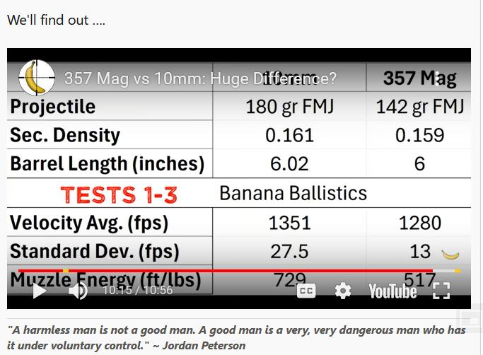

Thanks for pointing out where the video in this discussion was, so I went to the very first message in this thread and watched the video. I took a snapshot of the ballistics info he presented in his video for both calibers, and like I said earlier, this was a 'rigged' comparison. He used the max power 10mm (725 ft. lbs. of ME) and a mediocre .357 Mag (517 ft. lbs.). The .357 Mag goes all the way up to 907 ft. lbs. (a far cry from the ammo chosen in the test). In addition to that, he compared the 180 gr 10mm bullet to a 142 gr .357, but the norm for the .357 is 158 gr, and there are several 180 gr .357 bullets as well.
So, I contend that this was a setup to make the 10mm look as good as the .357 Mag. Also, notice the kick of the .357 - it is not very much. That is a clear indication the the round was not powerful. This is what is done in a typical caliber comparison, and not just between the 10 mm and the .357 Mag.
