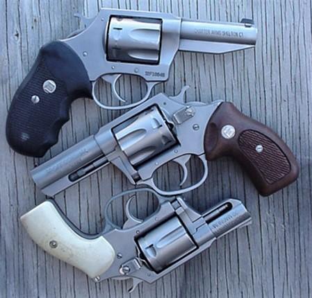

Models 032 and 632
Model 632-1
On the flip side of the coin these Charter Arms 32H&Rs can be packed around and beat to death,,,,,,,,,,,, and nobody cares.
