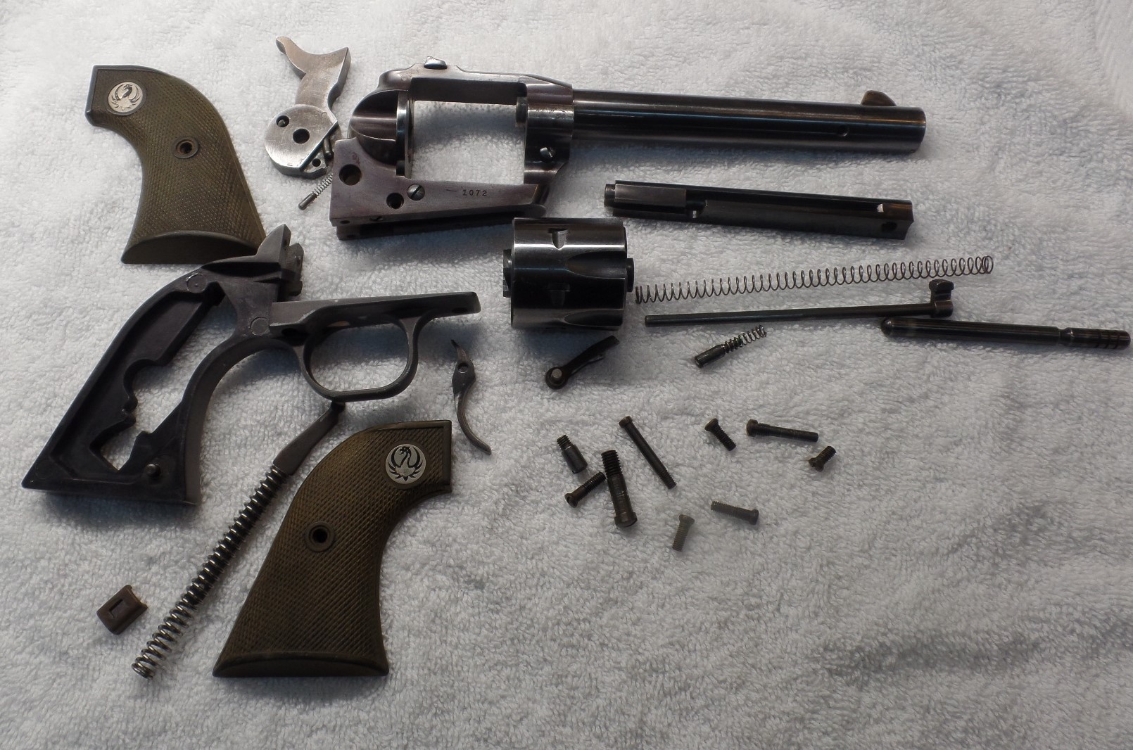

Just don't make the rookie mistake I made, taking the strut spring retainer off.......:rolleyes:
Note that the pawl spring on the back side of the frame should be installed with the little plunger into the frame first . . . not the spring.
I also note you didn't remove the bolt pivot screw thru the frame. That's not really a bad idea because getting that reassembled can be tricky, and you really don't need to remove the bolt for a good cleaning.;)
JAYDAWG, that's NOT a 3-screw (which is what the OP is asking about). It's a New Model and is VASTLY more difficult to assemble than a 3-screw. Don't want to confuse the OP.
Just sayin'........... upon CLOSER examination, I stand corrected and BLIND. It's a 3-screw
J>
Just sayin'
J>
Well, in your defense, I did take the pic before I took out the 3rd screw that holds in the cylinder indexing bar/latch(?), and the flat gate..........
