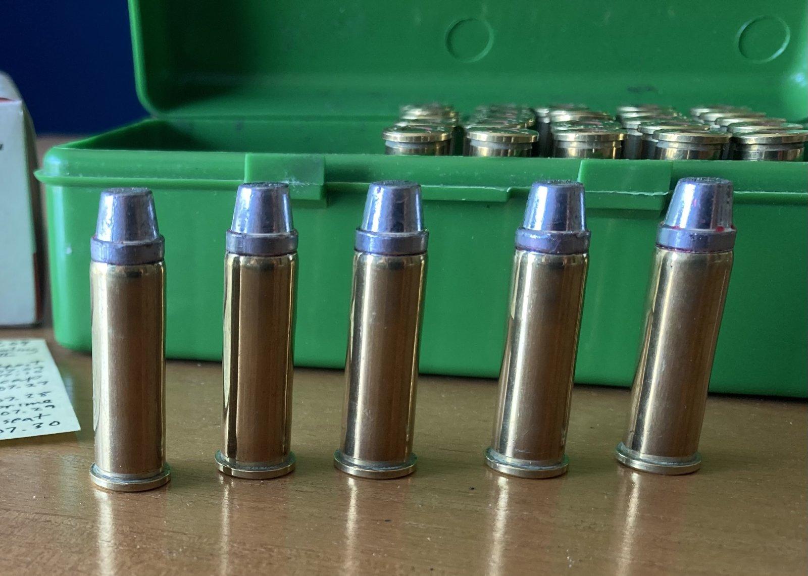

You will eventually recoup your initial costs, which will be higher than you think. Besides $ saved by reloading, an even bigger advantage is creating loads that suit you, not the factory.
Case in point: I shoot mid range .357 and .44 mag., maybe 1,000-1,100 FPS. Not magnums but more than normal factory 44/38 Specials. I load up the 44 Specials, but not near to 44 magnum velocities. They suit me. 32 magnum? I hot rod that SOB! LOL
For years I hunted with a Ruger .243. I liked 100 gr. Nosler Partitions. Good luck finding them loaded semi hot in factory offerings. I have the components, I decide what to load.
Mine has paid for itself hundreds of times since '76/'77, and I still use an RCBS single stage press.
I don't look at it this way, but many do so I'll say it first:
Reloading won't save you $, but you will be able to shoot twice (I'll say 4x) as much for the same cost :)
Life is short, buy the reloading components!

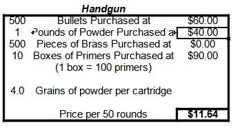

If you don't cast, 3.5c powder + 10c primer + 10c cast bullet + cost of metallic case. I feel .38 Special is one of the most economical rounds to reload given it costs 2.5x as 9mm with the same component costs.
If you cast, bullet cost is about half. .38 Special cases are on the order of 6-10c/per used and effectively last forever.

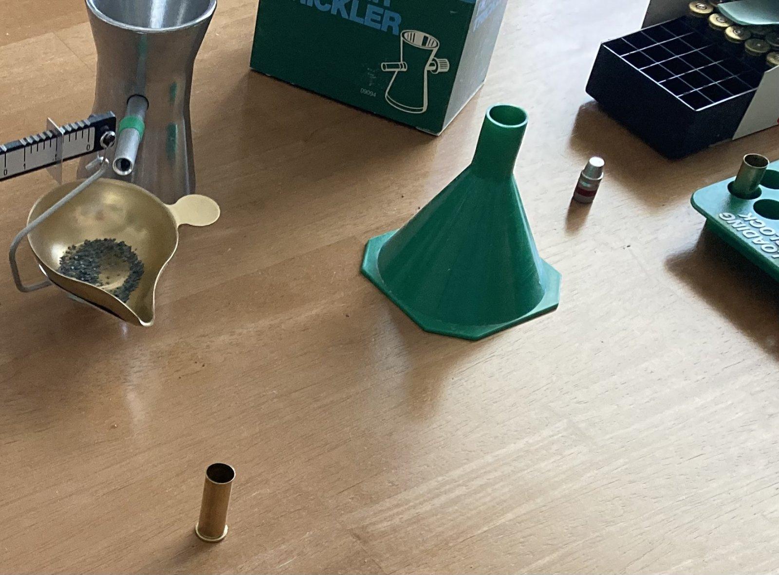

Everyone will have their own priorities, and therefore their own approach to reloading. It is indeed possible to save money by loading your own ammo - that is precisely why I got started. Back in the 1980s, I figured out that I could buy new .45 Colt brass, commercial lead bullets, propellant and primers, and even if I only used the brass once, it still cost less than buying factory .45 Colt ammo at that time (and obviously I reused the brass).
I didn't know anyone who reloaded, so I read the Speer reloading manual and taught myself. Because I wasn't sure if I would like reloading, I started with a small investment in equipment: a Lee hand press, a Lee powder "dipper" set, Lee .45 Colt dies (which also included loading data for use with the dippers), and a Lee Auto Prime hand priming tool. And that approach worked for me, for years - I still use the dippers when I'm doing trial loads, and on occasion mount my old hand press upside-down in a bench vise for seating plain-base gas checks!
You can still save money reloading .38 Special, but it depends on your priorities. Jacketed bullets cost more than cast, but some folks prefer jacketed; new brass costs more than range brass, but some folks prefer new. I personally prefer to keep my costs down, so I use a lot of cast bullets and range brass. At the last gun show I attended, one vendor had .38 range brass for $5 per hundred (and dropped his price to $4 on Sunday). I've purchased cast bullets for as little as a penny or two a piece, but buying coated cast bullets from a manufacturer may provide a more consistent supply (& less time cleaning ;^). Primers & propellant are still pricey, but I've had good luck buying both from private sellers (YMMV).
As others have mentioned, buying used reloading equipment can also save you money. I recently added a second Lee turret press (with several extra turrets and some other equipment) for just $40 plus shipping, purchased on GunBroker. There's nothing wrong with buying new Dillon equipment, it all depends on your priorities!

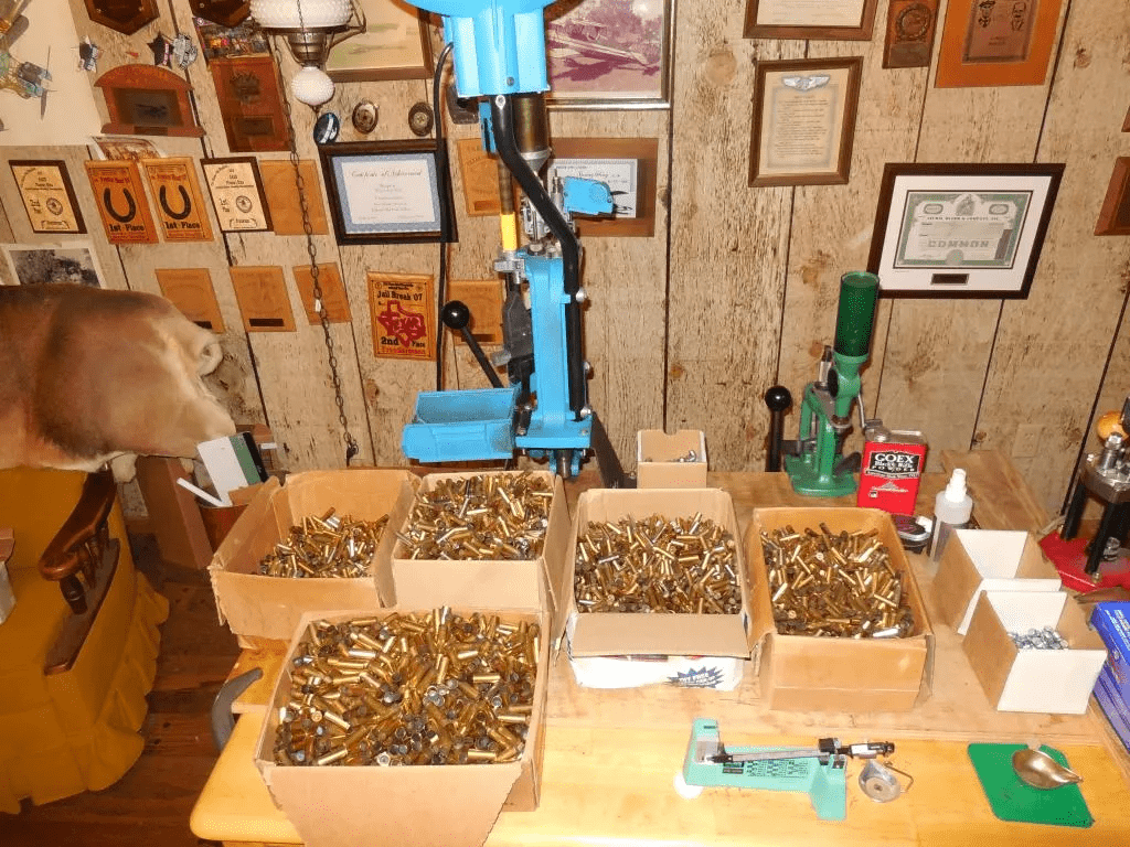

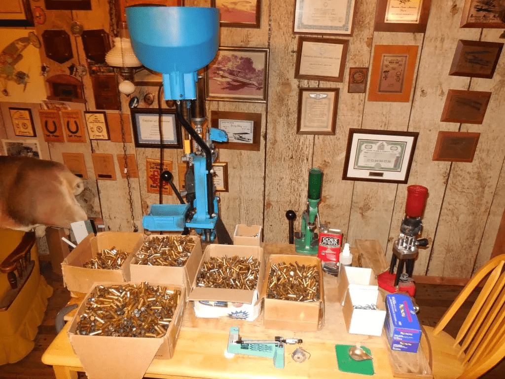

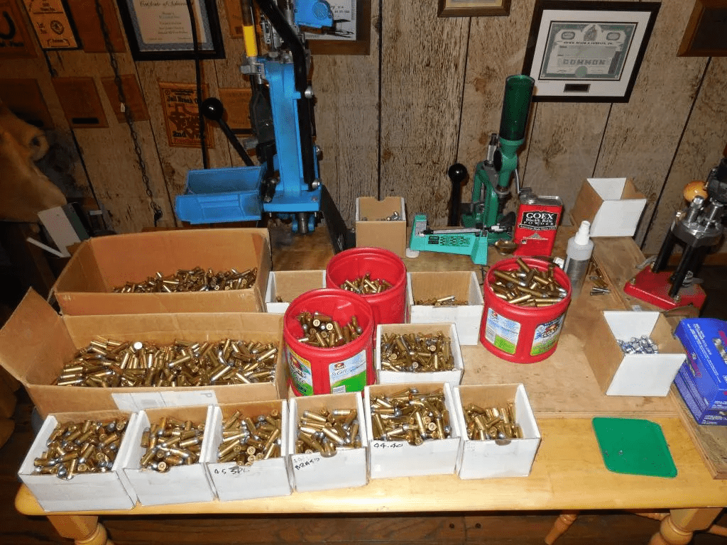

I will not discourage purchasing a Dillon progressive press, because I purchased a 550 as my first handgun/rifle press. 6 months later I bought a second 550, one for large primers and one for small primers. Just change tool heads, load primers and powder and start cranking out ammo.
Purchasing a 550 allows use of non-Dillon branded, proprietary dies. Also a 550 can be used to load most rifle cartridges.
You can even buy gadgets online that allow you to use a 550 as a single stage.
As others have said, there are lots of good reasons to reload. I loaded my wife some "bunny fart" rounds for her to shoot in her S&W alloy J frame. When I was dabbling in IDPA I loaded my own 9mm with 147 grain bullets and dash of Titegroup just strong enough to cycle the guns I was shooting.
I have a good stock of $35/1000 primers and powder purchased at $20 or less per pound I am saving for retirement.
Buy a Dillon 550 and don't look back.
You can always pick up a single stage for odd jobs, e.g. decapping scavenged 223 brass and such.
Don't forget to factor in all the peripherals, brass cleaning system and media, check weight scale, calipers, powder measuring system (if going with a single stage).
