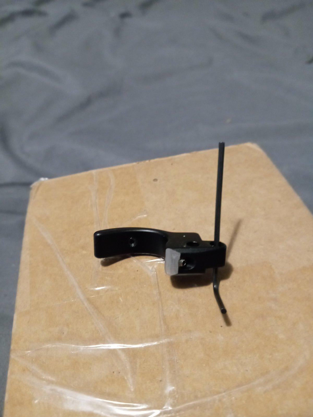

Mk2 pistol. Had to bevel trigger. I believe my frame is out of spec. Thanks to all.
    106.5 KB

Fox Mike, I already had an adjustable trigger (Ruger factory with added set screws). I guess with the tighter tolerance Volks trigger, and my frame, there was no room for function.
