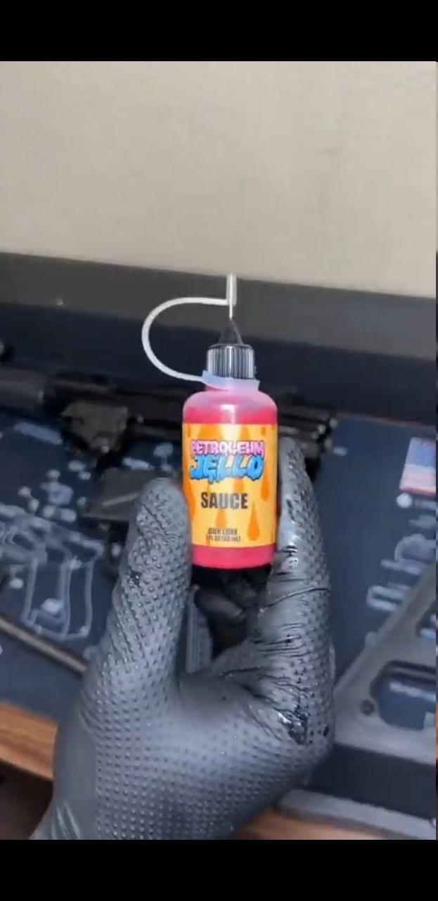

came across this video and haven't actually used the lubricant either so don't know how well it works but i feel the lubrication oil was way too much. Errrrrrrrrrrrrrr
It sure looks like too much but really can't say. I no nothing about that Lube nor requirements on that gun.
I will say with years of experience on police ranges, mainly handguns but rifles, shotguns also. Most over lube, a few do it right and some won't lube when it's needed. The some who won't seem to be too busy to maintain anything.
That thick lube in the video doesn't look like it would seep into the crevices to lubricate shafts and pins, but probably just perfect for the slide.

I looked at their website. They are going after some sort of marketing thing. To be honest, I'm not really sure what they are going after. They are selling "sauce". Their word for gun lubricant. And lots of stickers etc. But they have a cinnamon scented lubricant. Why???
There is a certain generation they are marketing to and it ain't us.
