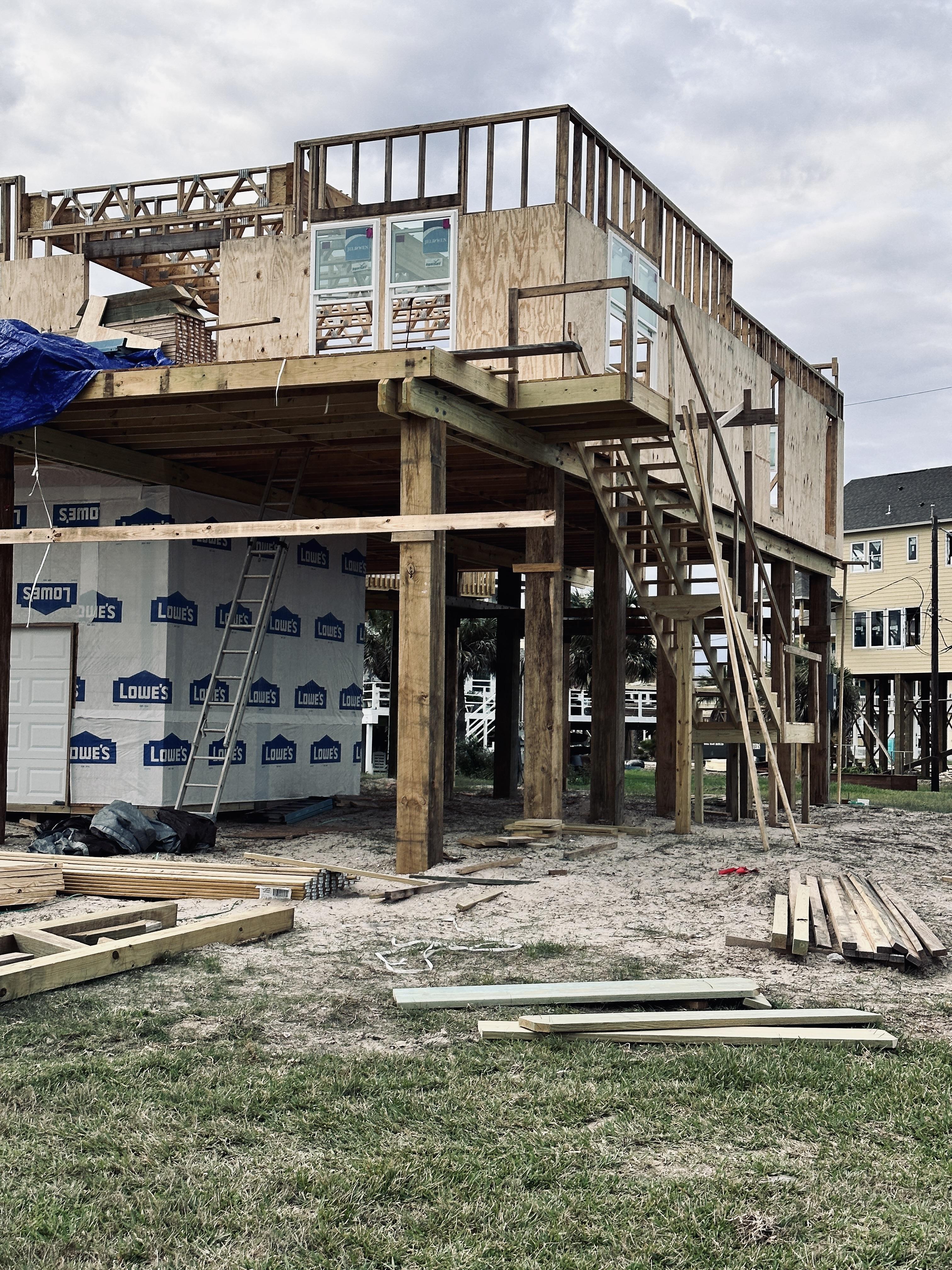

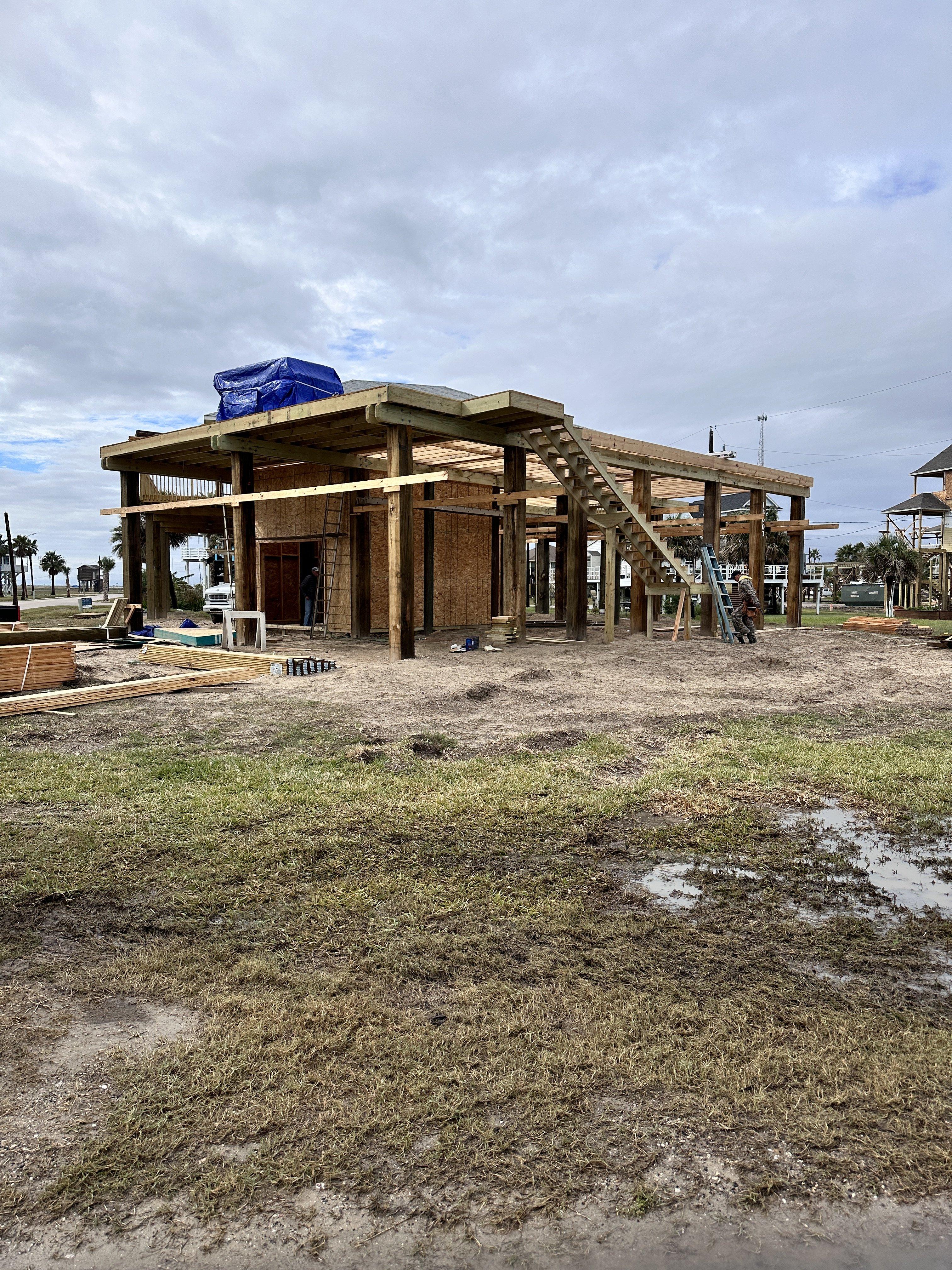

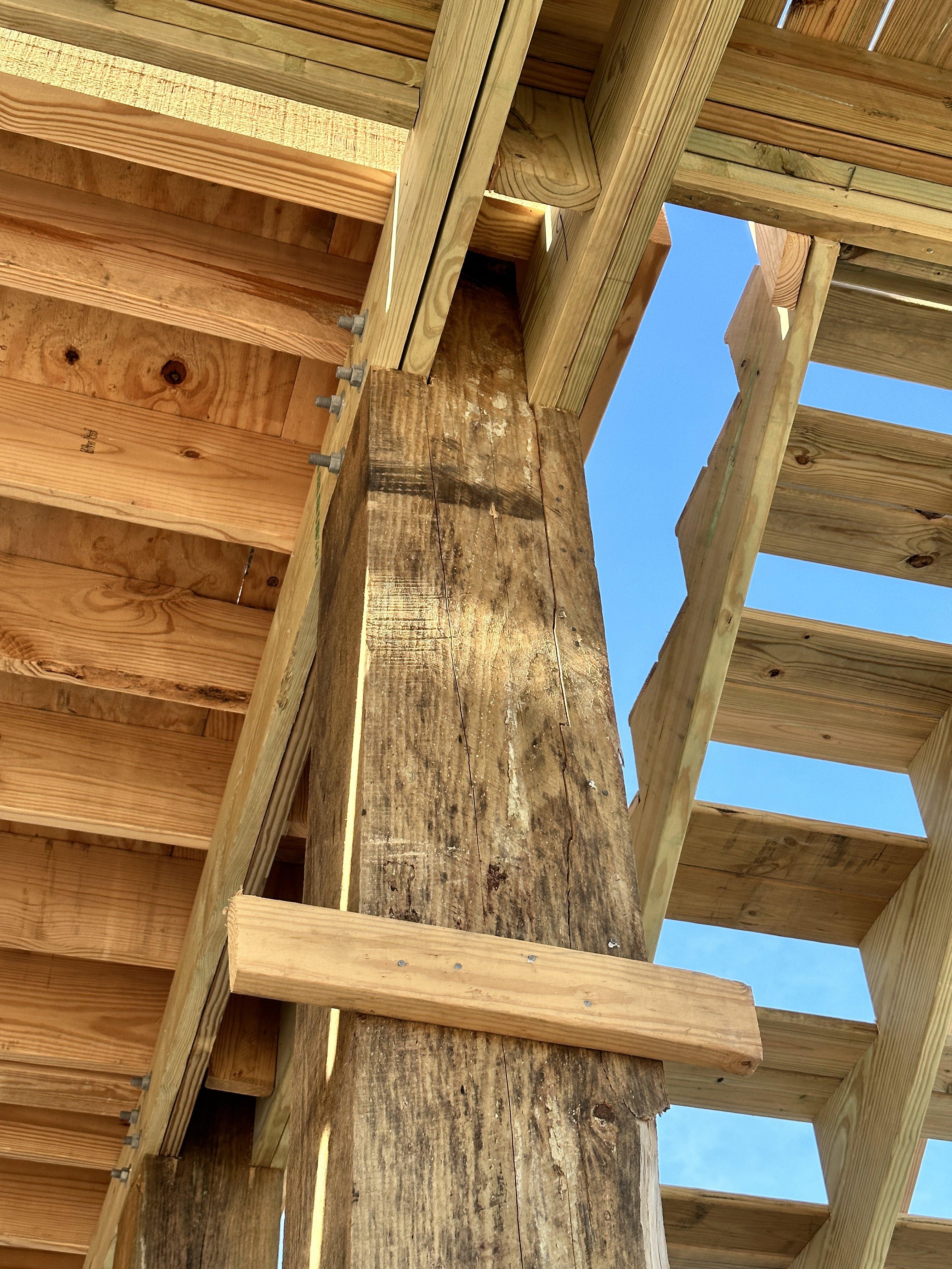

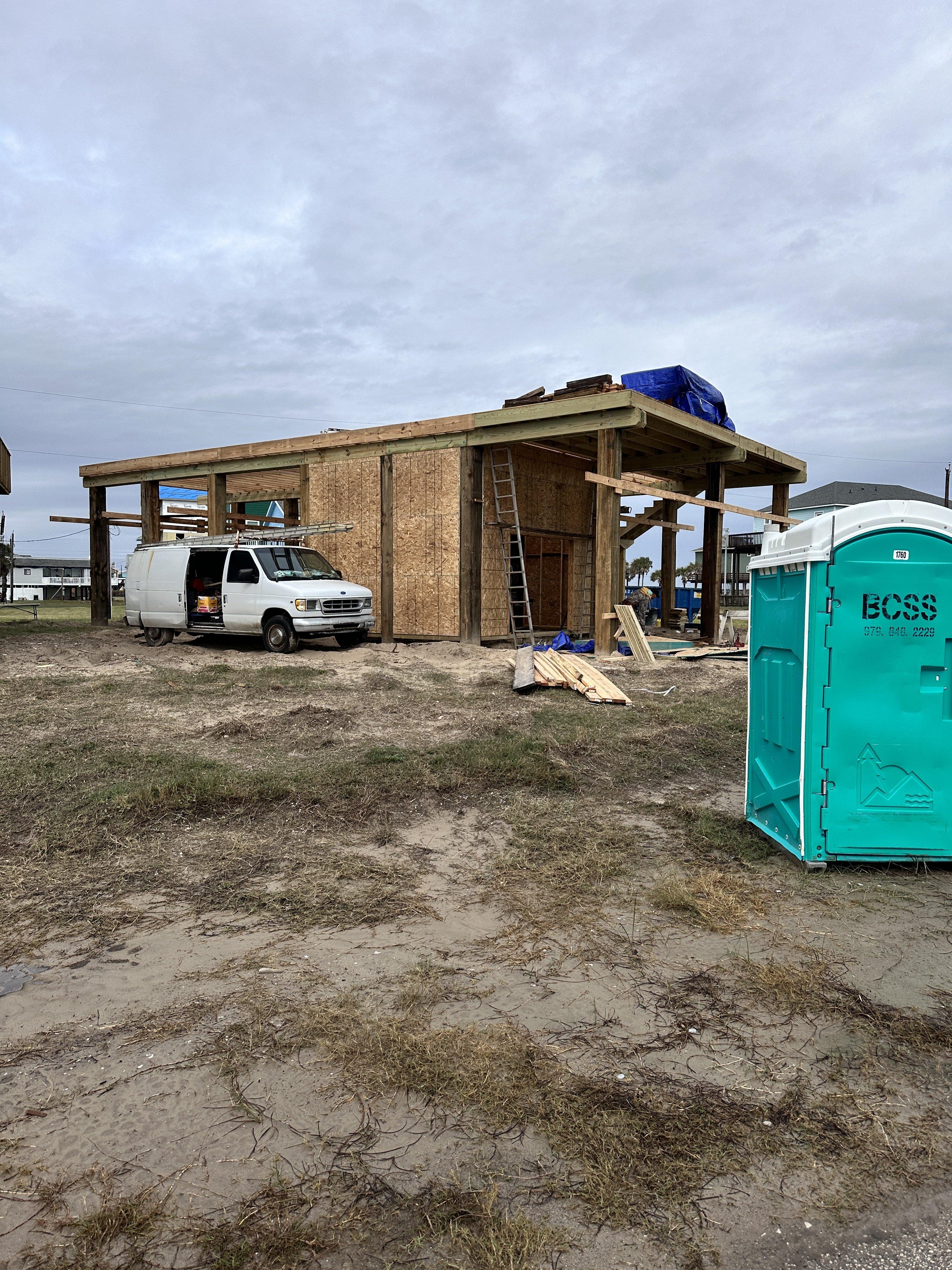

The house sits on a corner lot. The pilings go down 18 feet. They use this truck sized jack hammer to beat them into the sand.
Its just sand. This is on Follet's Island. Wikipedia says the highest point on the island is 3 1/2 feet. But I think it's a little bit more than that, perhaps 7 or 8 feet.

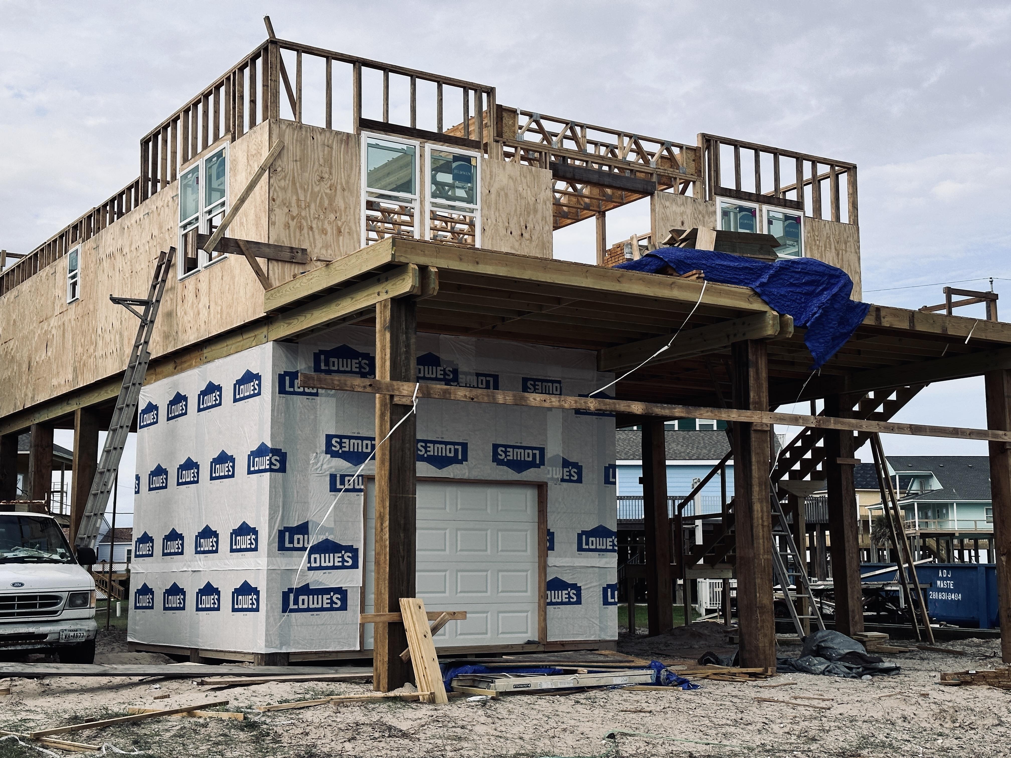

Here is the garage. It can only be something like 300 sq. ft. The walls are breakway and NOT attached to the vertical pilings.

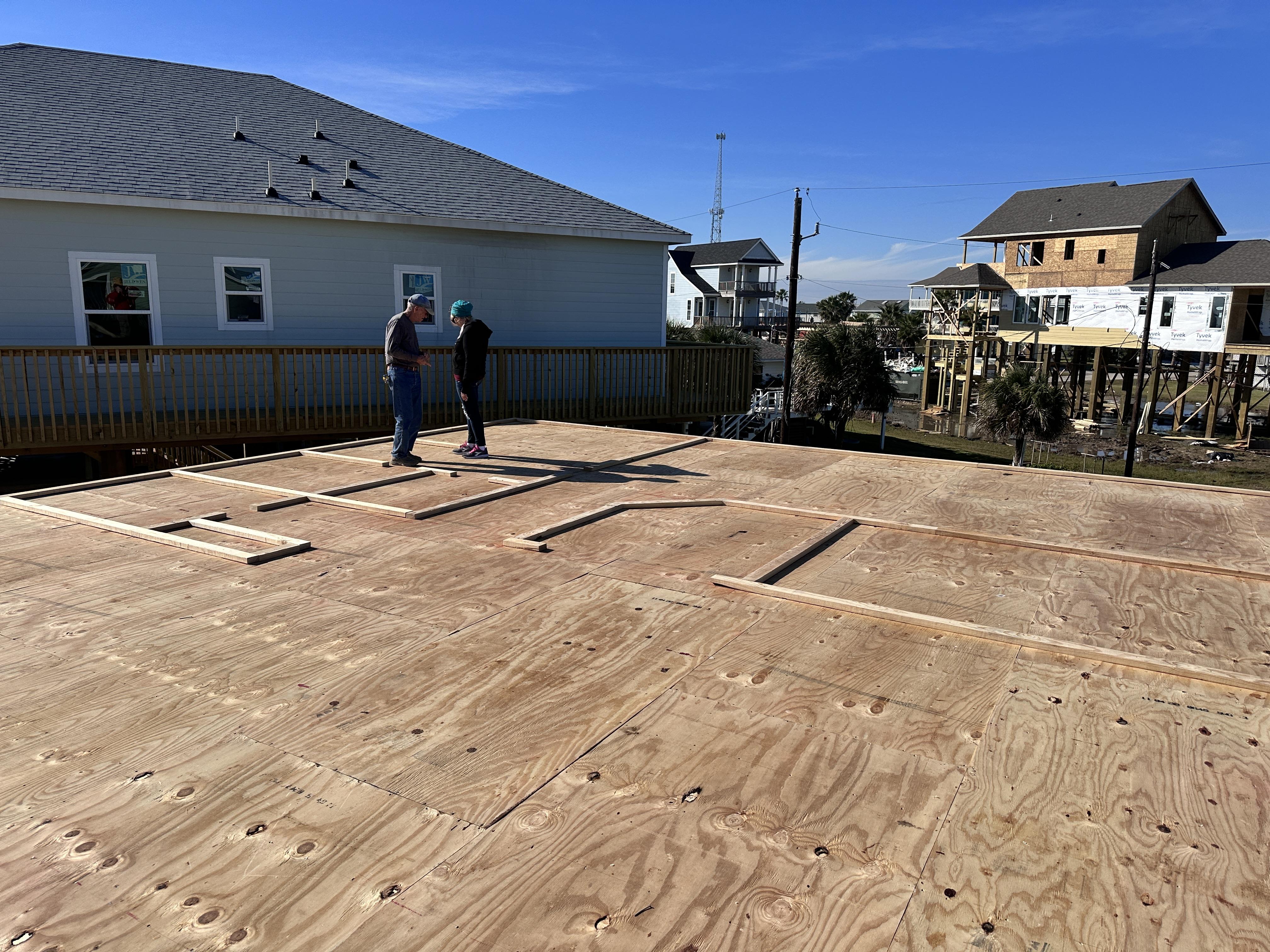

Here's my wife and the contractor. He laid out the master...excuse me "primary" bedroom and bath so she could visualize what it's going to look like.
They are standing in the bathroom, and the Primary bedroom is along that back wall.

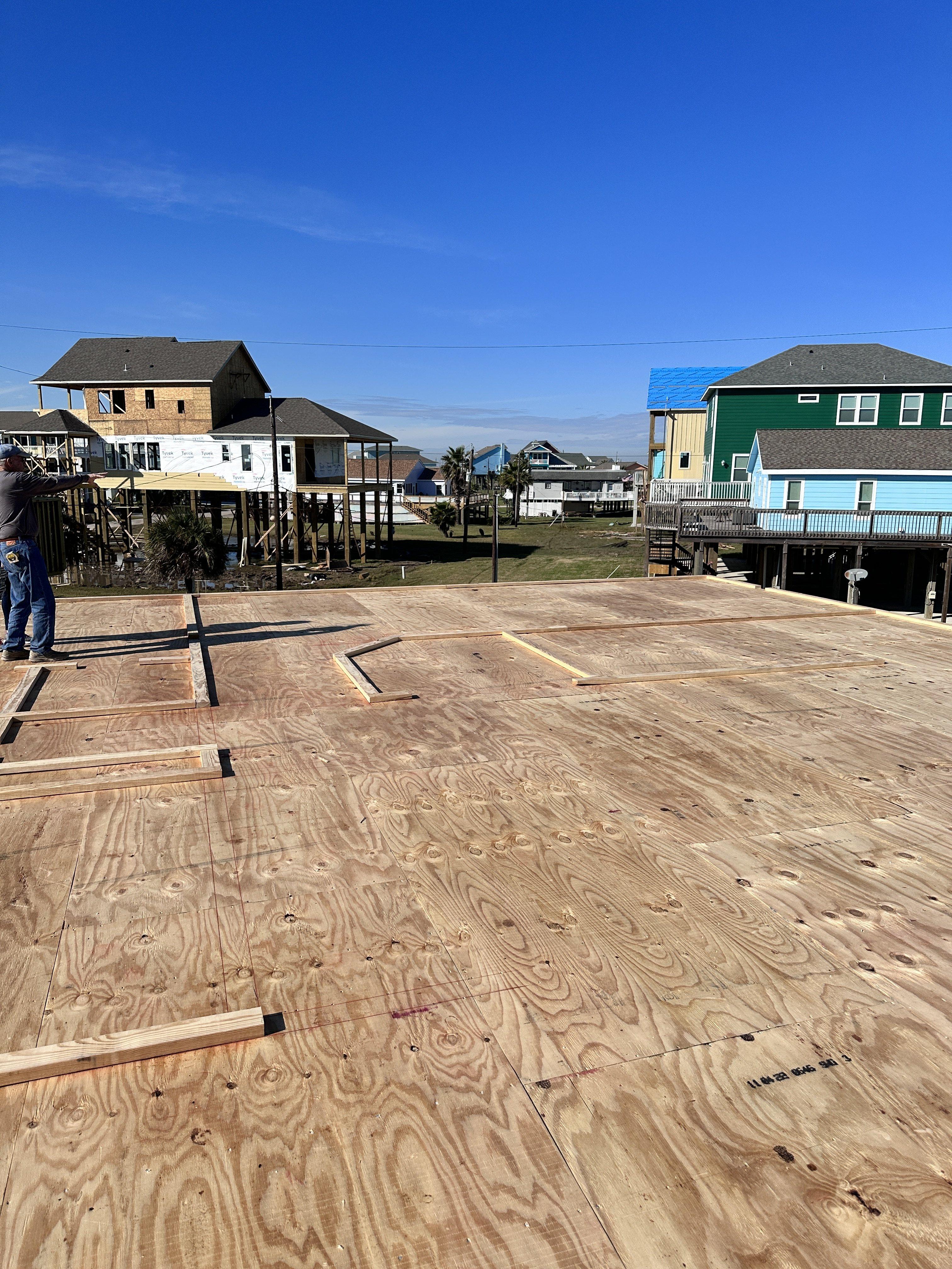

In our neighborhood, there have been 30 houses built in the last 2 years. And every time I drive to Galveston, There are a constant 6 to 8 houses under construction.
That little area with the mitered corner is going to be a pantry off the kitchen. The long skinny room to the side is the laundry.
Then there is going to be a side deck 20x20 off the laundry room. It's going to have the same view as the picture above since it's
on that side.

Very nice. So all the mechanical stuff has to be up on the main floor? Furnace, Ac, all that? Does the power and water lines, etc. go up inside the garage to keep them out of sight? Not familiar with oceanside homes at all, so these are likely dumb questions. Are you worried at all about rising seas?

All the HVAC is on the first floor. There will be some vertical PVC pipes attached to one of the rear pilings. I'm not sure why they aren't inside the garage to be out of sight. One up for water, and one down for drainage into the septic tank. Everyone has a septic tank here. And there are no buried cables. Also in the plans is an outdoor shower. So there will be a hot and cold water line coming from the first floor down to the outdoor shower.

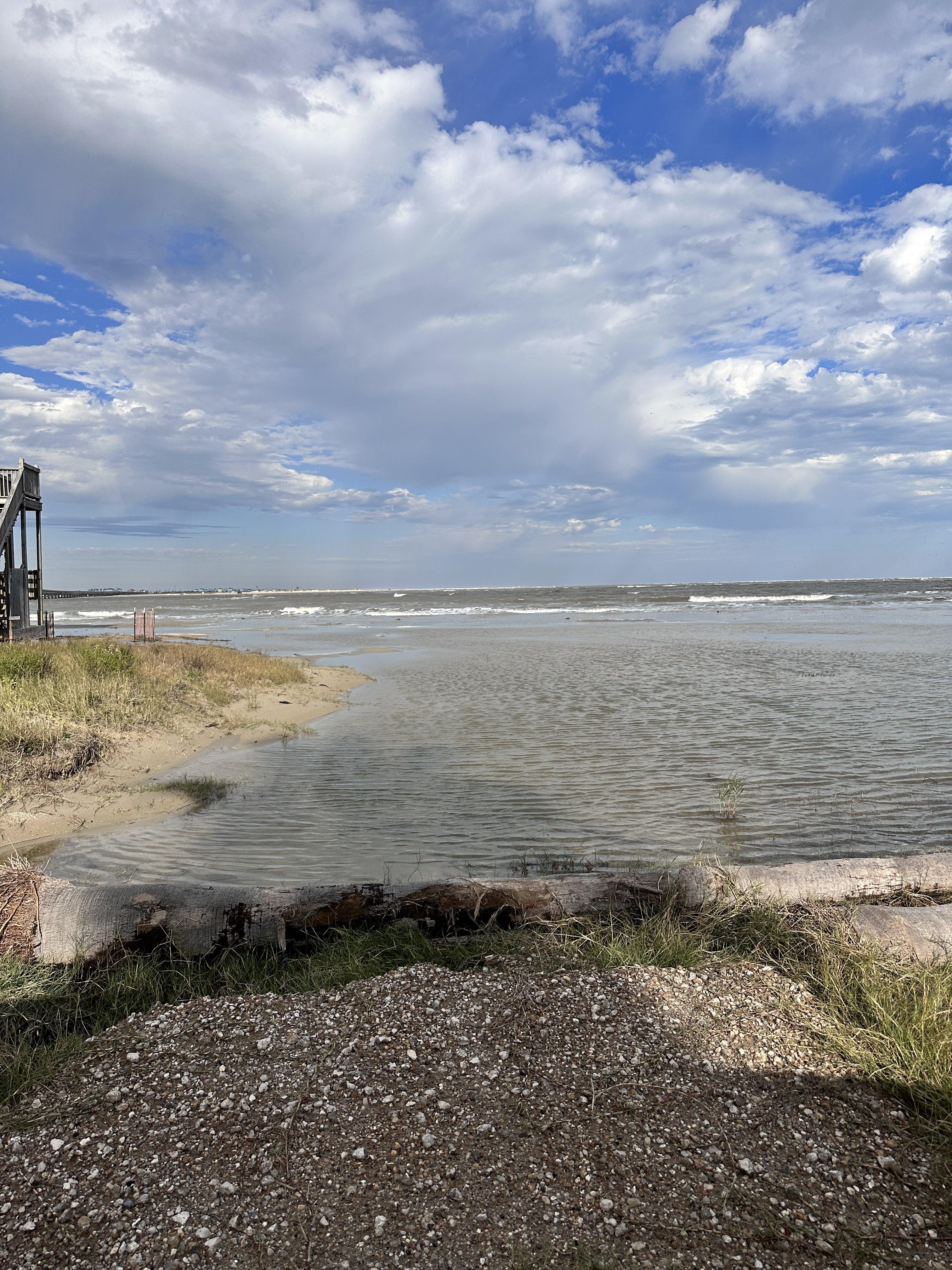

Rising water? Yes, it's a big concern. Here is another picture. There is actually a buildable lot under this water...mine. The asphalt you see in the foreground was my driveway where the house was going to go. This was actually the first lot we bought back in 2020 for the house we are currently building. The state is supposed to put in a revetment wall on the beach to stop beach erosion.
In the fall of 2021, the named storm Hurricane Nicholas washed away the driveway and took a whole bunch of sand with it. Our lot is part of the grass there on the left, next to the neighbor's house. We're going to keep it to see if the state actually builds the revetment wall.
but way too close to the neighbors for my taste.
Ride1949: that is something I can agree on with you. Fortunately the house is on a corner lot, and it sits at an angle, so there aren’t neighbors right beside the house.

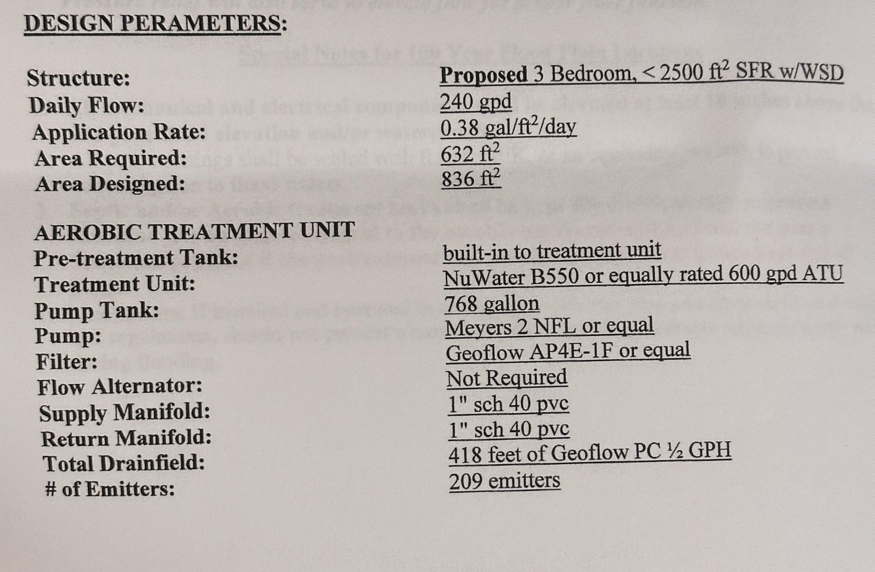

I am curious as to the type of septic system you will use. We went from a conventional to an aerobic system 5 years ago.
Mike:
That’s awesome where you live. My wife and I really like the area a lot. We went over to the Brazilian National Wildlife Refuge, those alligators are right up in your face!
Jim: Don’t quote me, and I should know what type of septic system it is. But I believe it’s the aerobic system. Those have the pump right? With the three tank system that pumps from one tank over to the next etc. Yes? That what this one is at least.

Not quite
An aerobic and low dosing systems both use a tank with 3 chambers for aerobic they are Trash, Aeration and Pump and both use pumps to discharge the cleaned/treated black/gray water. The aerobic system uses bleach/chlorine to treat the water before pumping it to the surface. This system needs to be inspected every 3 months and cost around $300 per year for the service. This is an engineered system and is registered with the County and MUST be inspected quarterly. This system can be flooded by over use which allows to much water for the amount of chlorine treating. Which is about the same as pumping raw sewage to the surface.
The low dosing anaerobic system pumps the waste black/gray water through perforated underground pipe into the gravel leach bed same as a conventional system. This system can be flooded by over use or a lot of surface water leaching into it. May not be a problem in sand.
The waste flows from the chambers by gravity the pump is used to discharge into the field or surface spray heads.

Thanks for the info Jim. I’ll have to ask. I do know we had to get a county permit, which was around $1,000 I think. It was a while ago. Then in the contract it does have to be inspected. I remember that thinking it was strange it had to be inspected so often. I thought it was just a way for the septic guy to make money.
This morning, I’ll go dig through all the paperwork and see.
You are correct about the drain field. I know there was a big deal about the drainage NOT being on the seaward side of the house. So the builder had to redesign the layout. It wasn’t a big deal, but the permit had to be resubmitted. Luckily Brazoria County is small.

I just looked at the permit. It is an aerobic system. Have you been happy with yours? Any problems or issues?
Here is the specs:

We have had our system for 5-6 years and I'm very happy with it.
Other than the inspections $ the only thing that I have had to replace is the air pump twice. They have to run 24/7 but they are only about $100 to replace yourself which is easy.
As far as using a disposal we have been using one with both our old conventional system, which only needed pumped twice in 37 years, and for the last 5 years in the aerobic with very little build up in the trash tank. We try to put VERY LITTLE food waste/grease down the sink or in the dishwasher and if you didn't EAT IT except TP it doesn't go in the toilet.
Your system's tank is very similar to ours. The main difference is our discharge is pumped to 5 surface spray heads and yours will be discharged to a underground drip field.
Hope this helps and happy crapping:)

This deck needs only 3 pilings. But the problem is, it takes a great big truck sized jackhammer to set the pilings. And nobody will come out for such a small job.
We just have to wait until someone starts another house and then “borrow” their equipment for the 3 pilings.
If I was building on the water I would want 4' concrete pilings to bedrock, precast concrete exterior and a steel roof with blastgates on the windows. I'll settle for water near. About 80' above swamp level with 3 boat ramps within 20 minutes.
