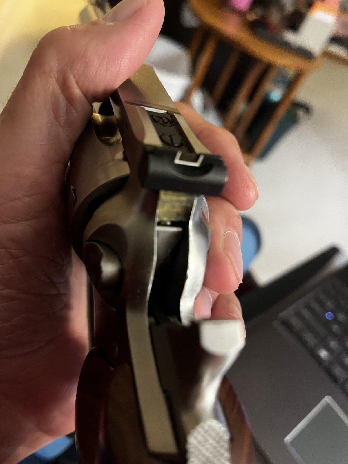

I'm one who likes to dry-fire also. My recommendation is to find some plastic/rubber material that is maybe around 3/8 inch thick and cut a square of it that will fit in the hammer channel right above the firing pin. This will prevent the hammer and transfer bar from even touching the firing pin, and it also softens the blow of the hammer, try it and you can tell just by the sound. Picture below is a sample of this approach in my GP100.
Thanks for coment
I do use the hammer to activate my laser (combination bore sight and single burst) so not sure if your method would stop the burst but have ordered wall board fasteners that hopefully will accomplish the objective.

I think wproct has hit the nail on the head. Snap caps or a version of are to protect the firing pin & possibly the rear of the cyl.. While a good thing to use, they wouldn't really seem to help the hammer. The top face of the hammer slapping the rear of the frame is where the shock & stress is on the hammer.
