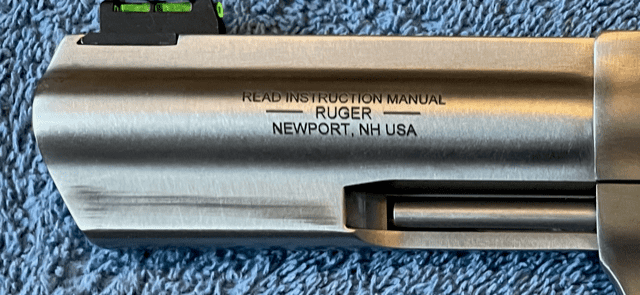

I just noticed this mark/scratch on my GP100. Never been fired and it’s the only mark on it. It looks black but the lines actually look shiny like it’s been polished, almost mirror like. I was unable to get that to show in the picture.
What’s the best way to remove or repair this? I read somewhere to use a scotch pad but I’m nervous to try it, lol
0000 steel wool and gun oil.
Don't use steel wool on a stainless steel firearm unless it is stainless steel wool. Standard steel wool will leave minute amounts of material that will rust if it is not completely removed. Using Scotch Brite pads to polish stainless steel is really the way to go.
Scotchbrite pad should work..... if the original scratches are deep, you may need to find coarser grit of Scotch pads to start....but ending up with a finer grit and going "with the grain" should work well.....

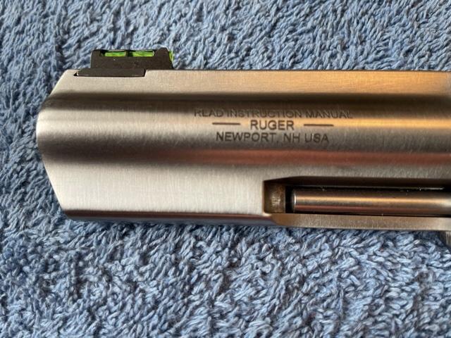

Yes, you did very well! Like Acorn said, that's the beauty of stainless steel, specially the brushed finish that Ruger puts on the GP100. Makes them very easy to touch up any abrasions or scratches, just like you did. You are gonna really enjoy that GP100!
You did good!
