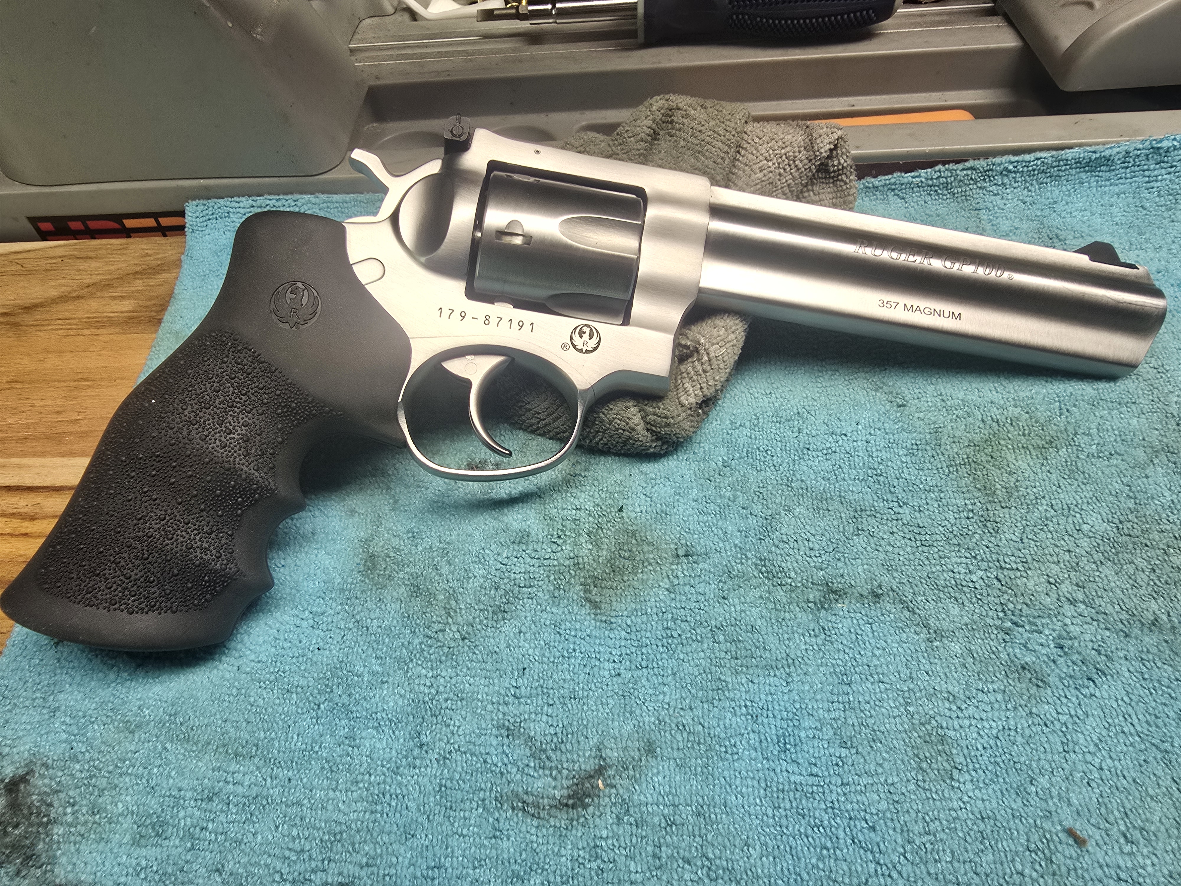

Just added a GP100 357 6inch barrel,great gun.
Sorry to say i had to send it back to Ruger for some minor issues.
The rear sight was so far off i had to move it all the way to the right to get it on target,but did shoot 6 shot one ragged hole at 7 yards with 357. At 15 yards held a good 3inch group
Front sight was also off center to the right side .078
Had some cylinder lock up issues but that seemed to be getting better.
Ruger will make it right they have alwas come threw for me.

Sorry front sight off .078 to left sorry had gun facing me,and this is as far as i have to move the rear to get it on bullseye at 7 yards.No worry's Ruger will take care of it.And after 100 rounds the cylinder is still locking up looks like the shells are way to loose in the cylinder they move out untill they hit the frame that could be the cause of cylinder locking up.

Ruger will make it right they have alwas come threw for me.View attachment 105379View attachment 105380

Im running factory loads 110 gr 158gr 138gr,ive never had a revolver do what this one does if you tilt the muzzle up the rounds come out of the cylinder”s so when your shooting there coming out of the cylinder and press up against the frame i think the cylinders are over board but I'm no gunsmith just saying it doesn't look right to me.
So if I understand you correctly the case heads are against the recoil shield/frame and stopping the rotation of the cylinder? It's normal for the cases to make contact with the recoil shield so something else is going on IMO. Are your chambers getting fouled and cases sticking or not fully seating? Is the cylinder difficult to open when this problem occurs? Is it clean under the ejector star? I'm not a gunsmith either. Just trying to understand the issue in case it's something simple. Hope you don't mind. Oh, new Rugers are known to sometimes have machining burrs that can cause problems too.
The front sight is not adjustable by drifting. It's on a spring loaded, push button retainer. It makes changing front sights a breeze but all adjustment is done with the rear sight.
Good call, I forgot about that. Now I’m even more curious how the sight could be off center?
It appears sights being off center is a common issue per Ruger,my sight sits .078 further to the left if you look at the sight from above its really obvious.I've seen other posts where this is an issue. Like i said not worried Ruger will make it right.
So when you load the gun all is flush now point the pistol in an upward position and the shells slide back out of the cylinder and ride agains the back of the frame,some people say its normal i tried it on 3 other revolvers they don't do it like i say I'm far from being a gunsmith just seems odd to me.
Okay, now I'm convinced that this gun has definitely got to go back to the mother ship. After reading along it sounds like it has excessive clearance between the cylinder and recoil shield and the barrel was torqued into the frame off center. Let the factory have a second crack at it and keep us posted.
