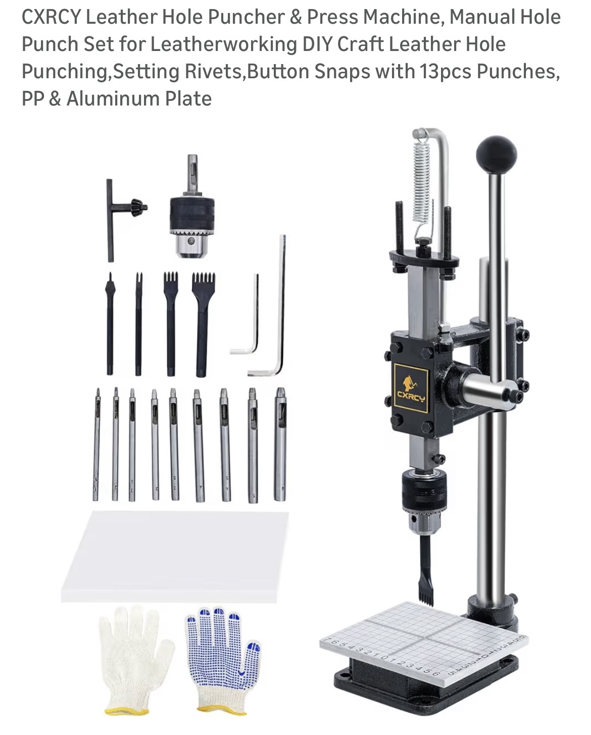

I recently bought a press for leather work. It came with punches and stuff. It wasn’t expensive.
I use it to set rivets and snaps on holsters and sheaths. Also to put bachelor buttons on my jeans for suspenders. You can use a hammer, but a slow steady push is better than a sharp blow.
It would work well in this application too.
