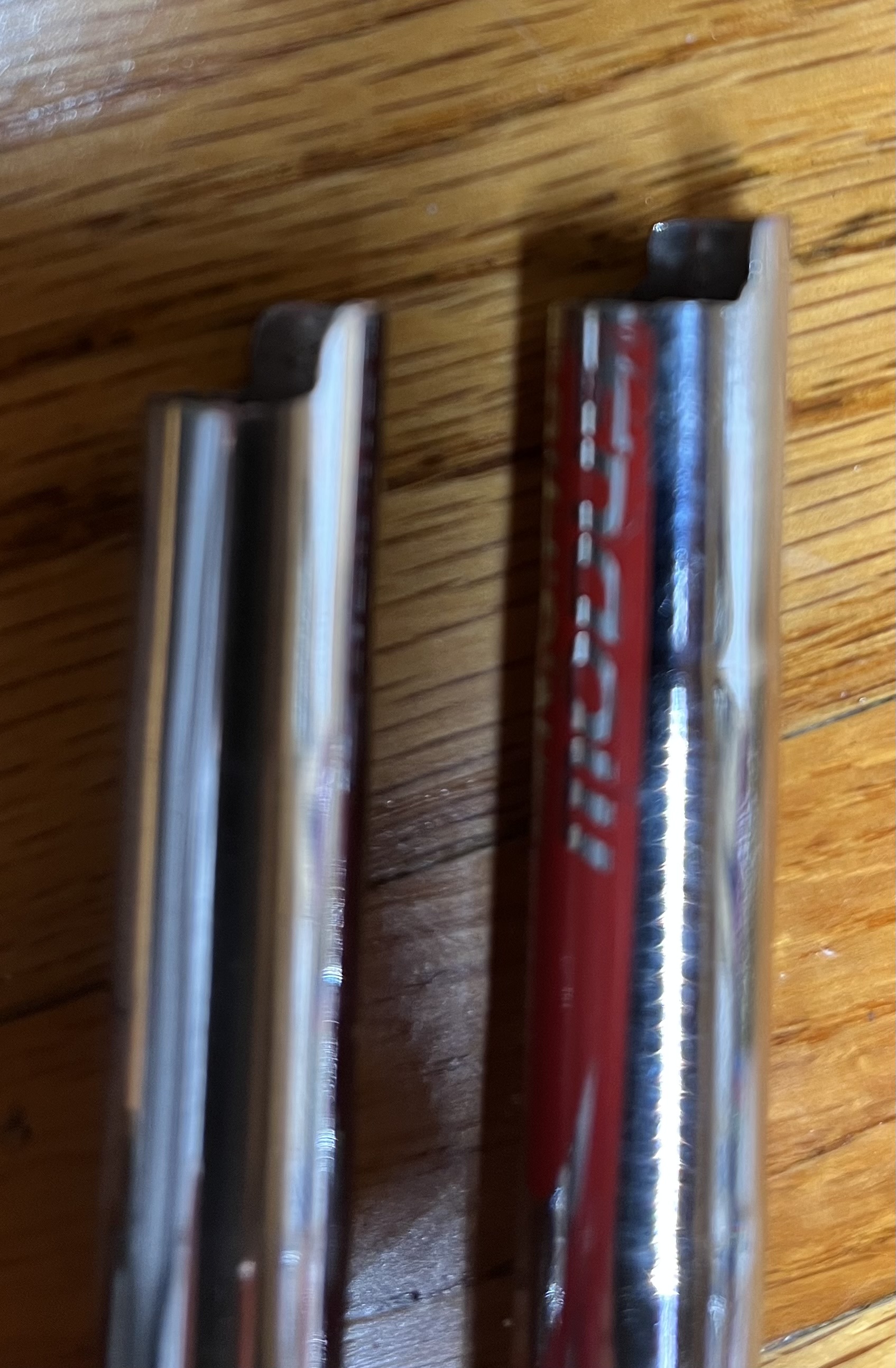

I made my own. The removing tool is simply a metal, broken golf club shaft. I shorten the grips a little and determine where to cut the end so the empty cartridges fit. I just used a small Dremel tool to make the slot. Have made several of them for others.

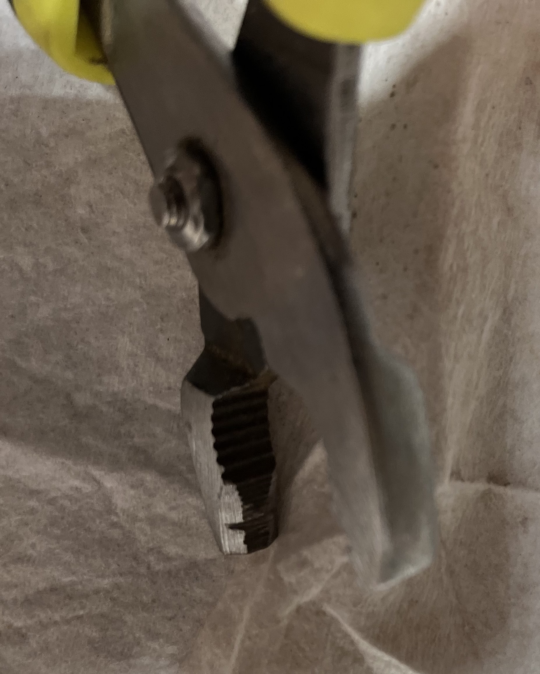

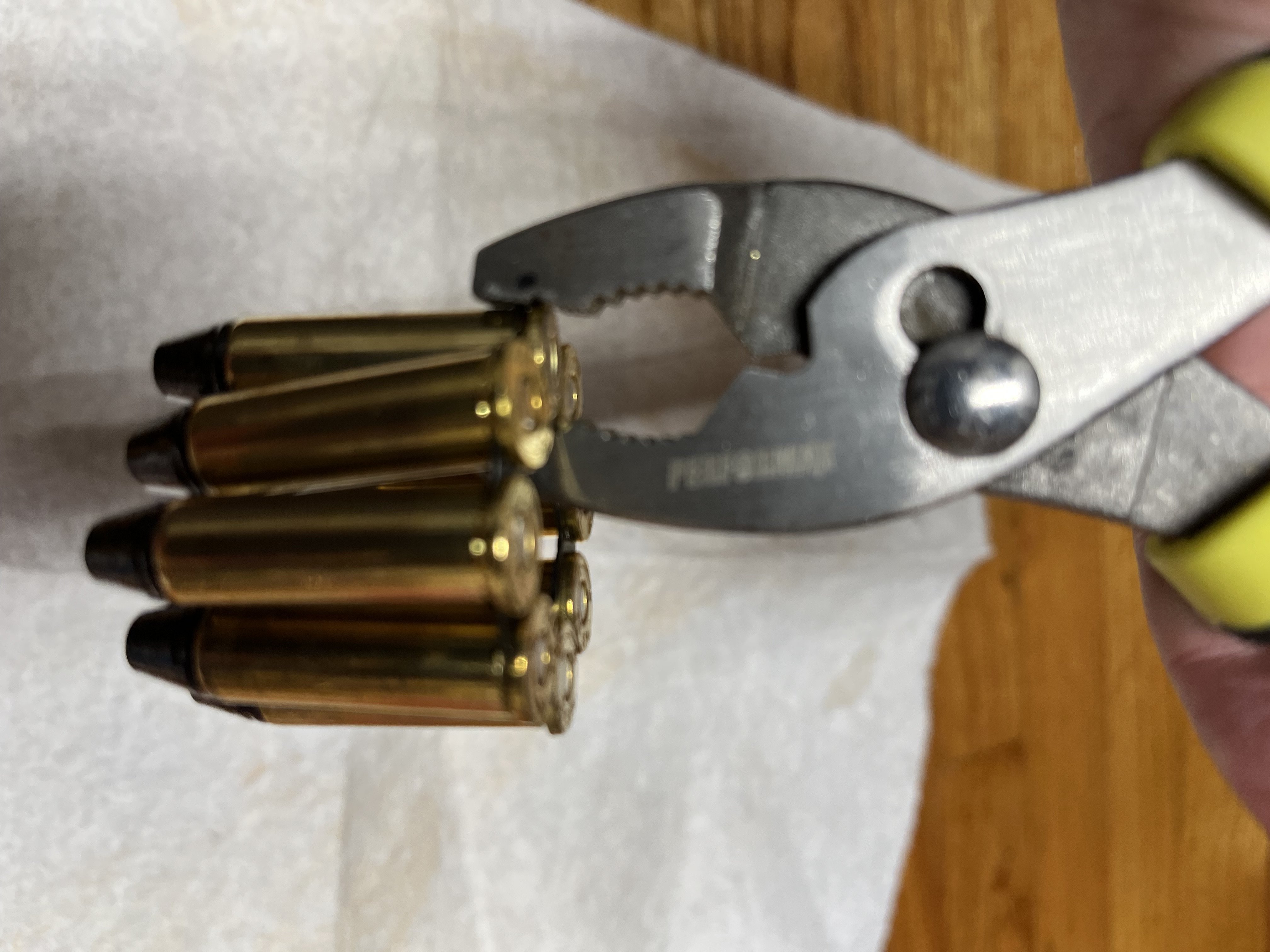

For the installation tool, I just took a cheap pair of pliers that fit my hand size well and again used my Dremel tool to cut a slot on my plier that fits the moon clip side and another slot that fits the brass edge.
These tools work great for me and I have the price of the pliers in them. Send me a message with your contact and I will send you pictures.

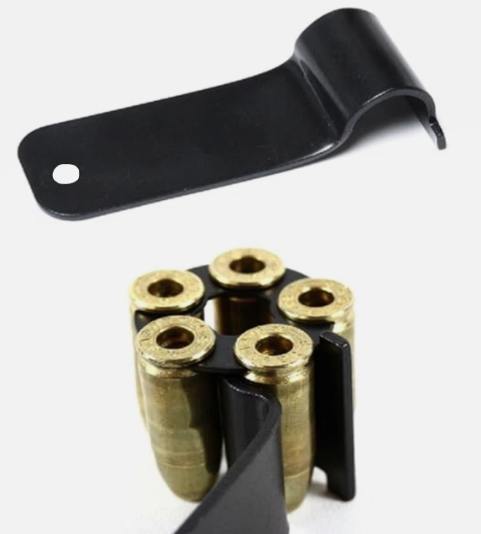

My is a simple steel pry bar of sorts. It works, no more no less :-)
A pic from an ad.
Great!!!!!!
My only concern would be the pliers MIGHT cause small burrs in the inside edge of the clip. I've got ZERO experience in this,, I'm just thinking out loud.

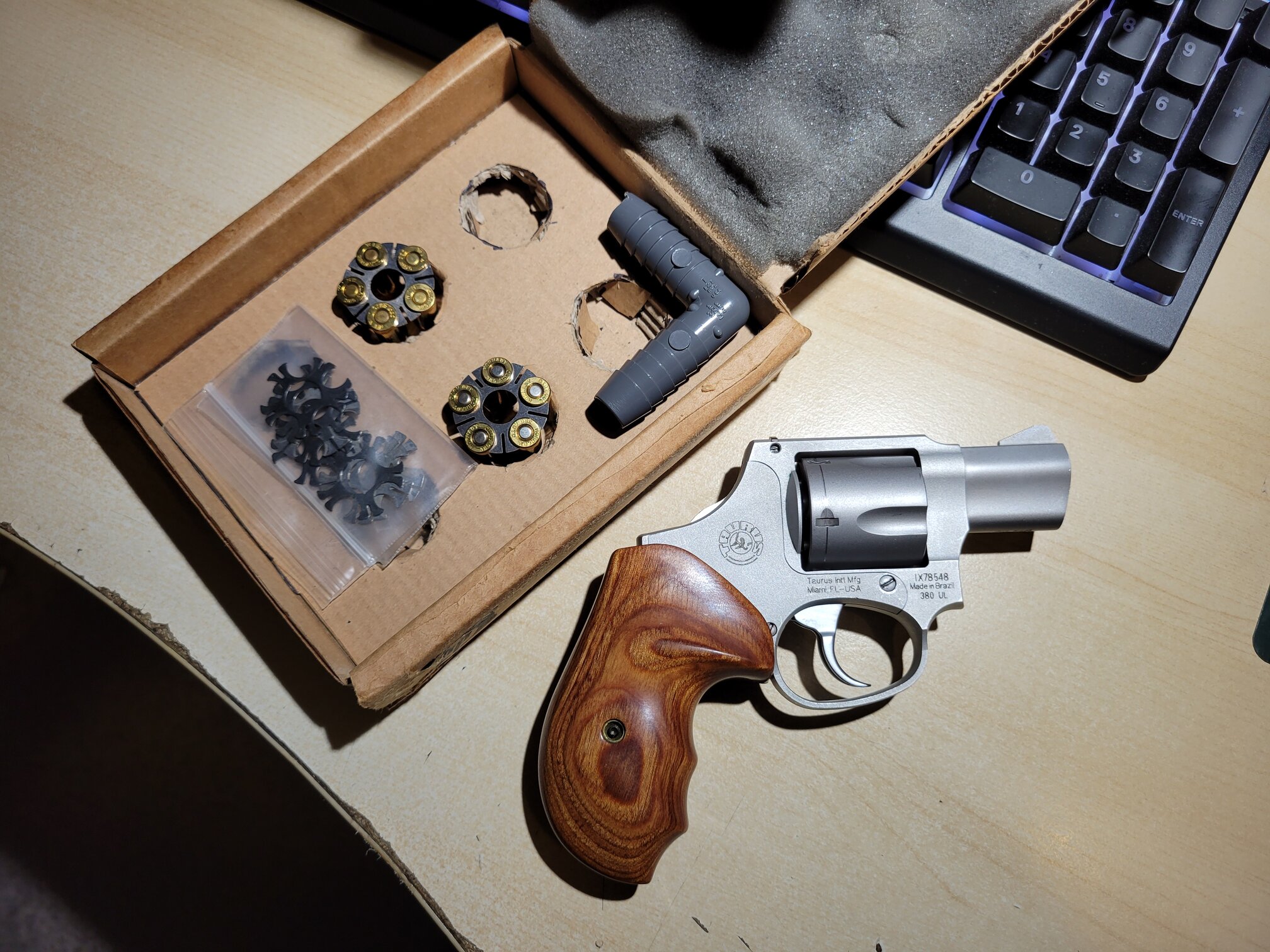

I use a plastic barb elbow about 3/8", which I cut with a knife in order to create a tool, just like in the photos.
IIRC it was something like 75 cents or thereabout. Maybe $1.20 today with the inflation. I thought I would wear it quickly and discard it. But this is actually original. I just re-sharpen it with a pen knife once in a couple of years.
(Taurus M380UL is pictured, but the same elbow works on Ruger LCR.)

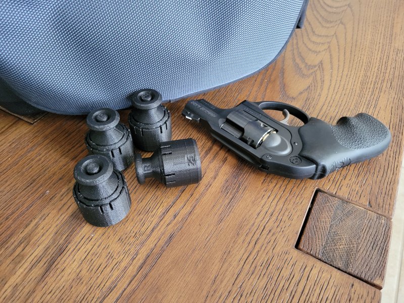

Also, not sure if this counts as a tool, but I do not carry clips in the cardboard box in the photo anymore. Instead, I have a few "speedloader"-like holders and just throw them into a range bag's pocket.
I know some guys have boards with pins sticking out, on which they stack clips like puzzle towers. They can carry up 30 clips at once easily. Nobody wants to stuff clips at the range.
