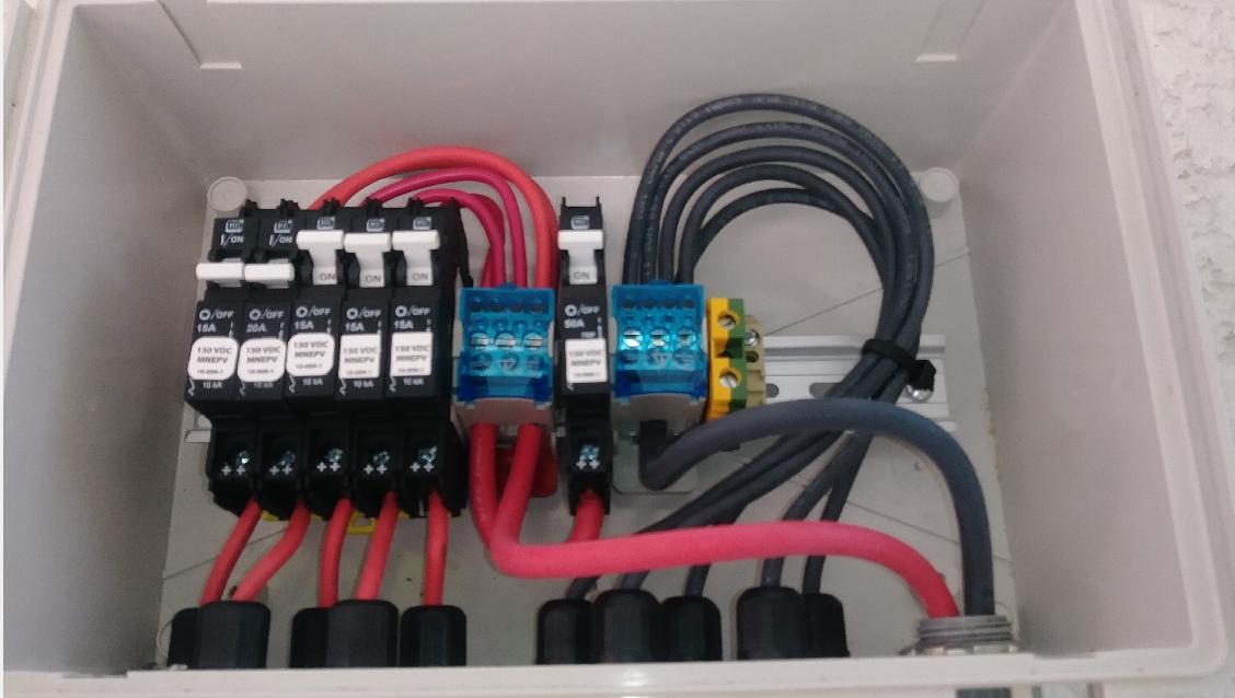

Long ago I came to the conclusion that for my purposes an A/C system to "save" money or "sell surplus" power to Florida Power and Light was impractical. I could not justify the cost / benefit especially since going over 2-3KW would mandate the destruction of my tile roof and potential for a MAJOR expense should it fail due to the solar array being mounted there. My current solar panels are fastened to a south facing windowless second story attic wall.
So I focused on supplying DC power to exterior perimeter, culture lighting, attic ventilation, water features, emergency charge stations for phones, and even a power station for DC cooling fans etc. and back up power for my surveillance and alarm systems. To that end for me anyway my 1KW solar system is a blessing.
Even as it is, I'm going to be embarking on my third system upgrade in the last 12 years and between batteries, panel upgrades, combiner / cable repairs and a new charge controller it's not cheap. I'd HATE to rely on someone else to upgrade and maintain my system.
If anyone is considering solar power it REALLY pays to flesh out what they're wanting to do well before jumping on it.
Below are my last system components just before going live to the battery array and the back yard lighting . I hope to have the new charge controller cabinet installed in a few weeks.
