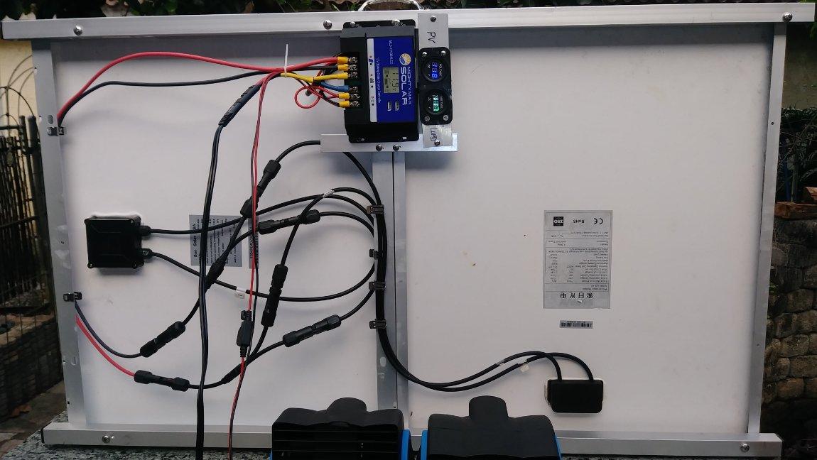

IMO for your purposes a 80-100 watt (or better) "12 volt" (they come in much higher voltages which you do not need) solar panel will do what you want with a CC, stay away from flexible panels and buying better stuff is better than replacing destroyed stuff. Making a mobile unit is easy (see pic of mine) so you can charge a vehicle also.
