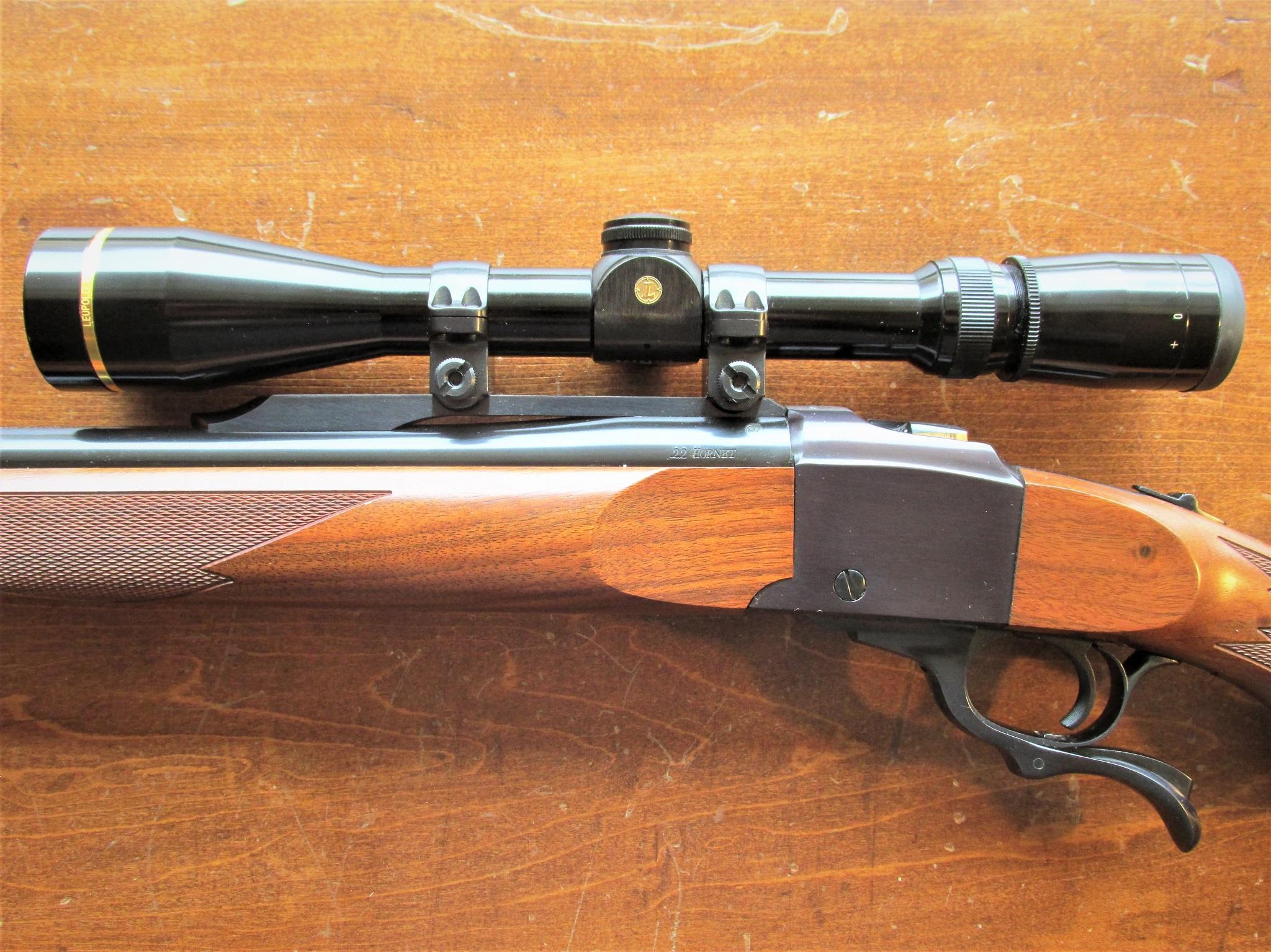

Scopes that fit the Ruger Number 1 are rather limited, especially if using non-offset and/or standard height rings. Some of Leupold's VX-3 series scopes will fit the No. 1 using the standard rings. That's a 3.5x-10x VX-3 on a 1B pictured below. The rear ring is almost against the turrets, but eye relief is still acceptable.
Basically, you want a scope with over 3.5" of eye relief and fairly long dimensions. I would also recommend scopes without large diameters at the ocular end to provide more room for cartridge loading and unloading.
