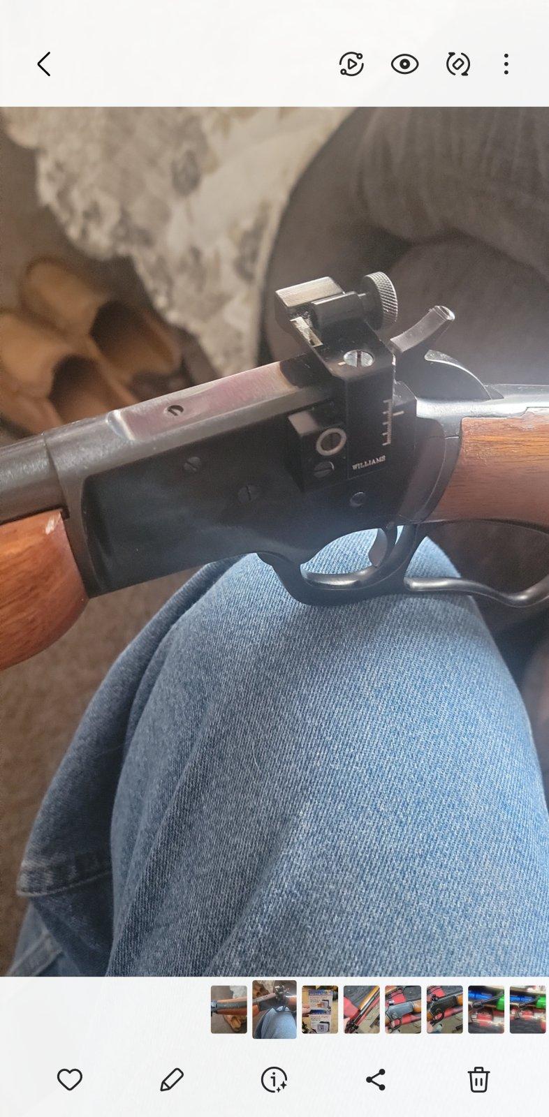

Its got a peep but my eyes are not to good. I shot yesterday at 20 yards and had 4 shots touching #5 almost. I can make a bracket/mount to mount where the peep is and secure my scope rail to it and put a layer of something under it as to not scratch up receiver. Got it designed in my head. Now its either aluminum or steel. I can polish and blue the steel.

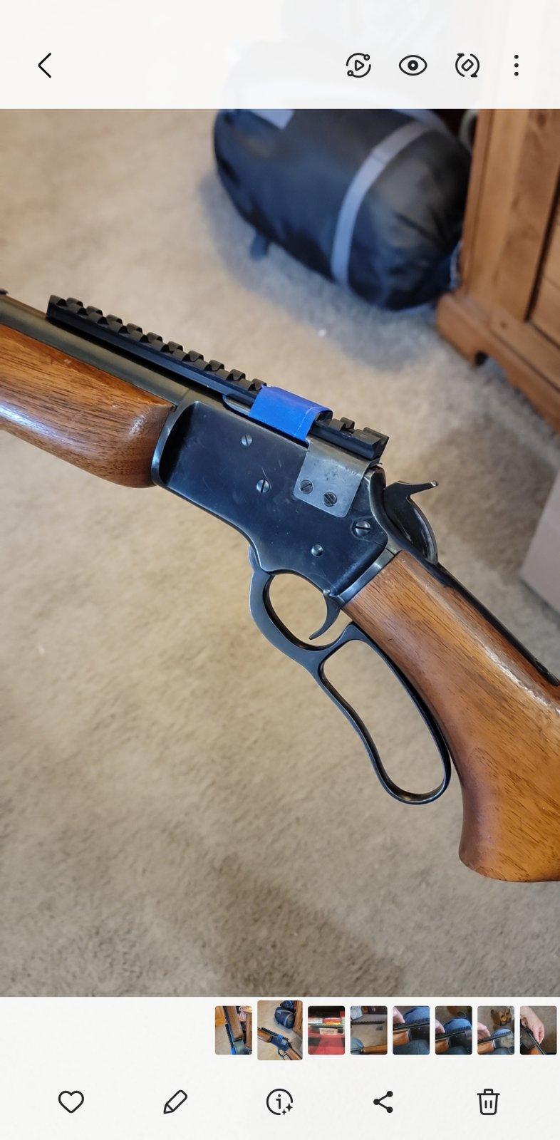

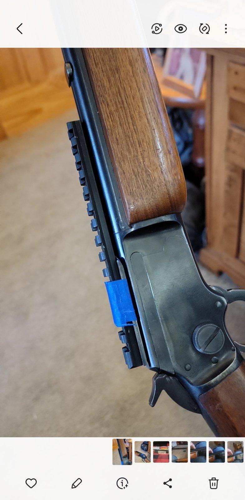

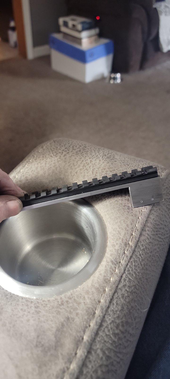

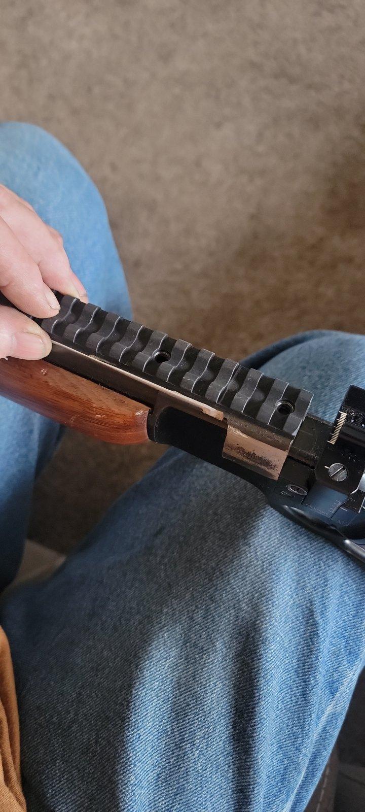

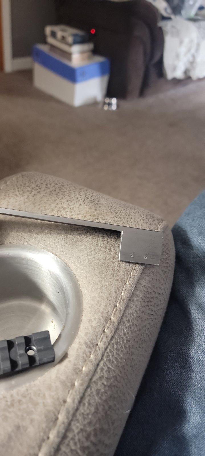

so heres a couple pics. I know its not machine like most of you do but wait until i get it all filed and smoothed out. On the left side the peep sight will go and this bracket will mount using factory holes which is where the peep sight is mounted. On the other side you only see the thickness of the bracket. The rail will be mounted to the top rail of my bracket.

My mount looks ok but im picky. Will probably make another. The 90 degree bend is rounded looking not a nice square look. If i dont get one made to suit me i will forget it.i dont have a mill or anything but i do have a nice drill press and nice cross type vice. Its kinda hard doing it by hand. Thanks guys. And im not drilling any holes.Its bracket or peep
Well the mount is looking better. Now if i can find the screws i need.

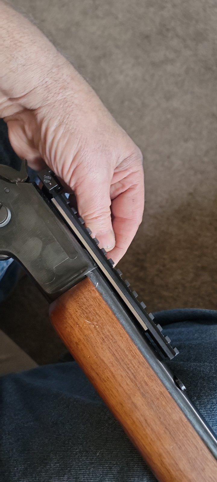

New pics just waiting on a 6/48 tap so i can secure my homemade bracket to the top rail.
Again no holes drilled in receiver.What do you think? If i could blue/ black the bracket better. May take it off and spray with flat black.I amp putting masking tape on the back of bracket so not to scratch the receiver. Temporary......what would you use permanently between bracket and receiver? Ive been thinking duct tape sticky side to bracket. Non sticky against receiver.

Dave as of now just a shim spacer. Like a round faucet washer. Im thinking of leaving that section of the bracket long enough to drill and tap the dove tail blank
and crewing the front part of the rail to it.The way it is now is alotcsturdier than you would think.Actually i shortened the bracket and the entire rIl on to rests on the receiver and barrel. I will send you a good pic. When done
What's going to support the forward portion extending over the barrel?
What I would do is to drill and tap a hole through the forward part of the rail and the bracket, then put a machine screw with a rubber tipped end (or some silicon sealant) through it and tighten it against the barrel and Loc-Tite it when you are happy with it. That front screw could help you level the rail in relation to the receiver.
My suggestion exactly. I prefer a set screw with a nylon end- I get these on some AR15 receivers to tighten upper to lower play.
Warning- don’t tighten this too much as it can induce a bow in the scope rail and potentially mess up your scope tube. You want just enough tension to stabilize the unsupported end of the rail and minimize harmonics.
