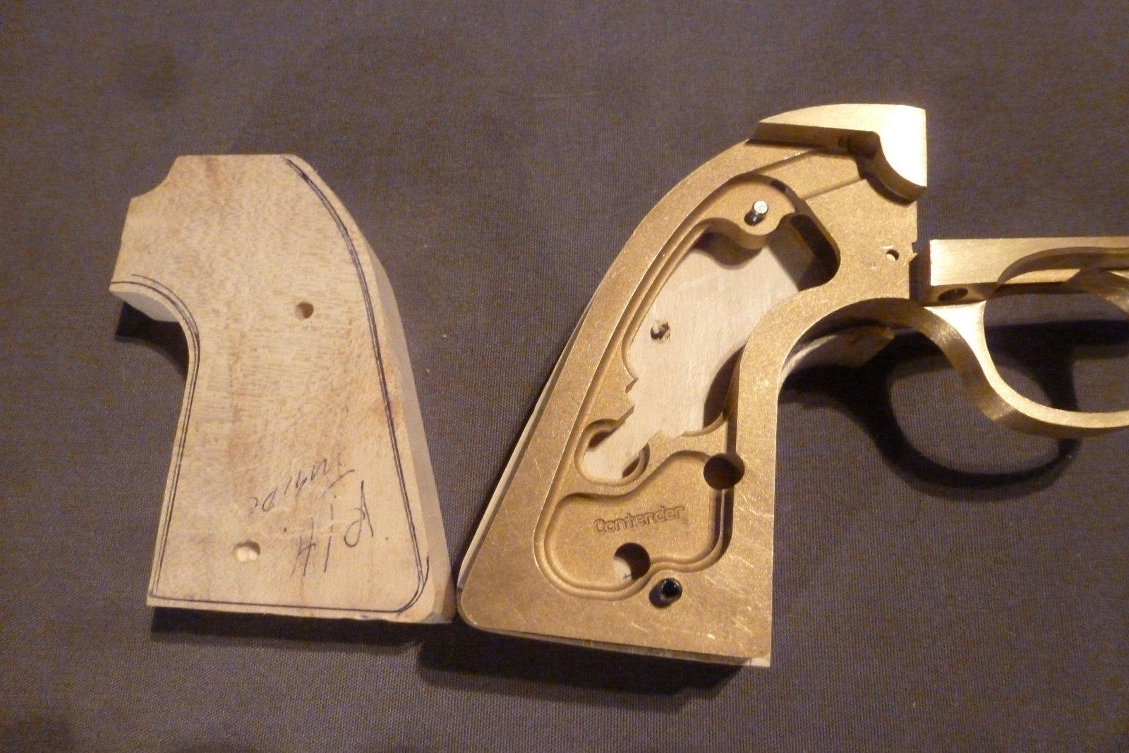

Once again, trying to document the process of making the RW grip frame fit my gun AND make a set of grips for it,, I have the following. I have drilled the blanks for the grip locator pin after I made sure the upper edges were as close as I dared try & get them. And I also marked the area for the grip screw ferrules and drilled the pilot hole for that.

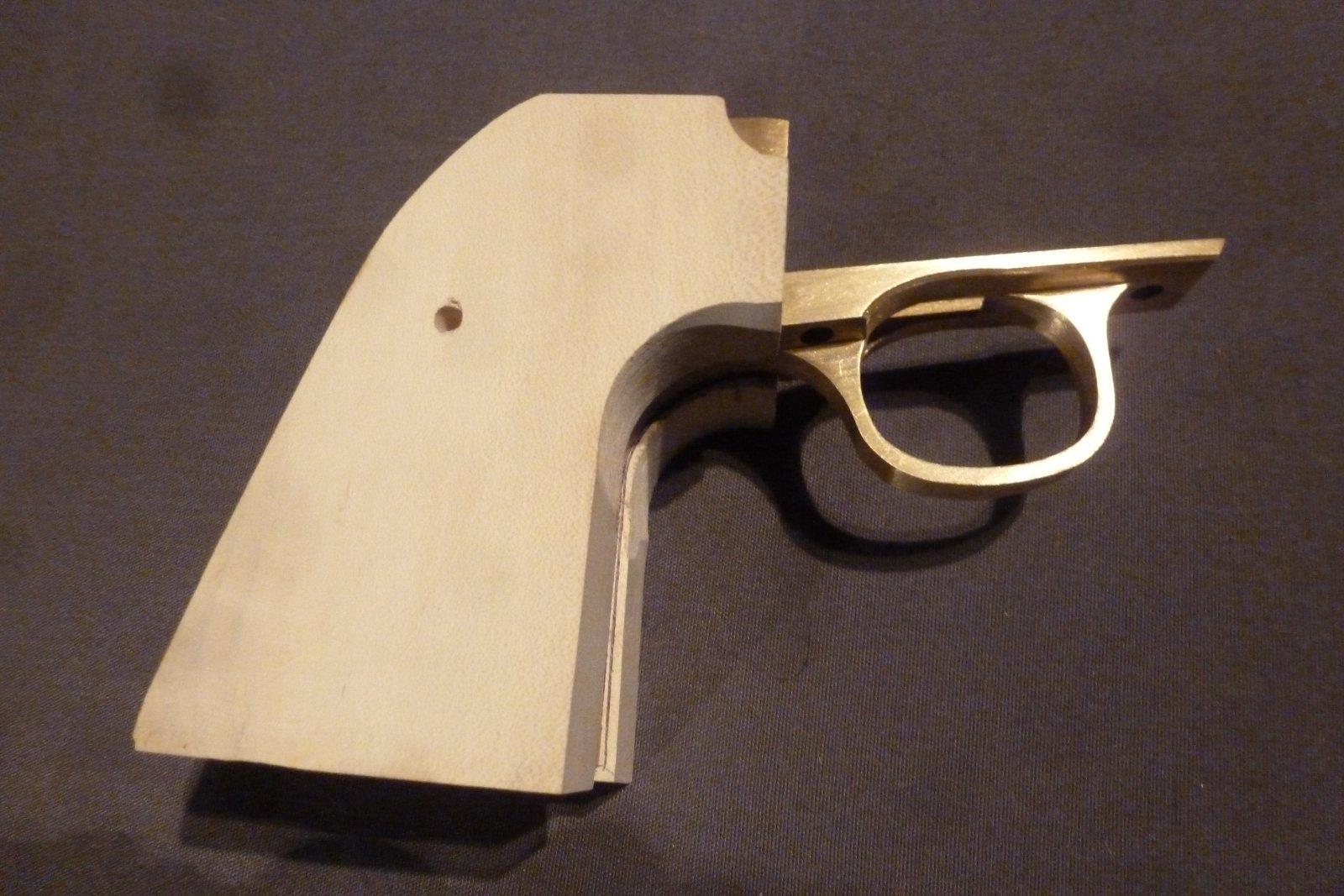

Afterwards,, having an outline drawn,, I did the rough shape cutting using my jig-saw. I followed that with a little bit of smoothing the rough edges with a sander.
Next will be the reduction of the thickness & shaping the grips to fit my hands.
But here's a couple of pictures after the above work.
