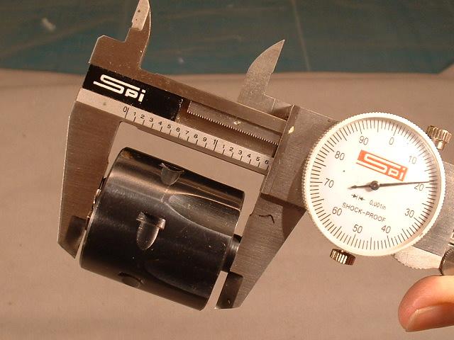

yes measure the cylinder that is now in the gun and its overall length, as I will show below in a picture, and let us know,,,there was a couple at the show this past weekend a guy has and one of them is an old model 22 cal ( LR) cylinder, has the firing pin grovve in the rear and its from an old model has the red bag and its like new, he offered it to me for $150 as he was told at one time to return it to the factory and get a "new" one and I doubt it will be an old model version, and they wanted $168?? not sure, as I no longer have dealt with them since we retired and closed the shop, but I know if you was to send it back, it has to be 'safety updated' as well or they will not do it.........
the pictured cylinder is NOT the one that he has, this is a "file" picture from years ago...

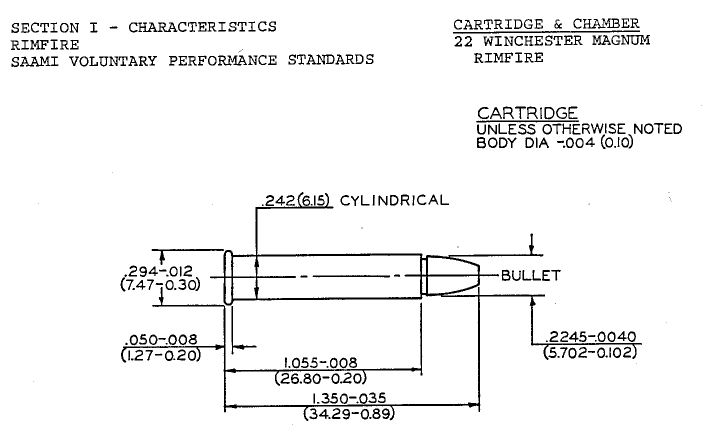

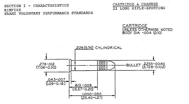

The .22 WMR case is cylindrical, not tapered but is larger in diameter (.242 vs. .226):

NO! The .22 WMRF (Winchester Magnum Rim Fire) has a tapered case. .22 LR, .22L, and .22S have a straight case. Firing .22 LR in a .22 Mag chamber will allow the cases to split.
