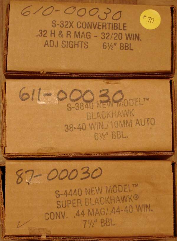

Would there be any interest in linking up owners of the .32-20 and .38-40 Buckeye convertibles so owners can have matching pairs? In addition, you could add the .44-40 convertibles. I have several of each, and would buy/trade/sell to make matching pairs.

I don't get out much, what exactly is a matched pair or set?
To the best of my knowledge, Ruger came out with a special order series of 5000 convertibles (Buckeye Special). One year they ran 38-40 with an extra 10mm cylinder. The other year they ran .32-20 / 32 H&R Mag with swappable cylinders. In both cases, the barrel liked both kinds of ammo but the cylinders needed to be swapped out.
If you bought the year's prior model, Buckeye Sports (who contracted with Ruger for these runs of 5000) and Ruger would offer you a chance at the new convertible that would match your first unit's serial numbers.
So if you followed the proper procedures, you would end up with two gun frames with linked serial numbers and two cylinders for each frame.
Dec 11, 2002
9,017
Ohio , U.S.A.
what he said above, the serial numbers could be the "same" but the prefix numbers were different, #610 for the 32 cal and #611 for the 38/40-10 mm,,,,,the third version .44 mag 44-40 was a different prefix so would NOT Match as it was NOT through "Buckeye" ( Johns Sporting Goods) down in Canton ,OHio back in 1989-90.....but if you got one low enough the last 4 or was it 5 digits, just may be the same,,,never know there are guys out there looking I"m sure.........:cool::rolleyes:;)

The S4440 was produced in the lowest quantities (about 1200) of the three. And I believe it was Jerry's Sports that picked it up. It was supposed to be the 3rd Buckeye model but Buckeye was out of business by the time the S4440 was made. Then Jerry's went out of business for good when United Sporting Company, which then owned Jerry's and Acusport and maybe a couple other names, went bankrupt.
