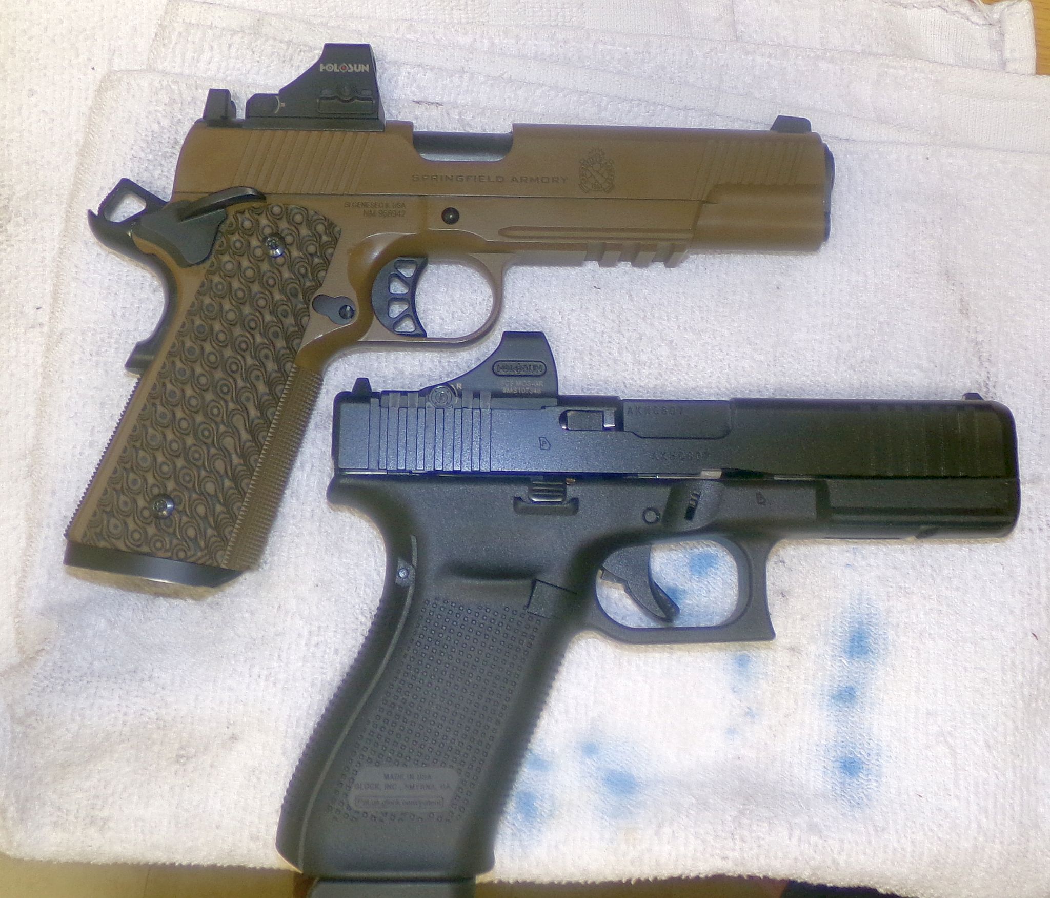

I've not had to get a slide cut, but have Holosun dot's on a couple long guns and pistols. Many pistol manufacturers have been coming out with optic ready models, and that might be the better way to go financially as well as finding a dot that works for you, instead of cutting up your current gun. Here's a pic of a Glock and a Springfield I've put dots on, both precut at the factory. The Springfield required me to buy a $129 special plate from them in order to mount the optic. The Glock did not require a plate and sits lower than the Springfield, but both allow co-witness thru the lens. Both optics are Holosuns but different models.
PS: The battery in the Holosun SCS on the Glock is not replaceable by the user. It must be sent back to the factory. The HS507K on the Springer carries a standard coin battery in a slide out shelf. Point is that ease of battery replacement is something else to consider, along with all the other details.
