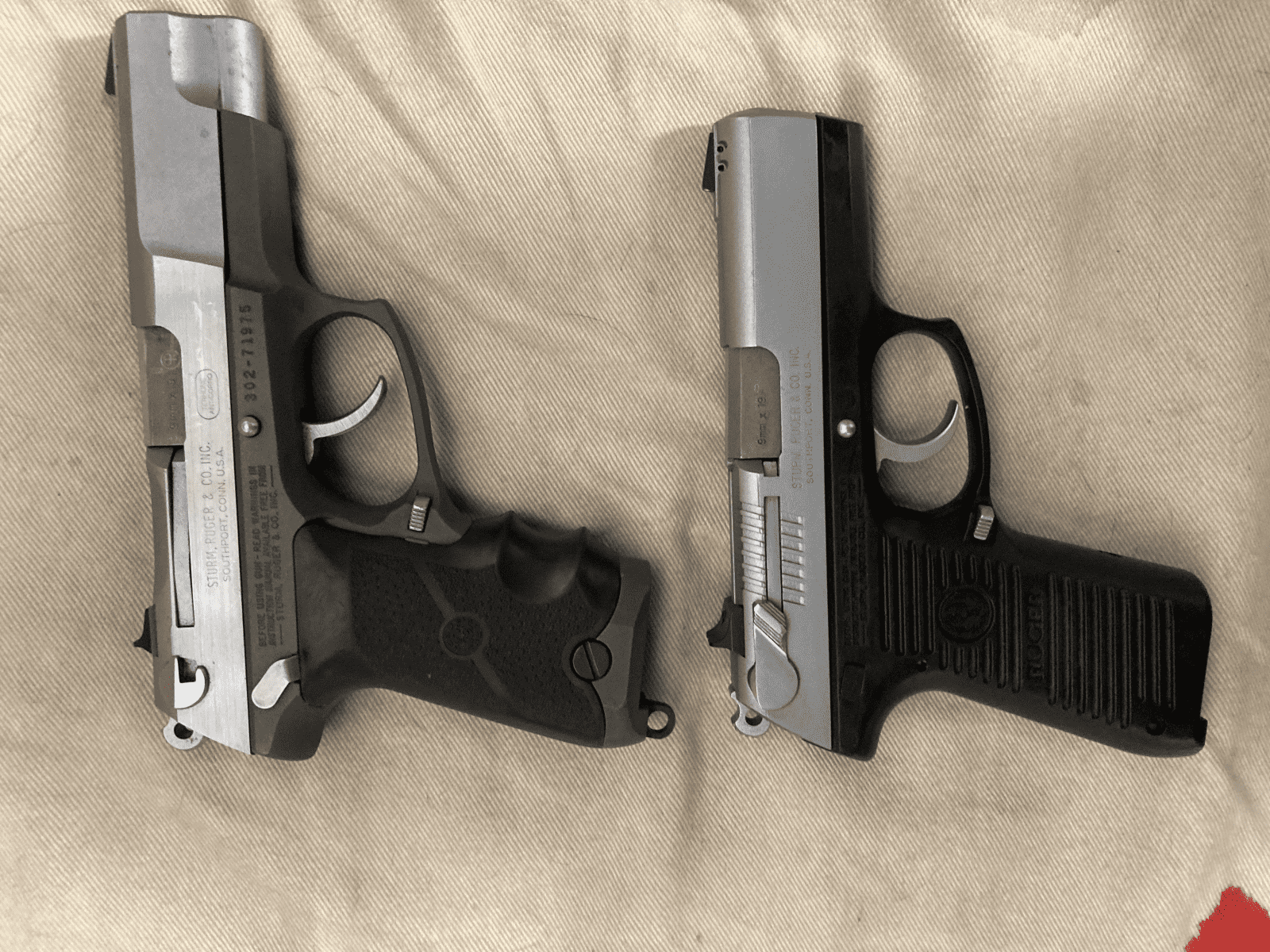

the difference is the pistol is bigger that is about it... except I think you have one of the first models and they need a different magazine from later models of both the 89 & 95.... but don't panic on that... there are two choices in this if you choose. One is to just make sure you have the right mags... I have two I'd be willing to let go off or to do a slight modification of the pistol so that it takes either the old ones or the new ones. I have an older p89 that I did this to. It is filing off a very small amount of the top of the mag release inside the grip. In looking at the two below it seems the P95 came with an ambidextrous decock the p89 didn't. tempImageNE7Yys.png
Most 89s had the ambi decock. The very old ones did not. Safe models too had it on both sides typically.
